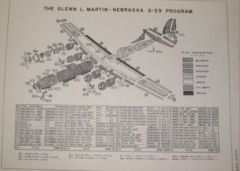

It took me less time than I thought it would to find this material. :rolleyes: This Martin Blueprint Book contains a chart with all of the subcontractors and what they contributed to the Omaha plant as of July 1944:
This is the table, noting that Hudson built the tail compartment. The drawing number is exactly the same as your data plate, so we can be sure it went through Omaha:
Thinking out loud now--isn't there a list of most (if not all) of the China Lake B-29s? If one were to ferret out all Martin airplanes that were known to be at China Lake perhaps another airplane in the general serial block might be discovered. My thinking is that the data plate on your section may have been stamped with the 377 but actually installed on a different machine during assembly. Just another possibility to consider.
