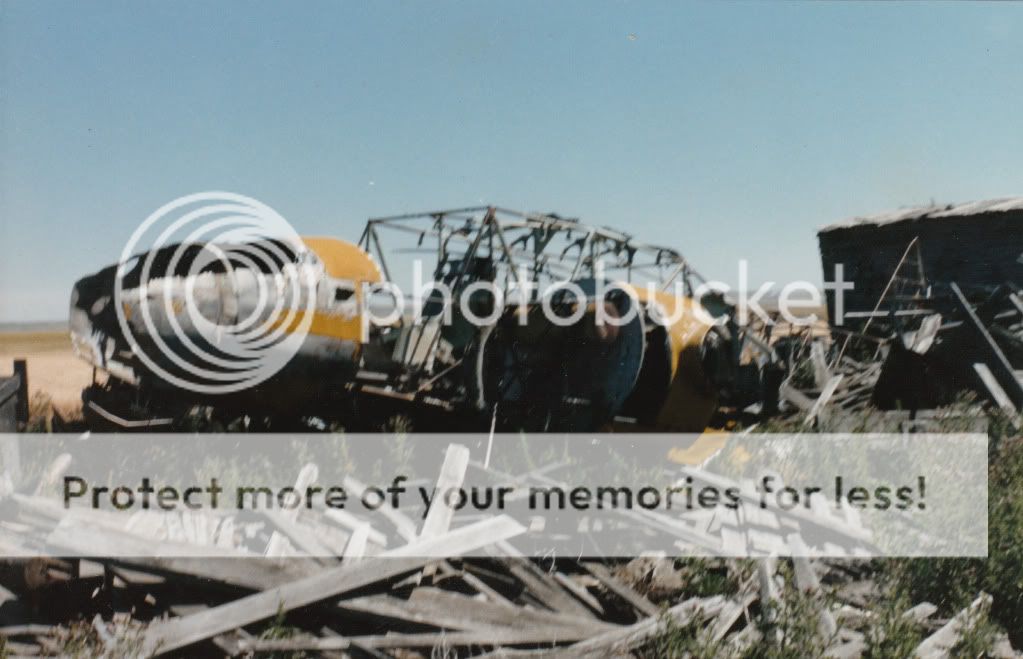

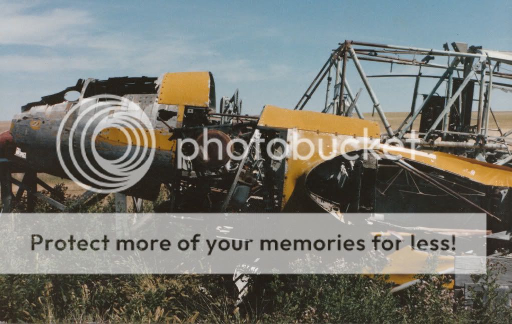

Some photos I took back in the 80's of an aircraft in Alberta that show the wood nose, although I do note the fixed gun position is faired over, so this obviously was also on the Mk.II Ansons.

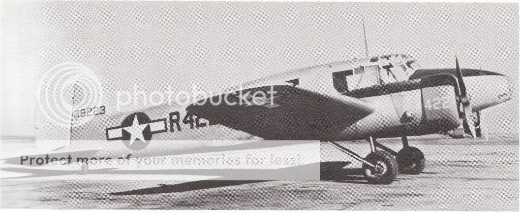

and the US Version...

thanks for the pics of the ply nose, its the first time I have seen that detail, understandable as a strategy to conserve strategic materials, its probably the largest single chunk of aluminium on the Anson other than the cowls, and they would have been difficult to shift over to ply construction.
btw I note neither of the wrecks posted above have turret remains in them, I was wondering if there are many surplus Armstrong Whitworth "Birdcage" Turrets in Canada surviving from these wrecks or was the Bristol turret the commonly fitted type in Canada?

davem wrote:btw I note neither of the wrecks posted above have turret remains in them, I was wondering if there are many surplus Armstrong Whitworth "Birdcage" Turrets in Canada surviving from these wrecks or was the Bristol turret the commonly fitted type in Canada?
If I understand correctly, most of the Canadian Ansons were used for pilot and navigation training. The Mk.II aircraft were not fitted with turrets during production, the hole was simply faired over. I looked at many, many airframes in western Canada during the 1980's and never once saw an airframe with a turret. The Mk.I / III aircraft certainly had them fitted in Canadian service, but I suspect by wars end the vast majoritory of these turrets had been removed.

Have to agree with Dave. All the ansons I have seen in Canada did not have turrest fitted and the actual opening was faired over in service.
