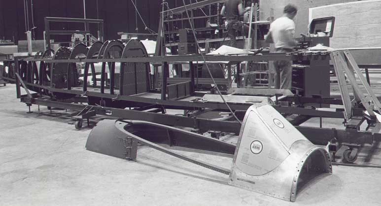

Here's a shot of the P-51 canopy rail fixture that was used in the construction of the PA-48 in the 1980s. The new-build fuselage that is was grafted on to is behind it.
The windscreen, obviously, is not original -- it is taller and at a more upright angle than the standard Mustang windscreen.
