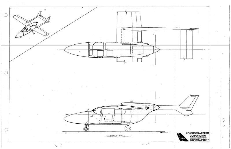

And then Robertson played with this.

The full story on the single (rear) engine stol 337 (and interesting details on the 336 and military 337s) can be found in:
Cessna Wings for the World, Vol II, by William D. Thompson a retired Cessna engineer and test pilot.
He relates a crash program (not Cessna but a third party effort) to offer the plane as a gunship to protect mideast oil wells.
Thompson's 3 books are must treading for anyone interested in Cessnas.

Someone was offering a single PT-6 powered pusher 337 with a hinged, extended nose as a low buck bush freighter, I think it wound up @ Mojave with one of the Test Pilot Schools there, recall seeing a photo in an article moons ago-
