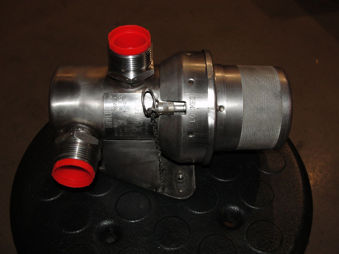

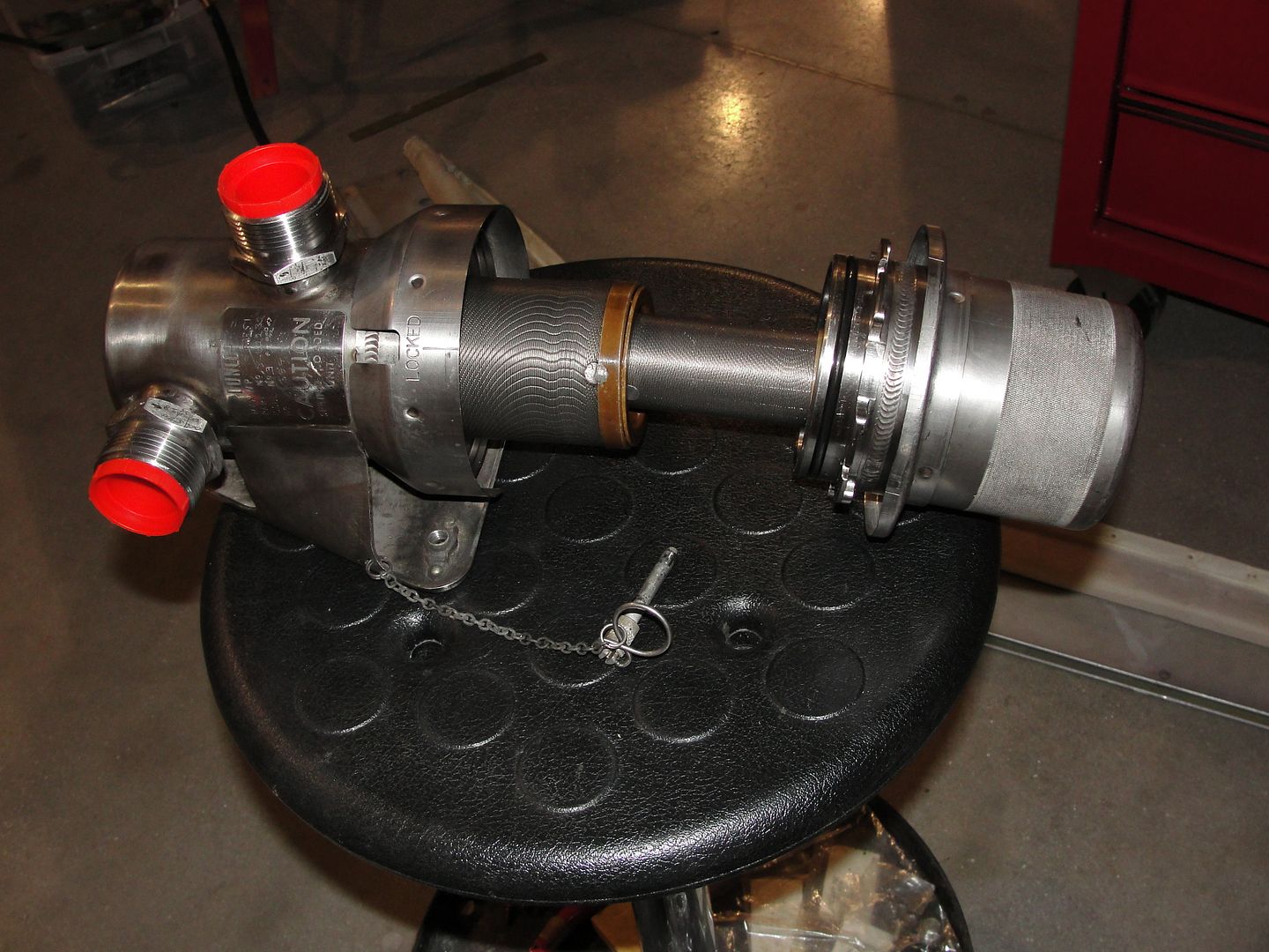

Here is the Shackleton oil filter-
Easy to open and get to the screen element. Pull a pip pin, rotate lower housing and you have access to the element.

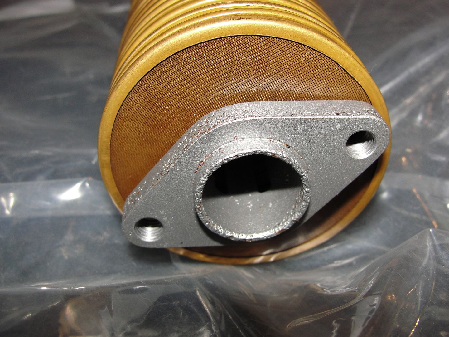

Close up of the elements.

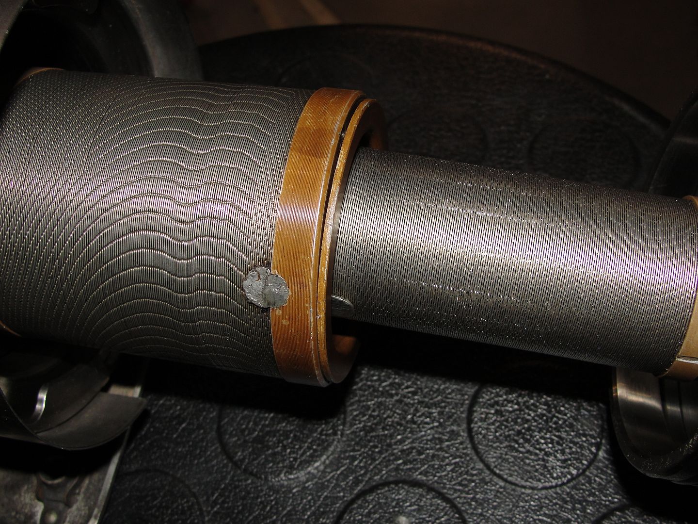

Stacked screen assy of a Packard Merlin Cuno-
