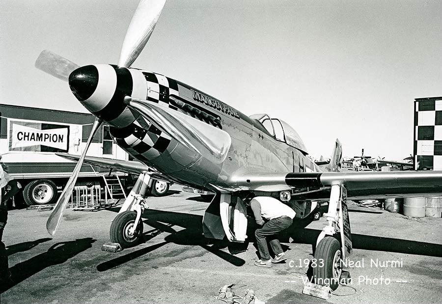

Another shot of that prop:
Neal Nurmi
---Wingman Photo---

To make things a little clearer, (4) Mosquito blades were installed into a 24D50 Mustang prop hub. Yes, I realize that a Mosquito came with a (3) bladed prop assembly. A Mosquito is also a "D" shank blade and will fit into a Mustang hub. This is not a guess but the straight answer from Tiger His-self last PM.

Tiger claw=Orca prop. 24 "E" 50. Kerch "made" the backing plate and some other misc parts for it. White, wide blades with red (?) tip's if I recall. The modified tips that are on the cuff prop which is on the airplane now were done at the completion of the race in '97. Tige was not very happy about that modifcation. There was also an experimental Ham Std. prop that was run on Jeanie & Dago in the early days. Polished blades & no cuffs, interesting prop.
