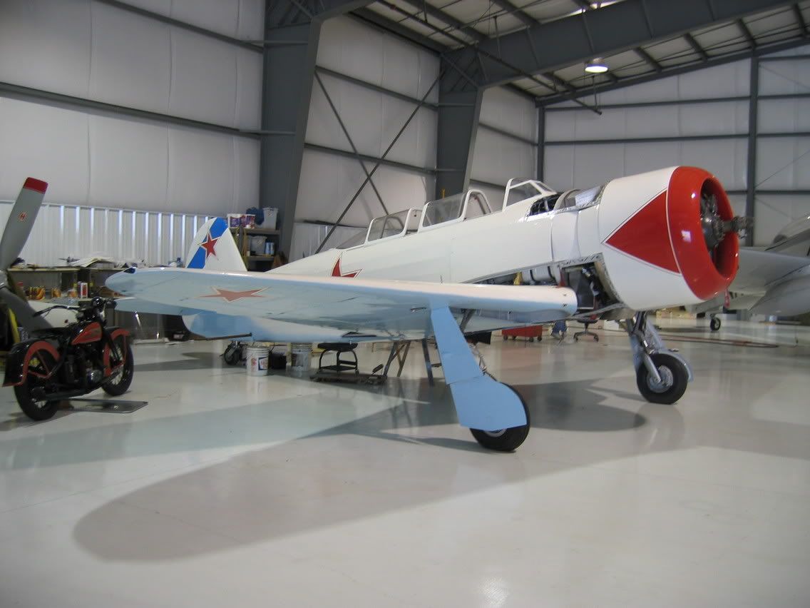

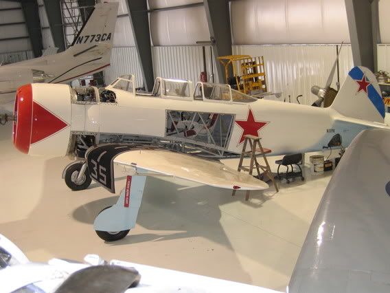

All major systems are now installed and functional. The air bottles were charged yesterday, allowing for gear and flap retractions on the jacks. All went very well. With the gear retracted the gear doors were attached, and they're really nice and flush. Today was spent bleeding the brake lines (wheels and brakes are from a Cessna 421).
The prop will soon be attached, then a weight and balance can be completed. Should begin engine runs in a week or so.
I'll post some more photos after we get the prop on.

Here are some photos from today. Bob decided to change out the electric air pump that was installed, in favor of one that has more volume/less pressure. Should only take a day, and we still plan on hanging the prop this week.
Getting very close.

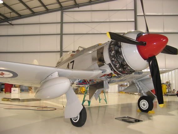

Here's some of the Sea Fury...which is also very close.

I think you're going to have some fun in this bird, Steve.
Rob

The Yak is very close to flying, as all systems are complete and ground runs are now taking place. The engine is running well and all that is left is to finish the FAA paperwork before a first flight.
I'll try and post some photos next week...
