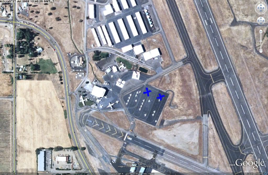

I had to fly on a fire near John Day,Oregon over the weekend and I'm just getting a chance to get online.Here are the map co-ordinates from your map:
For the Skyfox:
42 22 32.17N 122 52 41.74W
42.375603,-122.878261
For the F-16:
42 22 31.37N 122 52 39.19W
42.375381,-122.877553
In this picture,the X on the left,nearest to the tanker base is Skyfox,the other is the F-16's current location
