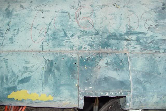

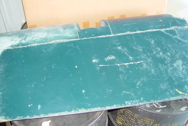

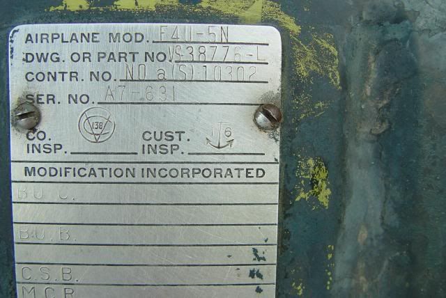

Well I did not find any more photos yet but I did find that flap. It's larger than I remember, that's for sure. The data plate on the flap is mostly covered with old Blue paint but what I could read said "F4U-5N" and DWG No or Part Number "??38776-L" so I guess it's a Left flap? I'll clean it up on Sunday and try to get some more info off the data plate.

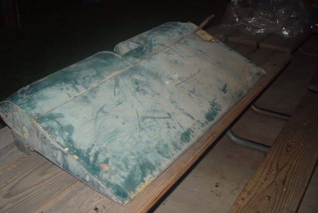

The flap data plate yielded a P/N and a S/N. It also shows two "608" markings that are done in a Red grease pen or something similar. I assume this was done in Honduras. I guess all this means is that this flap probably came from ex FAH-608 like the parts of the engine cowling.
Negative color image.
One hit with some fine cut wax. I cleaned the side opposite the Red grease pen numbers.
Ok, Rob. What can you do with a flap S/N? :D
Albert Stix Jr.

I can't do much with the flap serial numbers since they don't directly corespond with the planes Bureau Number. However, I will venture to guess that the grease pencil markings were put there by Hollywood Wings during the disassembly of the non-airworthy aircraft for the train ride back north to Long Beach. Very cool that you still have the flap! 8)

"Actually, those S/Ns that are stamped in the mod plates do correlate to the Buno of the aircraft.
1. The Argentinian F4U-5s listed a number called "CVA" which possibly means Chance Vought Airframe in their inventory of F4U-5, F4U-5N & F4U-5NL aircraft as follows:
1. F4U-5NL Buno 124705 listed a "CVA" number as "549".
F4U-5NL Buno 124707 listed a "CVA" number as "551"
2. The Honduras AF FAH 609 F4U-5NL shows also an identical ID mod plate in the L/H of the cockpit with the s/n A21-559 which we found correlates to its Buno 124715.
3. Your S/N A7-631 possibly correlates to an early model F4U-5.

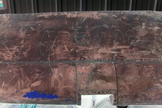

Hi Al,had to laugh,we have just finished painting all the flaps for FAH 608,and then you go & post a pic of an original off the aircraft!!! :lol: I don't think all your investigation of Bu No's & Ser no's is in vain,I have found it very interesting and had not thought about the previous history too much as the rear fuse has the ser no on a data plate in side the rear fuse access door.I guess with most aircraft that have production breaks there is the chance of subsections being mixed (&WIXED :D )I don't have the ok to post pics at this stage but will ask as it looks fantastic with the FAH scheme,best regards,Pete Bradley

FAH-619 is actually correct. I had the three digit numbers for the F4U-7's but none for the F4U-5's. Using the number correlations noted by FAH-619, the flap you have would have belonged to F4U-5NL BuNo.124678. There was a lot of swapping of lesser components in the field so this would not have been uncommon. I'll try to crunch more numbers tomorrow night and see if I missed anything obvious.
