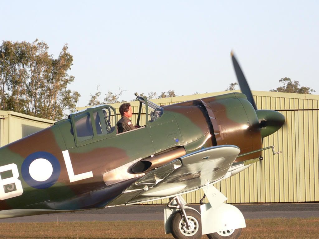

Congrats to all involved, what an amazing looking aircraft.
Wed Jul 01, 2009 5:42 am
Another flight this afternoon saw me head to the airfield quickly :) This time she was up with the Wirraway and Mustang doing formation flights.
What can I say but 8) WOW!!!! 8)
Wed Jul 01, 2009 5:46 am

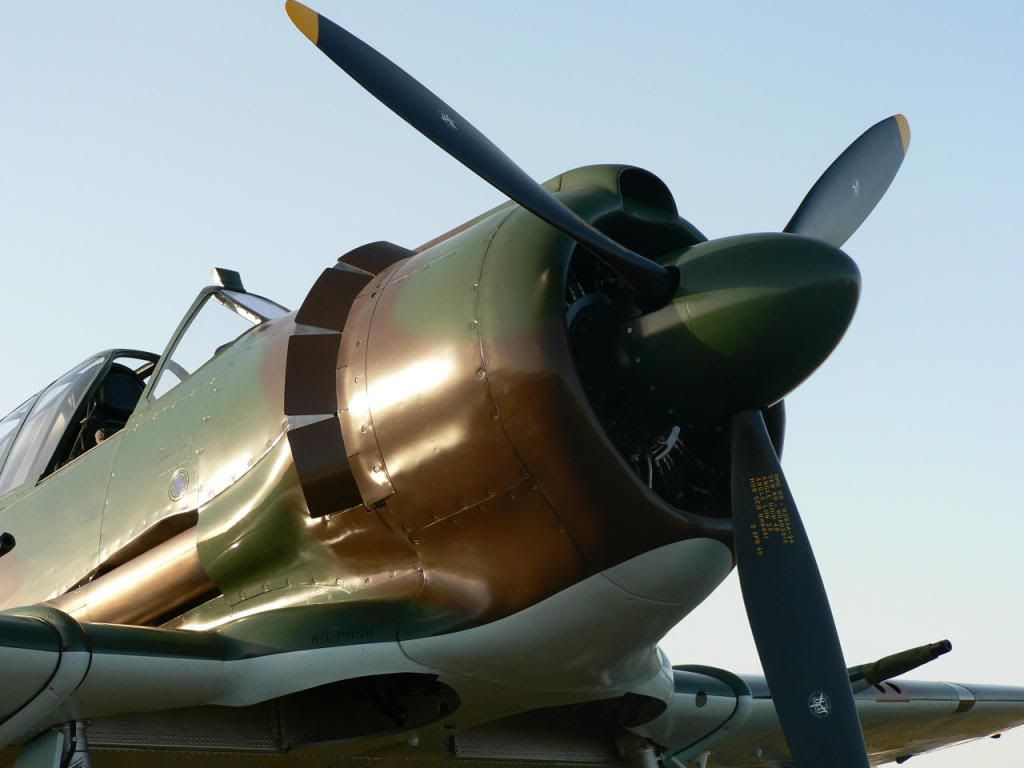

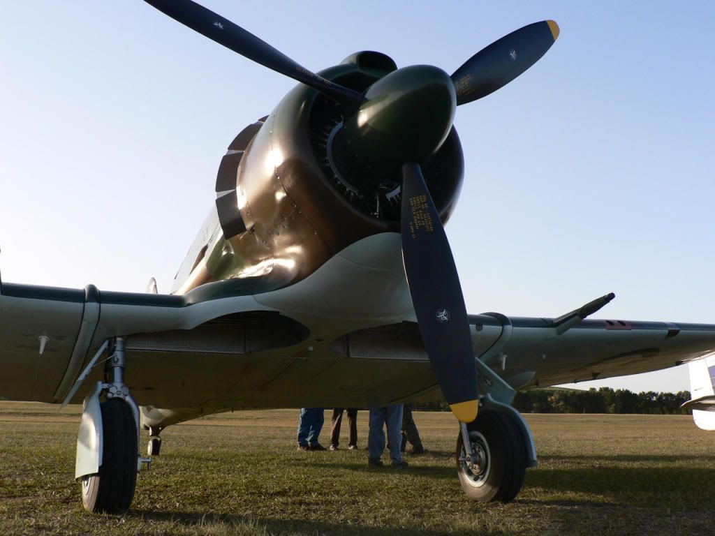

What engine is that thing using?
Wed Jul 01, 2009 5:53 am
Pratt and Whitney R-1830 S3C4-G
Wed Jul 01, 2009 6:11 am
In regards to what is interchangeable with the Boomerang and Wirraway - very little. True, the design brief at CAC was to use as many Wirraway parts as possible, but just about everything was strengthened and/or modified. Even the wheels were modified to try to reduce the drum brakes fading - these wheels are now extremely rare to find in airworthy condition. I am pretty sure that this aeroplane has a much modified Harvard Mk IV wing centre section, new build wing outer panels, but otherwise its all Boomerang. The fuselage frame has been modified to take a second seat and it is definitely not a T6 frame. Check out this http://returntoflight.aviationadvertise ... o-library/ for some great detailed photos of a very nice resto and to give you a clue to what a real Boomerang looks like on the inside.
