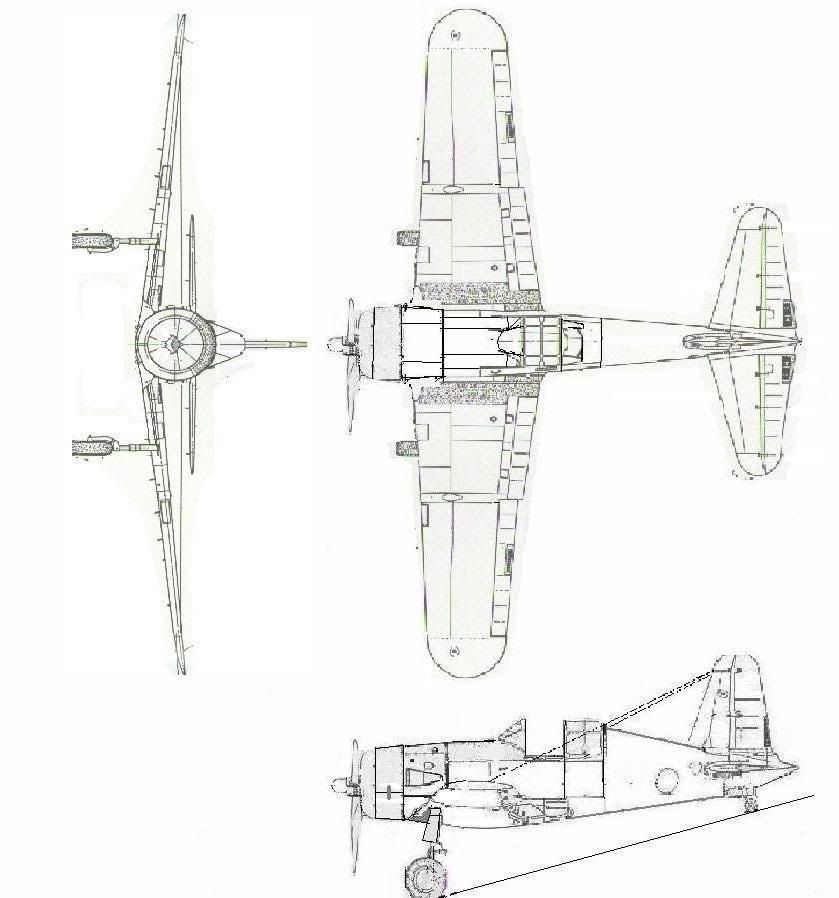

'O'h, that plan view reminds me of something... ;)

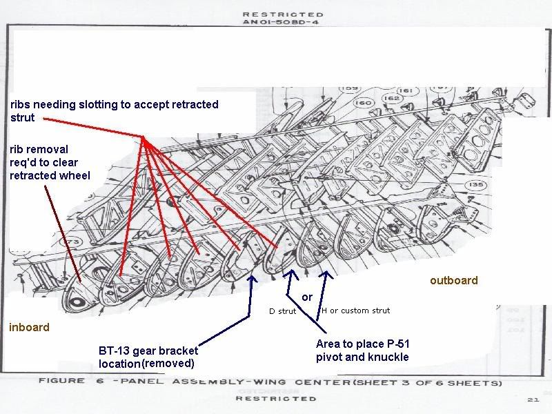

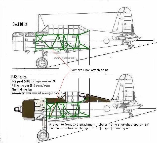

A few years ago I had looked at doing a 'semi-replica' P-66 from a BT-13. Realizing the BT was much lighter built, calculations showed a geared 1340 would give the final product near the same power/wt ratio, and have the same approx diameter cowl. Both planes use the same airfoil. It would also basically use most of a T-6 FWF for parts.
The tube center section of the BT is easily shortened, and the back seat used as the cockpit, being only a few inches off the original, if you did not want to build a new tube center section.
As brought up, adapting retract gear is the major challenge. T-6 gear is too short, but P-51 gear is about perfect if you do not wish to machine your own strut. The wing is shotened by removing the area of the outside flap, and bringing the outer wing inboard.
The weight and balance by rough calculations is actually pretty close, and I have all of the drawings and manuals from the Smithsonian already.
They do need a recheck by an engineer, and again realize this was for a fun replica, not an exact copy.
Here are some of the old initial overview drawings on the conversion I made years ago. I have many many more with details, but hopefully despite the reproduction quality you get the idea.
Hope this is thought provoking.

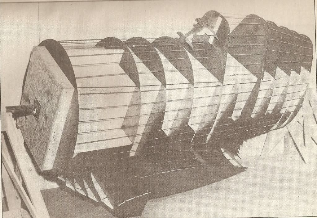

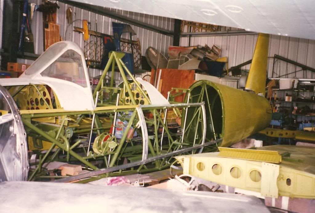

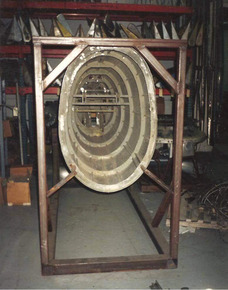

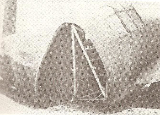

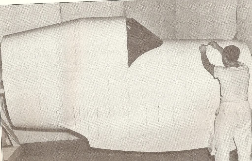

Here are some pics of the P-66 Mockup from a vintage tech manual:

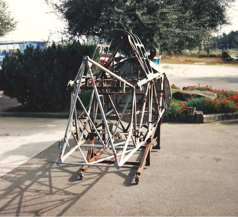

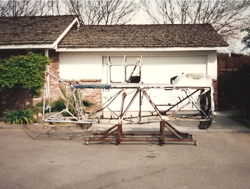

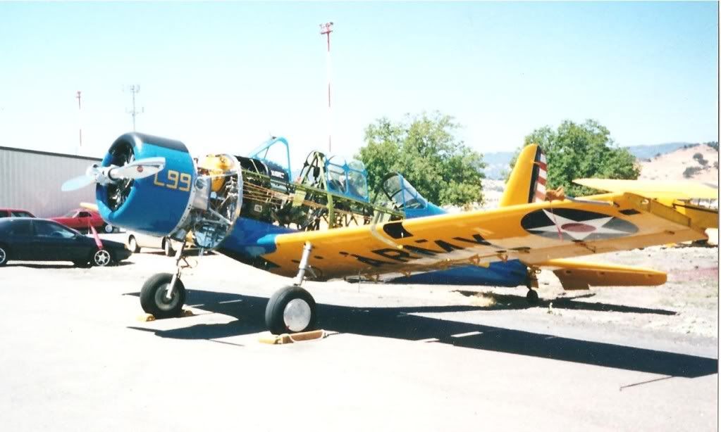

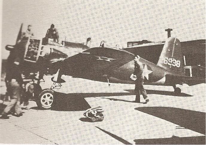

Here are some detail shots of a P-66:
And of a BT-13:
Here is an aft shot of a P-66:
And a BT-13 tubular frame and aft monoque:

I have the same drawings, note the rear hood reversed would make the windscrean. I think shortening the wings and moving the ailerons inboard would work. I still think T-6 gear will work if you weld two upper legs together, P-51 legs are 4" to short. Depends on which it cheaper and stronger.
Lay the BT drawings over the P-66 one.

The T-6 would really be all wrong to duplicate a P-66, I think mostly due to the tail section.
Stoney - another thought on the landing gear I had was to use all T-6 stuff - pivot, retract, locks, gear fork, etc, and just machine two main strut tube housings to accept the t-6 pivot fittings on top and the BT or SNJ piston, fork, scissors and packing on the bottom.
The wet wing is all aft of the spar, so a T-6 pivot does work well.
The P-66 did not have that little outer flap that the BT did, and you can see in my drawing that is what I deleted in the wing cut.

To do the flaps right, use split flaps like the T-6. I'd make fuel cells and get rid of the wet wing. Make a new tubular and engie mount. I already mentioned flush rivits. Or go to China and find one :) :)
