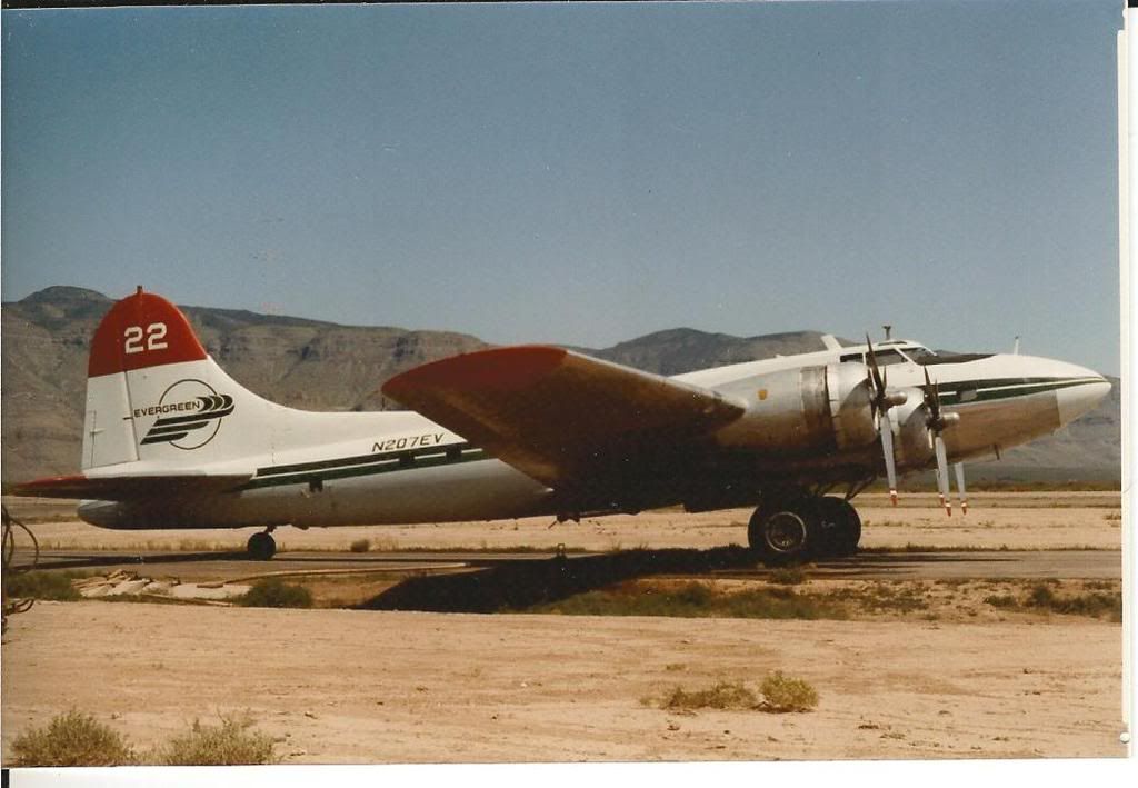

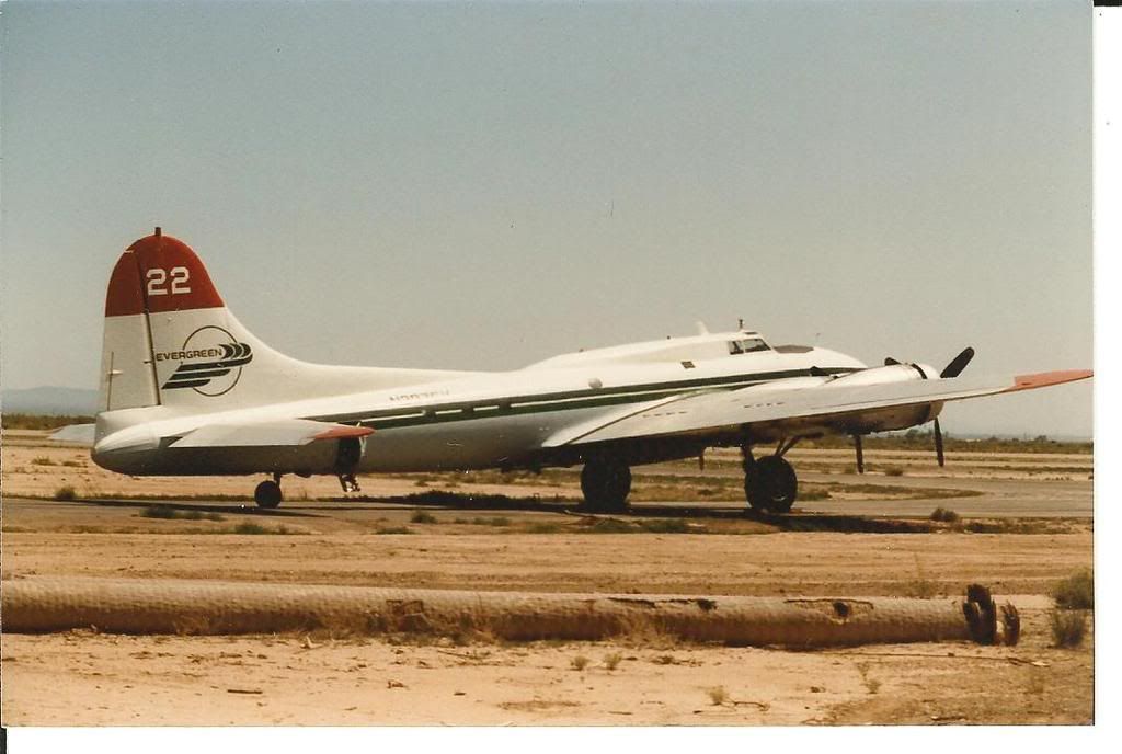

I was based in Alamogordo twice in B-17's.The first was in TBM's Tanker 68 (N3703G) in 1980 and the other was in Evergreen's Tanker 22 (N207EV) IN 1983.Alamogordo has a single runway and often has a strong and gusty crosswind.The best crosswind technique that I found with the B-17 was to carry lots of power on the upwind engines and as little as possible on the downwind engines as well as keeping the wing down into the wind while on final.If the wing came up or dropped more than I wanted,it was best to bring the wing up or down with the rudder rather than the aileron because it worked much more quickly.It wasn't unusual to have to reach up and pull power off the upwind engines for a few seconds and then put it back in to keep the nose straight.

Evergreen's Tanker 22 at Alamogordo in 1983
Another shot of Tanker 22 at Alamogordo in 1983
