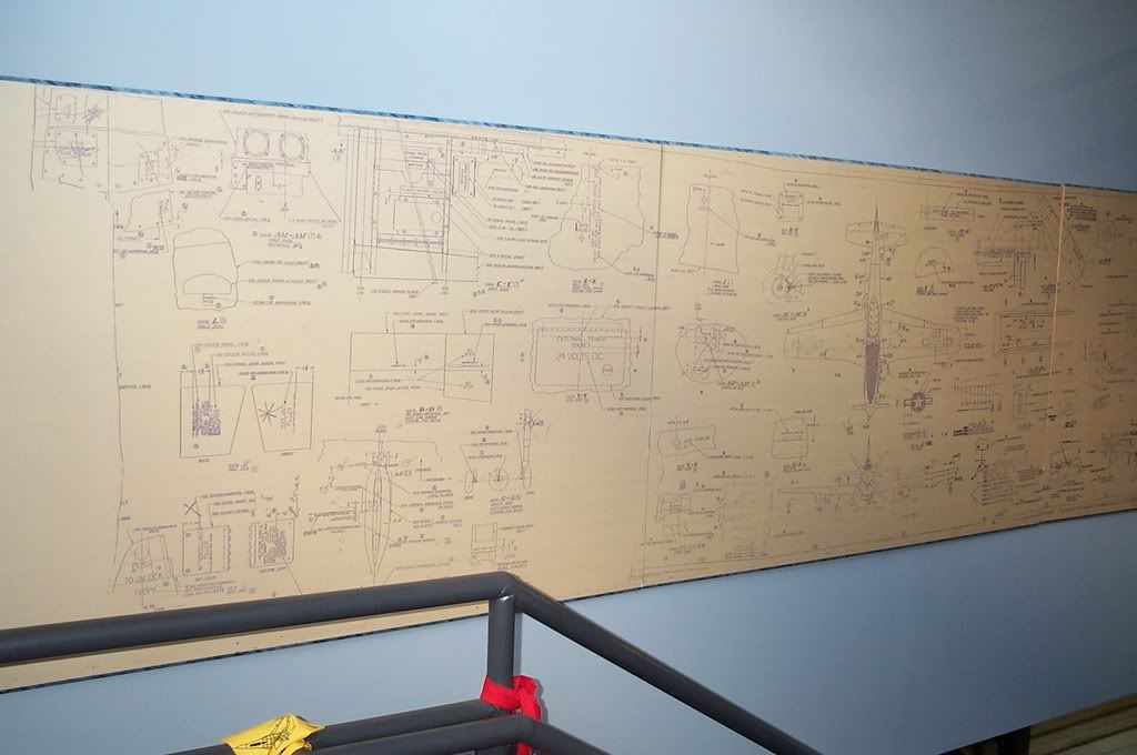

We have this P-51D aircraft marking blueprint hanging on the lobby wall.

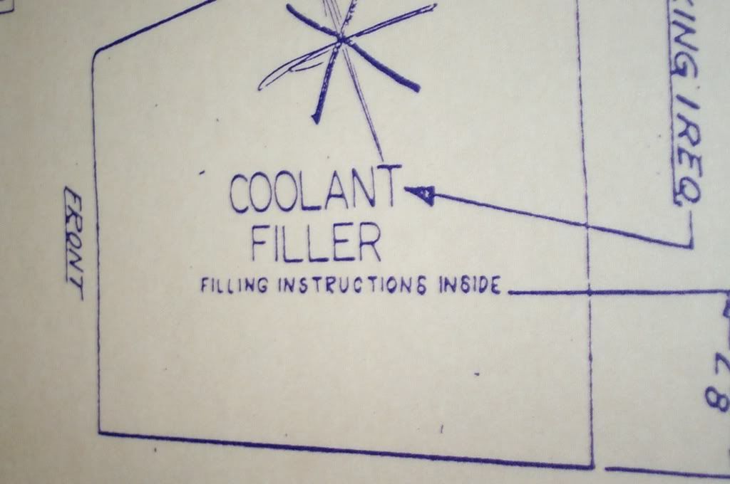

Coolant filler is located behind a panel which is marked as the following;
External-

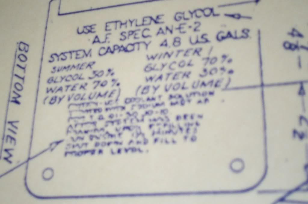

Internal- Hard to read- see internal aftercooler markings
Aftercooler access is marked as follows- (Should be similar to main coolant)
View of main coolant access markings on print-
Note that NaMBT is mentioned on the internal panel markings of the main system and mentions a TO. I didn't see any external marking on the print for NaMBT as shown in Jack's photo.
Nor are the gun camera prop spinner markings shown on this print.
