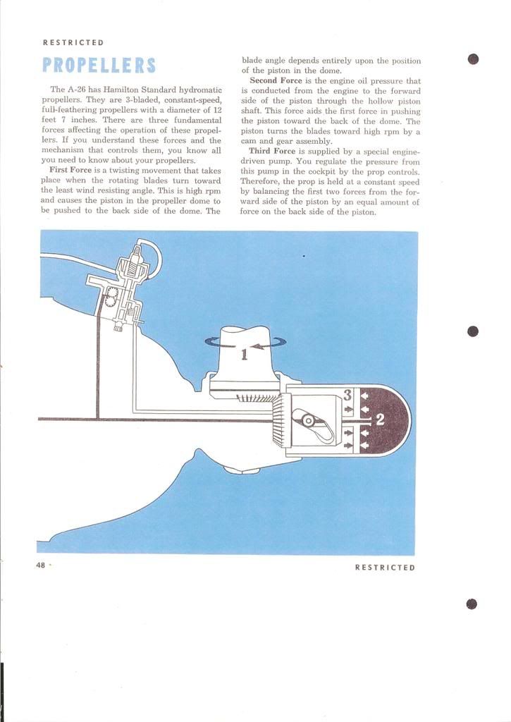

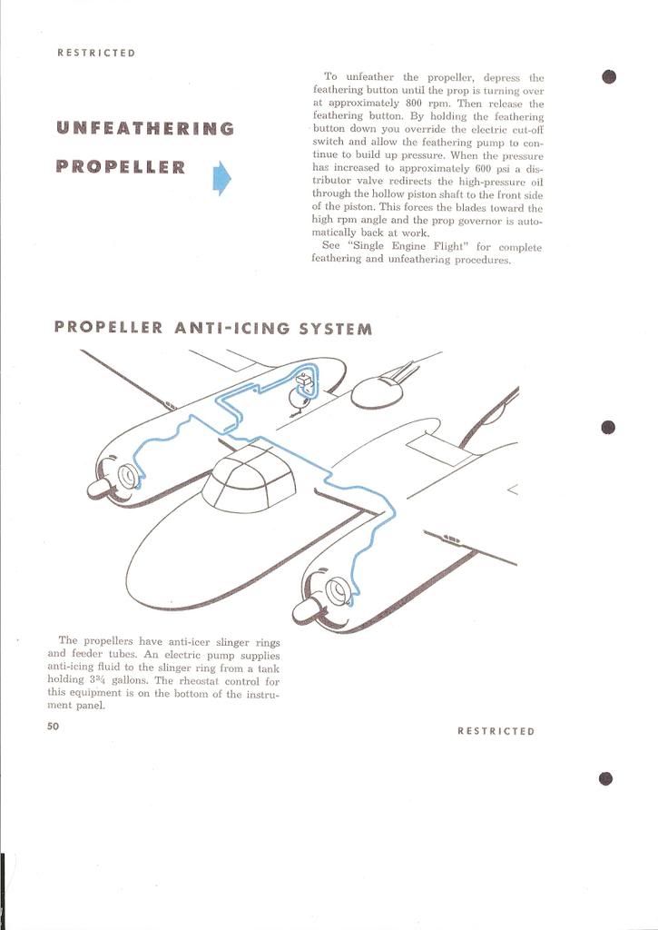

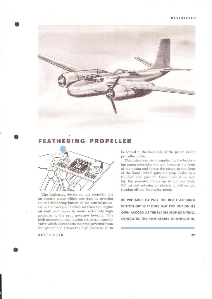

I'm curious about feathering propellers. I understand how a constant speed prop works but not really sure how feathering works. Is there an accumulater to feather the prop if you lose oil pressure? What holds it feathered – is it a counterweight? How can you unfeather without oil pressure (as was Larry's plan A to return home without anyone being the wiser?)
My experience with props is strictly single-engined.
PostPosted: Tue Jan 15, 2008 3:47 pm
Posts: 849
Location: Redmond,Oregon
Hamilton Standard Hydromatic props use engine oil that works on either side of a piston in the prop dome after being boosted by the prop governor.There is a separate high pressure feather pump that has a stand pipe in the oil tank below where the oil inlet line to the engine oil pump connects to the tank.This supposedly ensures that the prop can be feathered,even if the normal oil supply has been depleted.This same pump unfeathers the prop as well.The B-17 flight manual has several pages describing the cockpit procedure,but the pages below from an A-26 flight manual give a better basic description of the Ham Standard prop.I'll see if I have something that shows the governor in action.Maybe there's something in my DC-7 manuals.The feathering procedure is basically identical in these props from Twin Beeches through DC-7's.

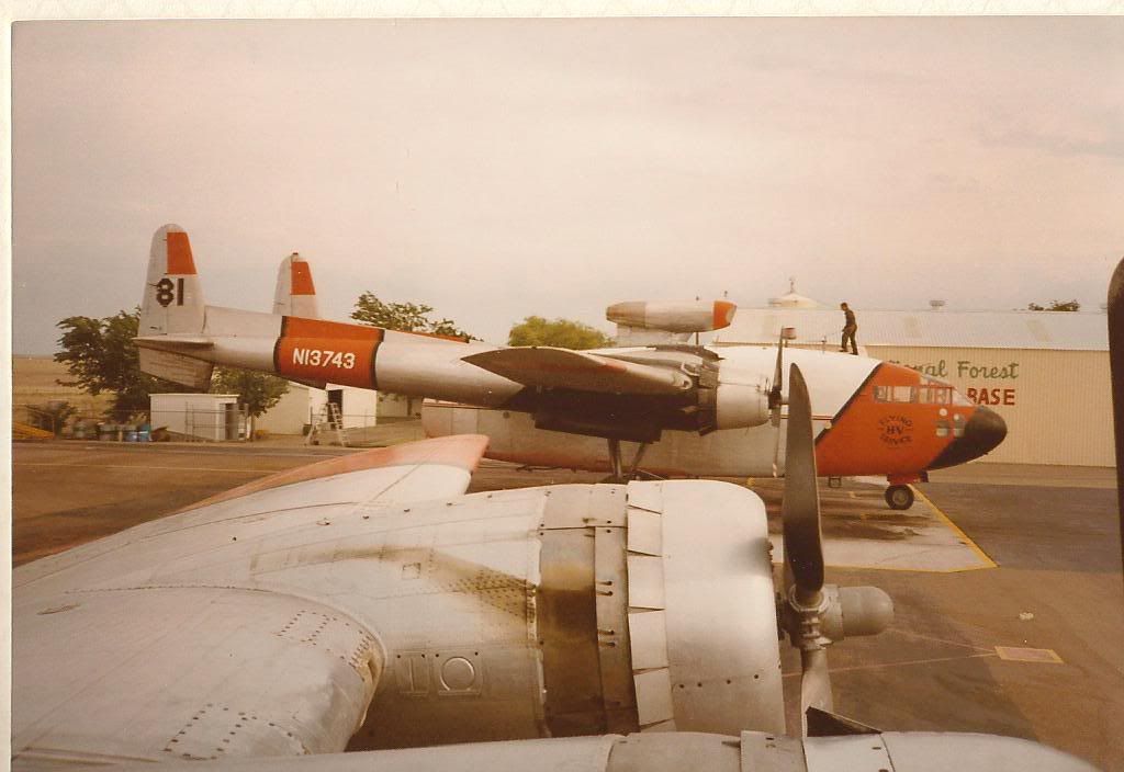

Aero Union's Tanker 17 aka N9323Z (which is now Sentimental Journey) was in Goleta on an extension of it's Coolidge,AZ contract.It was early September and the co-pilot needed to go back to school at Cochice College.Denny Conner (who's son Brent flies a P-3 for Aero Union these days) let my tanker pilot buddies talk him into using me as a replacement c/p.The idea being that we'd probably sit around for a week or two and at most do a couple of water drops.I couldn't believe my luck.
This was a big jump,as the hottest airplane that I'd flown as PIC up to that time was a Cessna 172,unless you count the couple of hours that I'd spent hearding a Baron around at the beginning of my multi-engine training (now on hold).The first flight was a revelation in a number of ways.I'd flown in a Beech 18 from Goleta to LAX and back once,which was flown by Howard Haradon,but that was it for multi-engine taildraggers with radials.
I hadn't quite mastered keeping the props on the Baron synched,and it had a synch wheel.Tanker 17 was in need of some repairs that were being deferred as it was going to be released at any moment back to Areo Union.Only the #1 tach worked properly,for instance,and while #2 bounced plus or minus 300 rpm,#3 and 4 were completely dead.There were also problems with the turbo amplifiers and it was common to have the wastegate open on one of the turbos in flight when the 1/2 amp fuse would blow in the amplifier box.
The first flight was out to do a water drop in the hills north of the airport.There were two F7F's based at Goleta at the time with Stew Kunkee and Buck Radcliffe flying them,if I remember correctly.They took off first and raced out to do their drops so that they could come back and make pursuit curve gun runs on us as we lumbered out to the drop area.That gave me a real idea of how helpless it must have felt to fly a B-17 in combat.
When we got to the drop area,I was trying to set up the power and follow Denny's instructions in the drop pattern.I happened to look up on final for the first run and all that I could see was canyon walls.That was also a revelation,as I thought "You know,this is a lot more fun to watch than it is to do!".That thought comes back occasionally,even now,as I still fly tankers.Anyway,we survived the flight and I managed to prove that if you are competent in a B-17,you can fly it successfully even with an idiot in the right seat trying to kill you at every opportunity.I've been paid back in spades in that category over the years by co-pilots of my own.
We ended up flying maybe 10 hours on a couple of fires,including one out of Porterville to a burning log deck at the Inyokern Mill.So,I can say tht out of my first 18 hours of multi-engine time,10 of them were in a B-17.I was offered a job as a B-17 c/p by Larry Hill,who worked for TBM Inc. flying Tanker 61,which is now in the museum at what used to be Castle AFB.Incidentally,that was TBM's only Boeing built B-17.Most of the tankers were built by Douglas at Long Beach.
