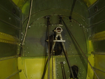

Yes this Beech is a long way from it's military configuration.
She was built in March of 1943 as an AT-7 Navigation trainer, or military C model serial number 42-56725, and was delivered to Hondo Army Air Field in Texas.
Post WWII she went through the typical modernization at the Beech factory and emerged as a C-45H with the serial number 52-10636 (Military configured D model). She flew with the Strategic Air Command for a while until she was retired at DM in 1958.
She went through many different civilian owners and received many different civilian mods to her airframe and engines. One of these mods was the increase in the cabin height just like the late civilain E,G and H airframes. Other mods were as you noticed; the short stacks, carb air scoops, wing tips, picture windows etc.
Here is a shot taken during a recent inspection of the inside of the rear fuselage. In this shot you can see the original bulkhead contour and the extension added. The yellow zinc areas are mostly factory whereas the green zinc areas are the modified areas. You can see the green zinc skin strip added down the side of the fuselage as well as the bulkhead changes.
I find it hard to understand why someone would spend so much money and effort on an old Air Force Beech but they often did. The Beech factory had what they called "Modernization Kits" to upgrade the civilian and ex military aircraft that were flooding the market. Most all of the mods that this Air Force C-45 has were factory kits. It seems to me that when it comes to 'modernizing' or 'upgrading' your aircraft the attitude is usually "If you build it they will come". Just like today with the Mooney or other aircraft owners. How much people spend just to get another 1.27 knots out of their airframe has been big business for manufacturers and STC folks.
