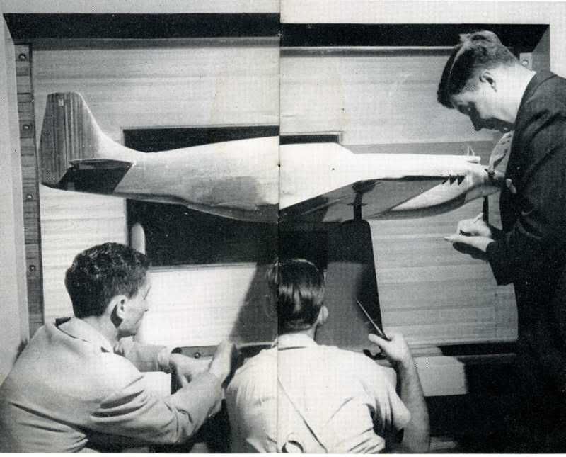

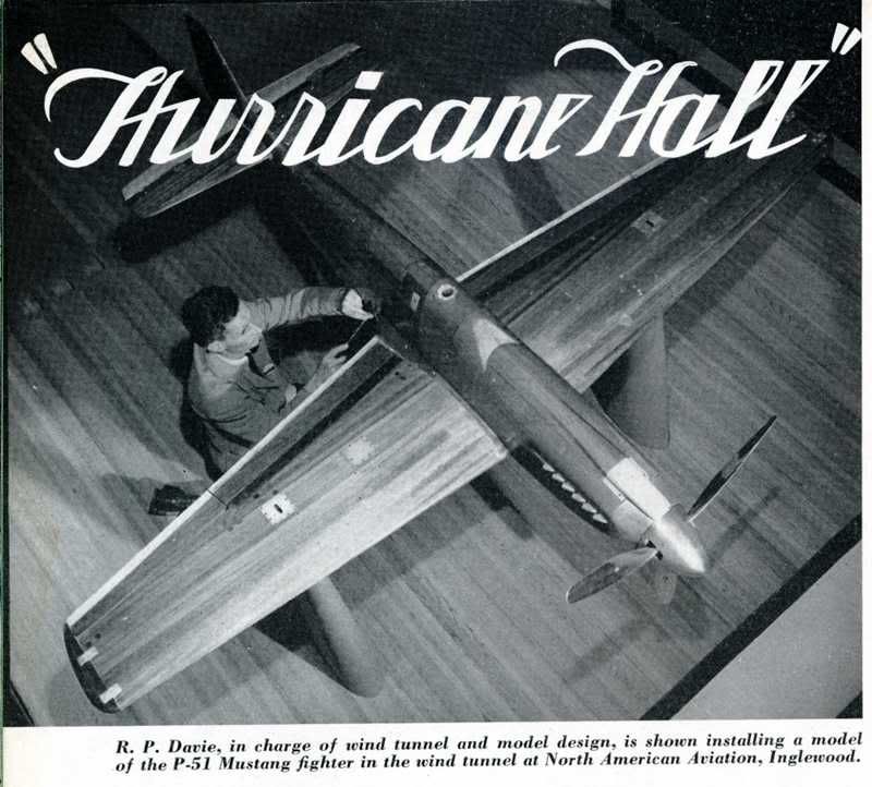

I don't know the answer to your question...but here is a picture from one of my Dad's NAA magazines, March 1943, of a wind tunnel model.
It looks like either an A-36 or an A Model (Allison powered anyway) with a filleted type tail...
Dad talked about lofting the first "new tails" and how they thought it would fix a whole range of problems but I have no clue as to when this was..it had to been after July of 1943 because that's when he finished his "Advanced Lofting" classes.
Another pic and the cover.

Awesome photos!
The second photo looking down on the wing is great. You can see the difference in the leading edge design from what it had in the B/C and D.
The covershot you can see the addition of the leading edge extension near the engine.
The wind tunnel is neat with all the hardwood.
Rich
