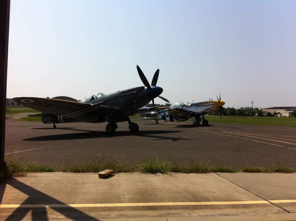

Cool photos Jim. I like the one with the Spitfire and Mustang. Pretty cool to see you up with 2 F-4s!
