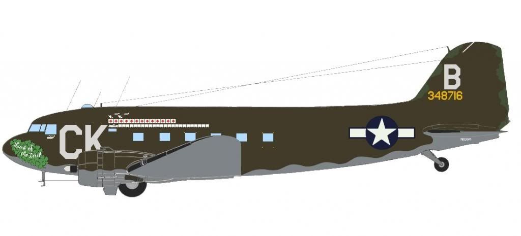

Here is something i have come up with that it might be, at least in the way of a general idea. Now, at first, I was not planning this many clovers, it just ended up that way as I was using a clipart from online and was trying to fill in spots to make it somewhat smooth like it appears in the photo.
Obviously the font is not even close, but it most closely matched the upper case L, so I just went with it for a general sketch as well as the lack of double apostrophies.
The nose art.
on the plane
now that is a very rough placement on the side view. When I initially did the side view, I lost all the detail of the rivet lines and antennas when I repainted it...

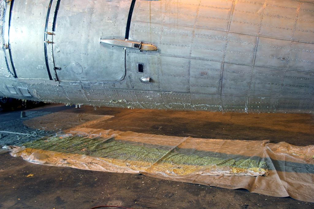

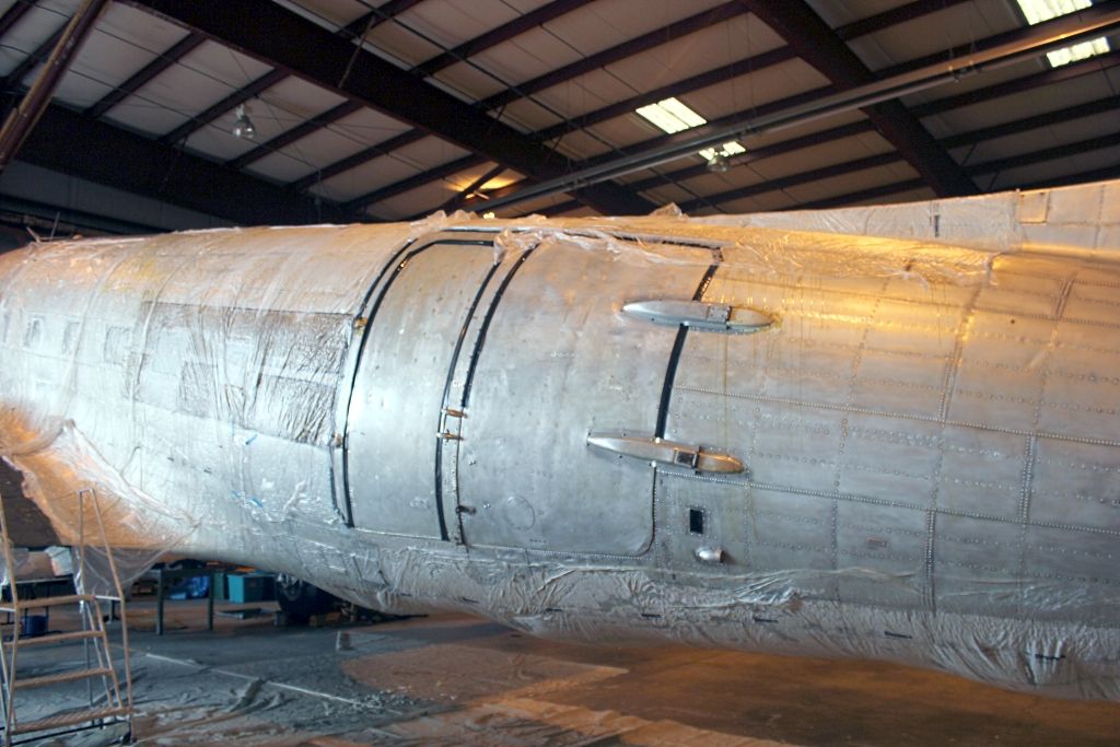

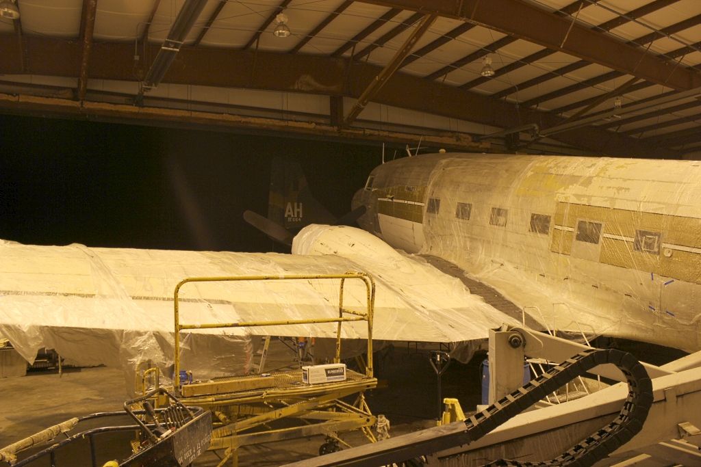

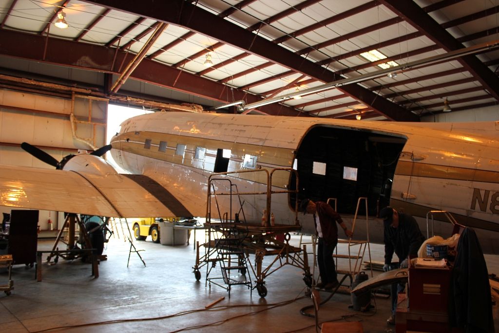

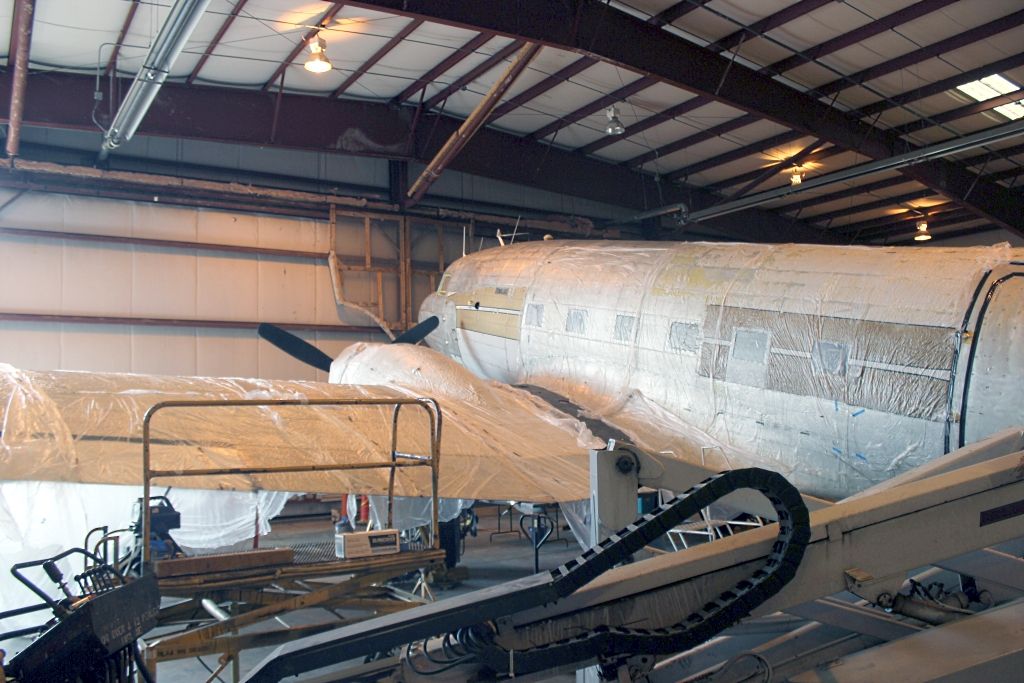

I was hoping to get the entire plane done today, but that didn't happen... We stayed late last night spraying on stripper to have a big cleaning day today. We ended up wasting 3 hours more than we planned yesterday preparing everything for the plane such as moving other aircraft out from around it or under it and just general preparing. We ended up not even starting spraying until 6PM.
Then our man lift, which is electric, decided it wanted to be very slow and not charge so that slowed us down. And finally, we had wind competing against us with the doors open when we were trying to lay down the plastic sheeting. It was only myself and another member who was doing all of this as well. We determined when we do this again this upcoming Friday/Saturday, we need at least one more person to help, if not two.
We ended up spraying the majority of the left fuselage minus one section just behind the cockpit windows that could not be reached with the lift from behind the wing... I also sprayed the top of the wing from the root to about 2/3 way out to the tip. And finally, I sprayed the belly from the tail wheel all the way forward to the trailing edge of the wing.
Today, we came in, removed the sheeting and then brushed the majority of the paint off. After that, we pulled the plane out and used the power washer to clean off the stripper. I have to say, the power washer does so much better than cleaning it by hand. It would also remove what little bit of paint remained from brushing.
I also decided that we are gonna strip the plane and then once its been covered and stripped once, I am going to reapply stripper to it and cover it again to get any remaining paint off. With one of the below photos, you will see between the first and fourth window, it appears excessively clean or as if their is corrosion on the rest of the plane. That area has actually been stripped twice with the EFS-2500. After seeing that section, that is what made me decide to do the entire plane twice.
BTW, so far we have used all of 10gal of stripper. They said 80-100 Sq Ft per gallon, but as you can see, we are getting much, much more than that.

This was in April, but gives a good Before (overall) picture
Last night
This Morning
After Being Washed
Being Pushed (pulled) in
And after being pushed back into the hangar.
The other side

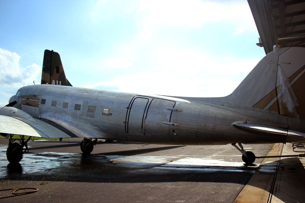

Another HUGE work weekend! As of Today, the fuselage is nearly 100% stripped.
More or less, the only paint that remains on the fuselage is that just under the horizontal stabilizers just aft of the tail wheel and some paint that remains on and around some rivets. We will be doing another application over the entire fuselage to remove any remaining residual primmer or any paint that remains on the on the rivets heads just to make sure.
We also stripped the entire belly of the fuselage as well as the underside of the wings from the outside edge of the inboard flap on the right wing to about half way out the aileron on the left wing. Also stripped was the inside of both nacelles.
So the left wing is about 50% stripped. Again, we will apply a second application once the entire wing has received its first application.
And for the pictures... I almost just want to say at this point lets just polish her lol.

And Finally After washing her. We had two power washers going today washing her down.
After being pulled back into the hangar once more
