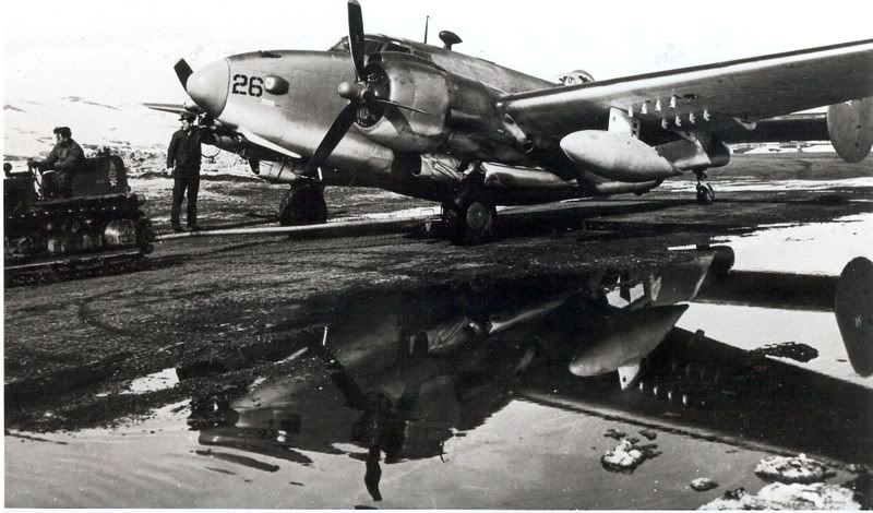

PostPosted: Mon Mar 07, 2011 8:37 pm
Posts: 1487
Neal Nurmi wrote:
So why the tracks -- you'd think it would be used mainly on carrier decks or paved hardstands? And why would it be designated a skid, rather than a dolly or cart?
Imagine where the PV-1, PV-2, PBY's, PBM's were operating when using the torpedoes and bombs-usually out on the front lines or close to it. Tires work good on hard ground but not so good in the mud, snow, slush or sand typically found where these guys were loading bombs and torpedoes. The tracks helped distribute the load over a greater surface area as compared to a tire or multiple tires and made it easier to push the skids and dolly's under the aircraft into the bomb bay or under the wing.
Here are a few examples:

I know that color photo well. There are a couple of Aleutians veterans in the PBY@yahoo e-group.

Look at the caked mud on the axle/lug nuts!

Is that bomb hauler truck the same or similar model to the restoration that was at TOM last year?

The color picture is actually a PV-1. The nose glass was one of the earlier ones, later replaced by a solid nose.
