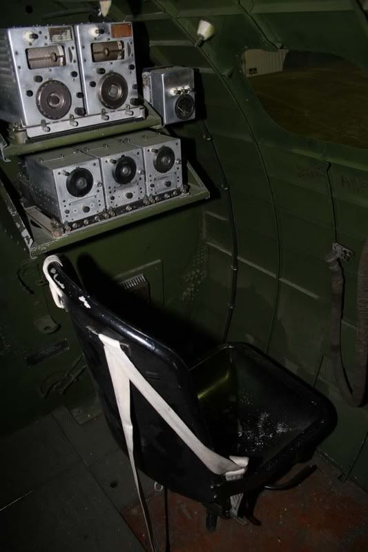

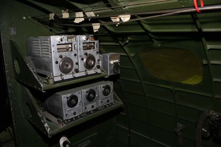

Here are some Radio Room pics.
You can almost smell the Ozone and hear the crackle...
Reminds me of the question... What was the most common phrase over the radios during the Battle of Britain?
"Say again!" :D
This area has NOT been restored yet, but the equipment was ID'd and set aside for the final installation.
[IMG]
http://i118.photobucket.com/albums/o81/ ... Stack1.jpg[/IMG] note the genuine CAF fan in the bottom photo!
AND the skanky control cables. We have the new roll of cables and are working on getting them cut to length and the ends put on.

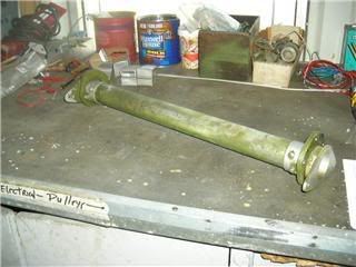

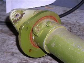

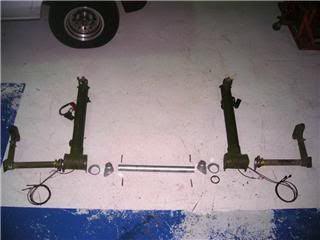

Tweren't a half bad weekend at the hangar!
First up...the infamous Gary Austin insisted we "at a minimum" lubricate the bearings on the control yoke.
First picture up is the connecting shaft between the pilot and co-pilot's yokes. They were sporting to get out, but upon inspection the bearings were found to be as smooth as kitty litter on concrete. Good call Gary!
For you turret guys... I will take better pictures later, but this is what I have to offer up. We put the side stanchions on the pedestal and placed the top mechanisim in our handy assembly frame. The sides caused quite a debate, because all of the pictures and manuals we were finding showed the round pipe stanchions. We even visited LSFM and Thunderbird has the pipe style holder uppers. THEN finally I saw a Picture in B17s IN COMBAT that showed our style of turret being set in a shiny new B17G. Good enough for me!

Freshly removed yokes and previously removed torque tube
Smooth as Kitty Litter on Concrete
The stories I could tell you on what it took to get this out! But since the site is censored DON'T QUOTE ME!!!

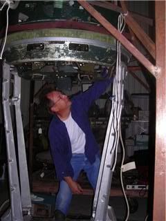

This picture is called T-squared... Actually it should be cubed or 4ple-ed?
Tom Taylor working on the Top Turret.
The tilt and rotate functions are being brought back to life. IT LIVES!
