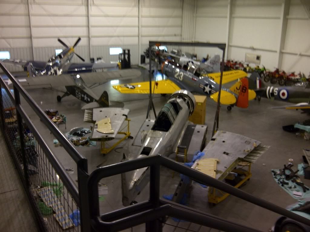

The SNJ-5 is now topless.
I found an localized area of corrosion under a canopy rail-
The T-6G after the annual and it flew a few hours today-
BE has had an oil change and brakes adjusted, Jim flew a short flight today-
The 3 flyable hangar occupants-
Some original colors in the SNJ-3-
I think the lighter green is from the factory and the darker green is from its O/H at Corpus Christi NAS in 44.
