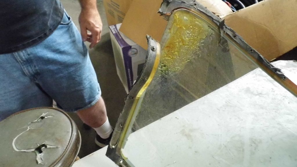

Time to go shopping for the right side cockpit windshield. It is delaminating and one edge of the frame has corroded out. Windshield we can have made, but the frame is another story. Our sheet metal guys are going to have to ponder this one. Good thing we got two sheet metal types who came for the first time today to volunteer. Plenty glad of that. We are up to 21 people now. Could use a few more sheet metal workers. Got lots to do to make her all pretty again. You can find us at Meacham Field on Saturdays primarily now. Stop on by and pay us a visit. Be glad to show our work done and work to go. JR

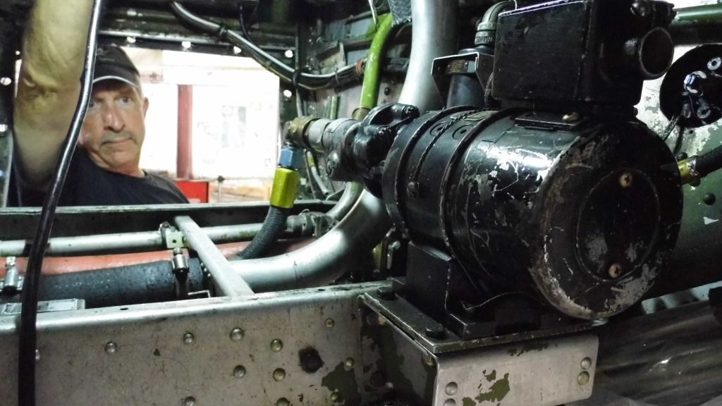

Trivia question of the week. What is the big black round sorta looking thingee and what does it do? Tim is wondering so please help us out. :-) He spent a great deal of time changing out old black hoses today. The old ones didn't want to come off and the new ones certainly didn't want to go back on. Go figure! JR

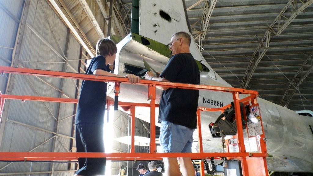

David L and grandson Ethan installed the inspection plate back on the tail and then started measuring and cutting the P seal that will be glued in place around the mounts for the horizontal stabilizers. Yep, they are getting close to being ready to hang back on the airplane. JR

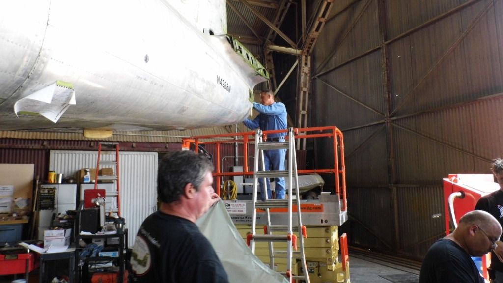

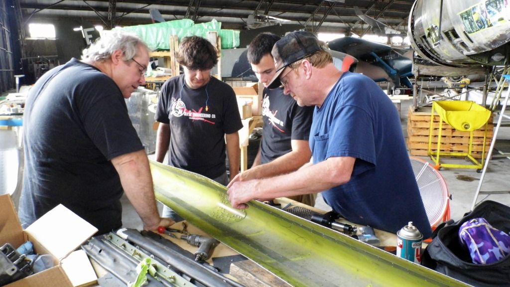

The gang was all very excited to see the famous 42D patch get finished up on the leading edge of the horizontal stab today. They got this done and started prepping the rest of the outside and inside for primer. One of our new sheet metal guys, "Strat", helped finish it out. Kewl!! JR

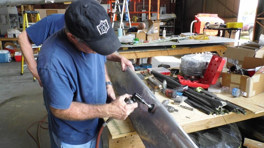

Joe T and Strat smoothed out the external side of the 42D patch. There are a couple of holes where the pneumatic tube came through for the leading edge deice boots that will need to have a half dollar or so sized plug stuck in and then it should be ready to start shooting back on the stabilizer. Niiice! JR
That is the prop feathering pump.
Nope. Electric hydraulic pump.

Oh wow, we have two very plausible answers. The motors are very similar for the feathering pump and the standby hydraulic pump, so Tim had to look it up in the IPC (Illustrated Parts Manual) and it shows it to be the prop feathering pump. It is a big hummer is all I can say, but look at the size of the prop it is dealing with. JR

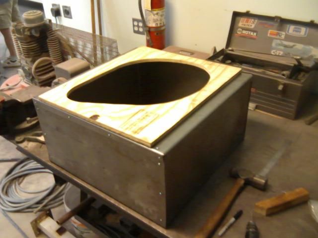

Clay, our most excellent metalsmith and all around engineer, is working on this contraption for the A-26. WE intend to go first class in our airplane. Any guesses as to what this is going to be?? Hmmm?? Gave you an easy one this time!!! JR
That's a potty box, innit?
