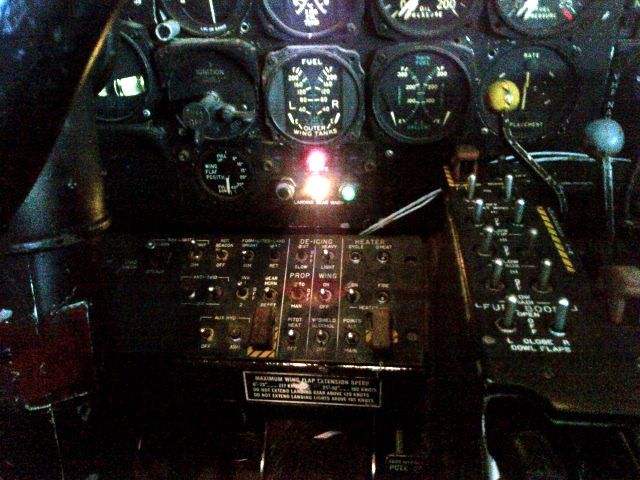

Our electrical system guys were busy yesterday rigging and checking out the landing gear warning and indication system. The horn works!! This is a gear in transit indication. All of the lights are doing what they are supposed to and the only thing missing is a lens cap for the center gear indicator. JR will no doubt come up with a source, but if anybody just happens to have one laying around, feel free to give us a shout! :-) The Other JR

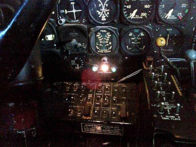

Another shot of the gear indicator lights which show "three green"! Well, ok, two green and one white... the white being the missing lens cap. This marks another milestone on the road back to flight. The team was very pleased to get this done. JR

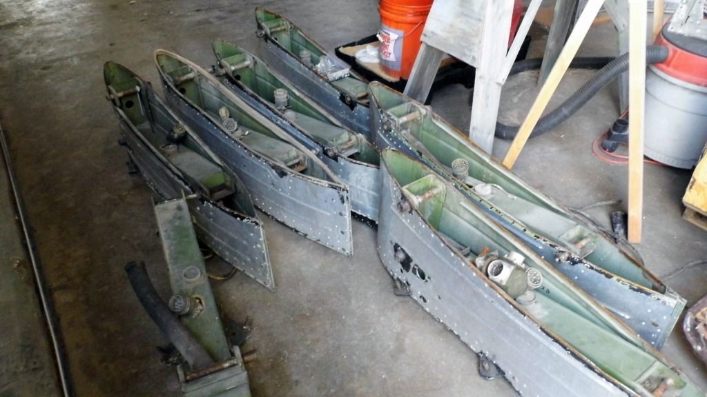

It seems like there has been something missing under the wings for a long time. The bomb racks were pulled off after the paint was stripped in Denton to finish the job underneath them. We have dragged the racks out of storage and have begun the clean up on these. JR
PostPosted: Sun Jul 01, 2012 8:11 am
Posts: 2563
These are the said bomb racks. The two inboard pylons are plumbed for 230 gal external fuel tanks. We would like to acquire two of these tanks if anybody knows where to look!! Functional is desirable. JR

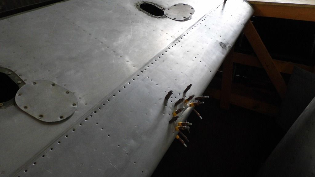

The famous 42D patch is ready to shoot as is the leading edge of the right side horizontal stabilizer. We have been looking for a Cherry Max rivet gun to help with the places where we have to use them. The A-26 Legacy Foundation came up with a donor who is shipping same to us as we speak. Many thanks to Don and Tom for contributing so much to our effort. If you have not visited the Foundation website, please check out the photos and stories of the Nimrods in action. This website was founded by the sons and daughters of the A-26 vets and they have long supported getting the K model back in the air to tell their story. Ck out http://www.a-26legacy.org Thanks! JR

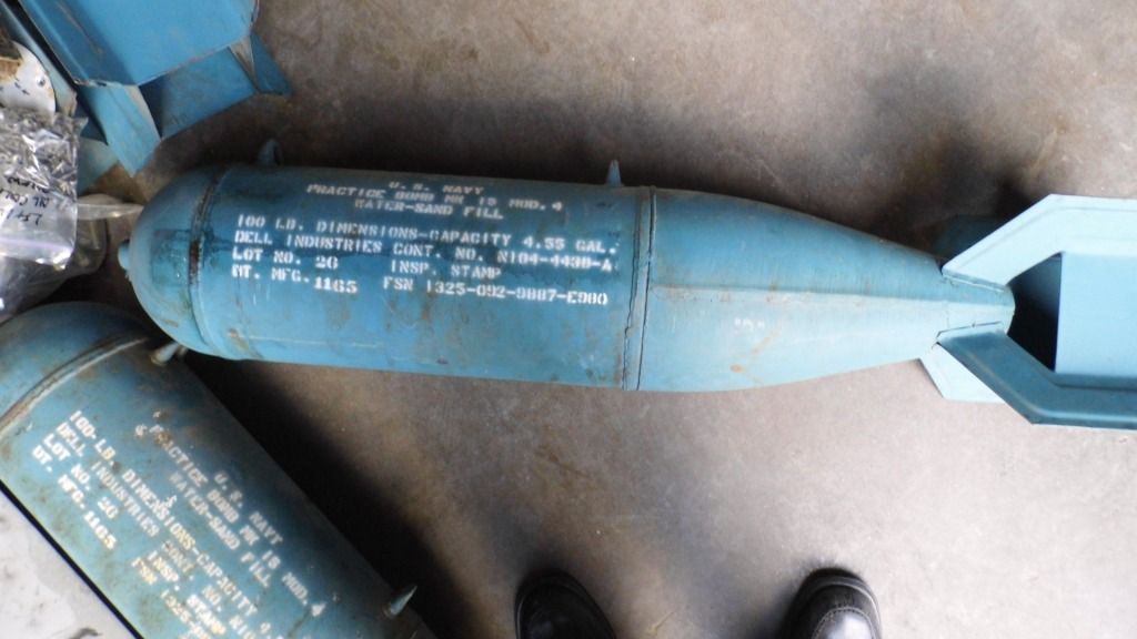

We also dragged out some of our 100 lb practice bombs. The plan is to repaint these the proper colors and hang them in the front of the bomb bay where there were racks for small ka-booms. I suppose hundred pounders would be too big for a pig hunt? Some of you might think that is cheating, but I contend that we could get the whole herd with one pass. Heck, probably take out a few of those pesky little buggers called fire ants, too!! I am all for that. We could open the mounds with the hundred pounder and then roast the lot with a nape on the next pass. Now that is what precision bombing is all about!! :-) JR and the Ace Hog and Fire Ant Extermination Company of Texas!!

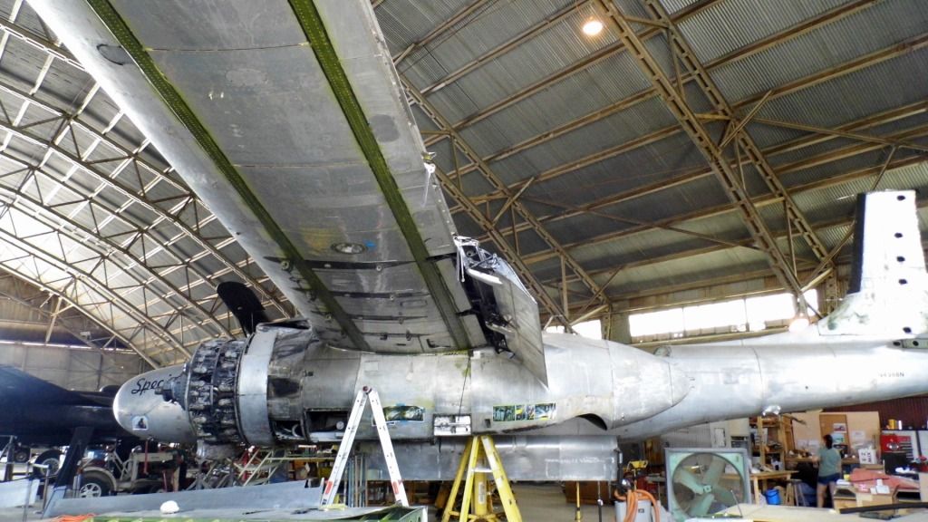

Nope, this is not the same picture as one shown earlier. Big Mike and his daughter who was visiting from VA are in this one. Always glad to have family come out to see what we are doing. Big Mike is one of the mainstays of our team. He, like most Aggies, always gives 110 per cent in whatever he is doing! Somehow though, his daughter is much prettier than he is!! :-) Anyway, this shot shows one of the main features of the K model wing. OnMark rebuilt the wings and placed steel spar caps on the top and bottom to make sure they stayed where they belonged. This also enabled the wing to carry 4000 lbs on each side plus the 165 gal tip tanks. Would be handy to have the external tanks and the tip tanks functional for those long hauls out east or west... you know to the Texas border with La. or NM. :-) From the Lone Star Republic, JR PS to the O2Lady, I am still waiting on those meeting minutes!! :axe:
