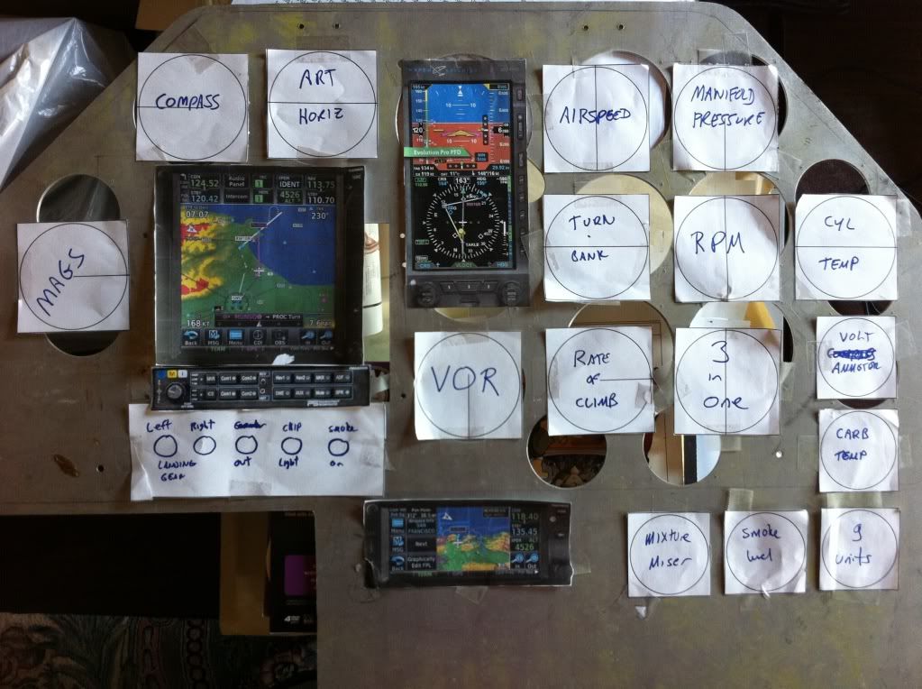

We're trying to figure out how to redo the SNJ and the T6G panels. Here's a rough design I've done for my SNJ. Forget about period correct for ops in the Northeast.
Great looking panel Jim, its better than most corporate a/c I have been... :wink:

Posts: 4528
Love the GTN units mocked up there. Those are some nice pieces of equipment!
