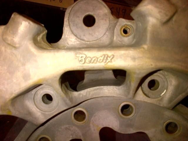

The brake housing came out clean and the Bendix trademark was nice to finally see. The guys at Aviall are doing a magnificent job on the overhaul. They report it should start going together tomorrow. Sweeeeeeet..... JR

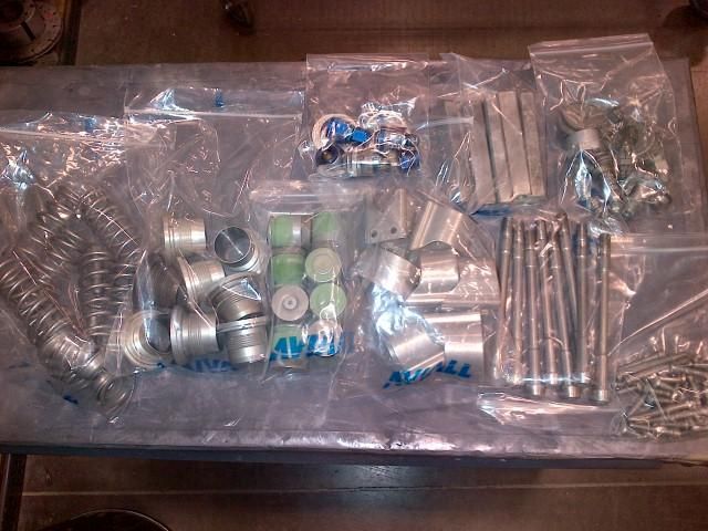

So what goes on the inside of the brake assembly? This is all the new stuff all sorted and ready for the install tomorrow. Can hardly wait as this looks like a piece of art work that we will hate to have to cover up in the wheel, but a pilot gotta do what a pilot gotta do.... make the airplane behave and brakes are a big player in that. :-) JR

Actually, the set up on the Texas Special nee Spirit of Waco is much better than the WWII version. The Spirit predates On Mark but Robert Denny was at Grand Central which converted the airplane to the executive version with the new DC-6 brakes and then he moved to start On Mark. When the AF was talking about super sizing the weights carried on the K, they needed more brake than what the DC-6 had in order to handle relatively short fields. The K's brakes were much beefier and had anti-skid which was a very important feature on PSP or unprepared dirt strips especially with the higher landing speeds. Recall they were originally built to go anywhere in the world and did.. besides NKP. The also had reversing props to really help get stopped in a hurry. Anyway, the antiskid etc make for more parts to go into the assembly. Lots of progress on them today. Hope to have the assembly back from the shop next week. One more part from plating is still out on the left gear and then it can all go back together. Yay!! JR

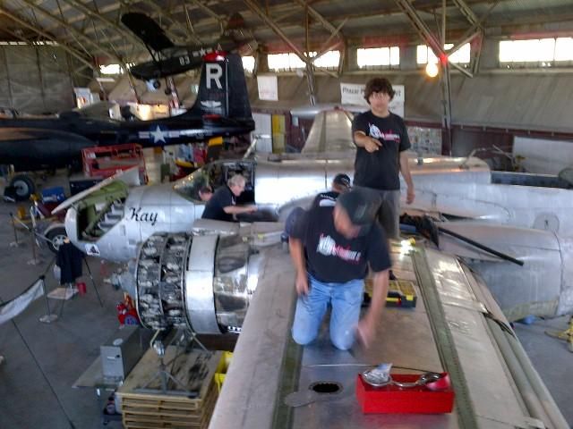

PostPosted: Sun May 20, 2012 5:33 pm
Posts: 2563
Work on the oil cooler actuators and other things topside was just a blurr of activity yesterday. The real JR came up with another landing light for the right wing so we are anxious for our electrical genius's to try it out next weekend. We had lots of visitors over the weekend, in part, due to the FAAST TEAM holding three days of classes along with the high altitude training chamber. The museum was pleased to be able to host this event. The CAMI folks from Oklahoma City put on a fine show and it appears some pilots got some very good lessons on the effects of hypoxia first hand. We saw some pretty woosey looking people in there really enjoying themselves until the instructor had to put the oxygen mask back on them. :-) There are times when being a HE-MAN just isn't wise like when trying to show everybody else how long you can go on low oxygen!! I don't think our guys up on the wing were in danger of hypoxia though. We had baked taters and chili for lunch so maybe there were other dangers involved. Maybe I shouldn't have put beans in the chili?? :-) Anyway, we were also pleased to have the O2 Lady drop by to join us for chili and another special guest which we have been anticipating for several weeks. More in the next post about that. The other JR

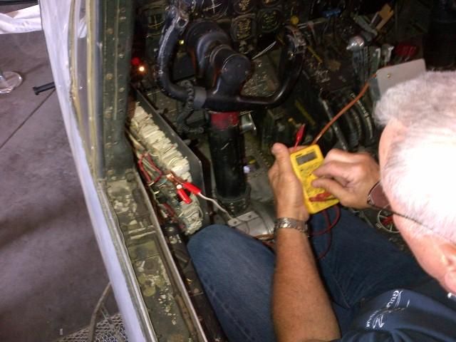

Some of our electrical genius's designed and built a tester for all of our circuit breakers. When they told me about it, I said, "Breaker, Breaker one nine". They all looked at me in disgust. Guess CB lingo was before their time. Anyway, they are making great progess checking out the circuitry. Seems we do have a little problem getting power out to one of the oil cooler door actuators, but nothing our guys can't fix with time and money, right?? JR
