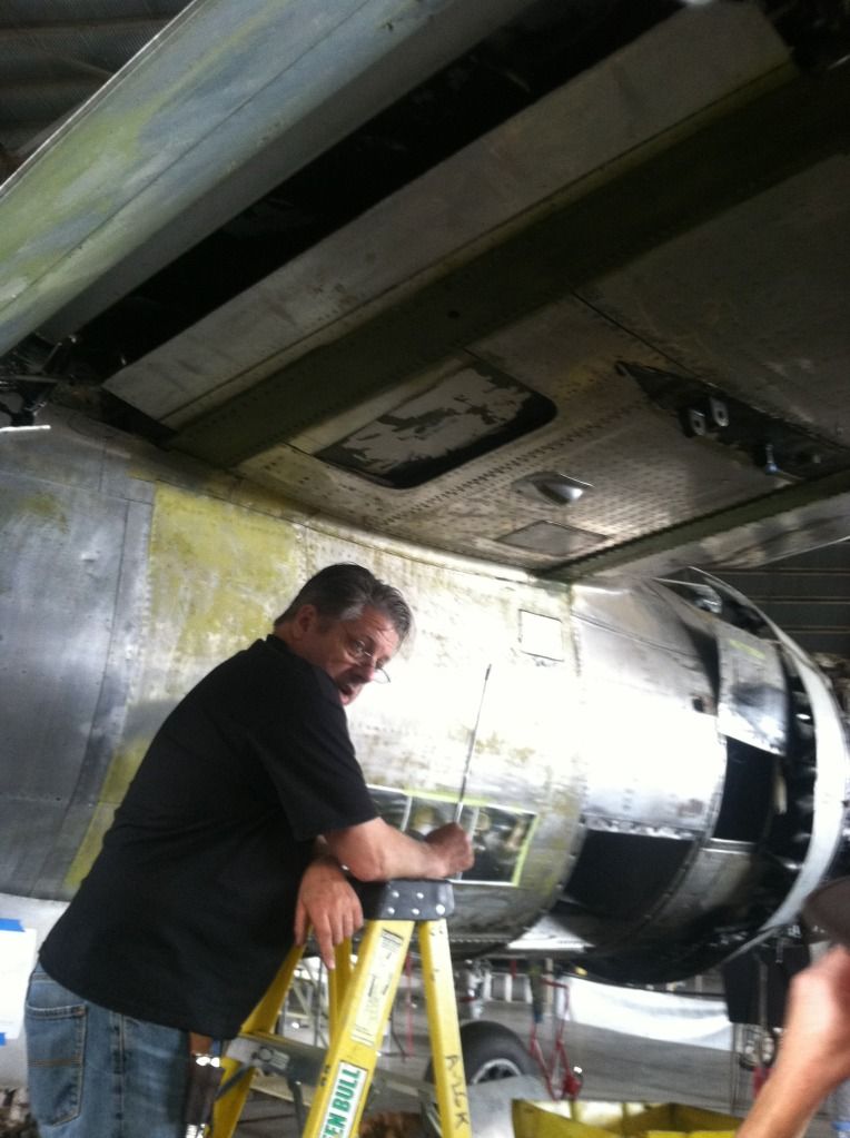

Tim is up on top of the wing wrestling with the oil cooler door actuator compartment trying to clean out 47 years of accumulated dried oil mist and crud. Funny how the house picks up a little dirt over the years when nobody is looking, isn't it? Well, it looks 100 per cent better now. JR is down below trying to figure out if we can save the actuator. It is binding a bit and so is the door itself. Bad combination. We have no doubts he will figure it out, but just in case, we have located some serviceable units, thankfully. Yall take care and come see us this weekend. There will be lots of activity here at Ft Worth Meacham airport on Saturday especially. The other JR

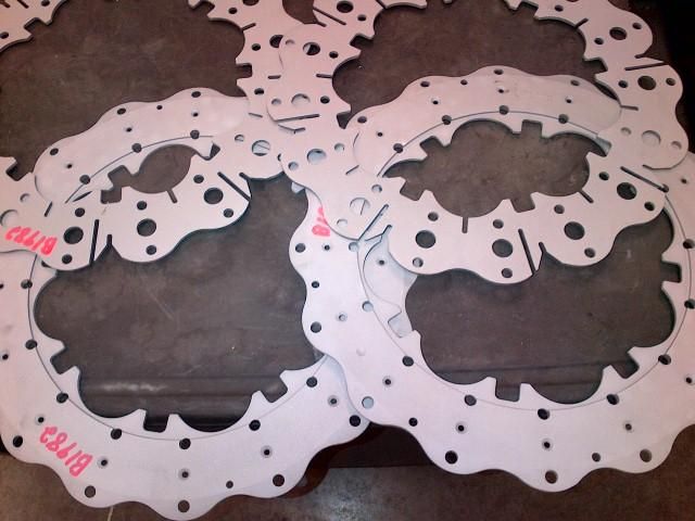

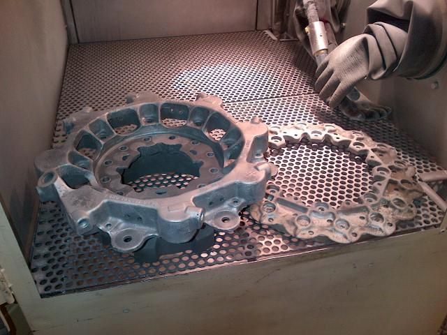

Got good news from JR today. The brake housing and rotors are cleaned up and waiting on Magnaflux. The guys at Aviall's brake shop do nice work. Many thanks to those folks over there for helping us out with the overhaul. The Other JR
PostPosted: Wed May 16, 2012 7:21 pm
Posts: 2559
This is how the rotors looked today. Came out really nice considering how rusted everything looked inside the brake housing. TA DAH... JR
