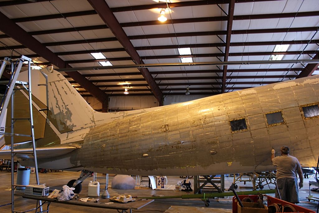

I was not intending on doing any stripping this weekend as I wanted to wait until I could clean up using the pressure washer... but I was conned into doing some and this is the result...
Just about the entire Right side of the fuselage is stripped minus the vertical stabilizer and just under the cockpit windows. I will still have to do some spot stripping as well, especially around the windows.
After I got the paint off, I did find some light surface corrosion in some areas that will have to be treated prior to us painting it. It appeared to me to be light stuff that will easily be fixed.
A lot of the paint was already taken off from our previous test patch, but I cleaned up what was left as well.

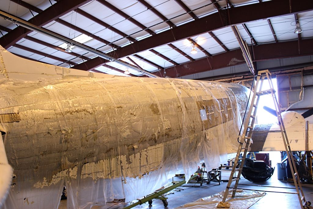

All Covered up (The weight of the paint itself started pulling the plastic away from the fuselage)
After it was pulled up

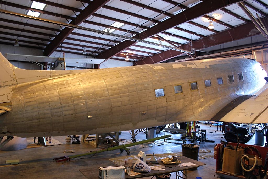

After being cleaned up
And full Shot.
Just have to do the left side and Top/Bottom for the fuselage to be finished. Not too bad for just five hours total of work. I would be able to have done it in about 2 hours total had I been able to pull it out and use the power Washer.
