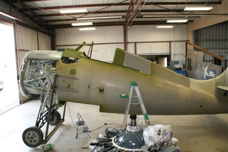

Generally something like a fuselage is pretty easy to inspect as access to everything is pretty straight forward. Yes, some areas are opened up for inspection at skin lap joints. Other components such as the landing gear, engine mounts and special hardware are NDT inspected (magnaflux, x-ray, etc).
On the fuselage you see in the photos we checked trueness all around using the original manual specifications and then used a laser (you can see this in some of the earlier photos) to help set up the fuselage fixture. The laser along with manual measurements confirmed that this fuselage is "square".

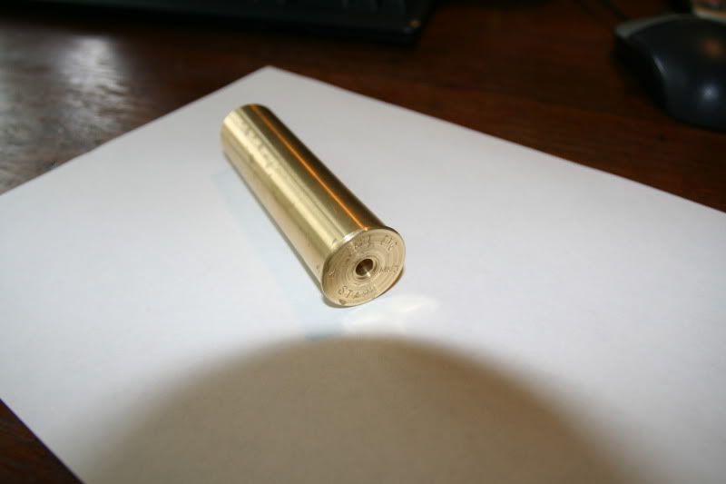

Well, sorry for no updates in a while. We have been real busy at Wild Warbirds and our main company with some major projects.
Wildcat No. 1 is coming along great, lots of work done to the fuselage and now focusing on the wing stubs. They have been torn down and they are replacing skins, ribs webs and what have ya. I promise to get some photos of this very soon. Or at least Conrad can also grab some and post them.

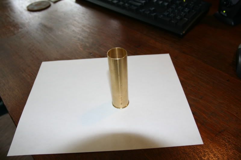

Thought you guys might like to see this. Conrad is planning on having No. 1 with an operational shotgun starter system. He found a gunsmith, or whoever makes custom shells, to make a set of new cartridges for us. These things are beautiful as you can tell below. Can wait to "fire" the first one up. At this point we are not sure how big the load should be so we plan on building up to the correct load to turn the engine over. Anyone out there know what the correct load is?
Here are a couple of shots of the one I managed to take home...
 Post subject: Re: FM-2 Wildcats!
PostPosted: Sun Jun 13, 2010 2:46 pm
Well that'll be interesting! :wink: Is there a patent number available on the Coffman motor data plate?

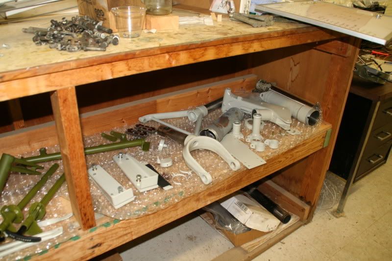

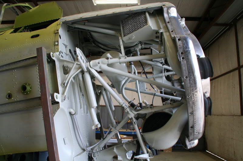

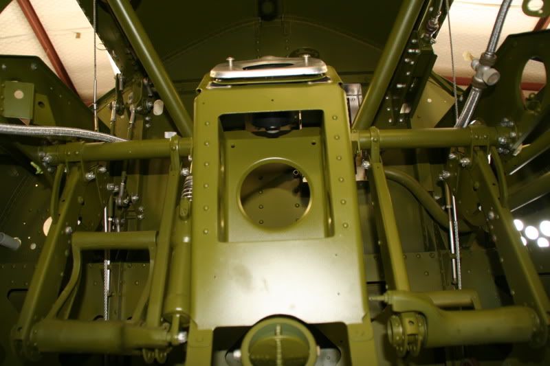

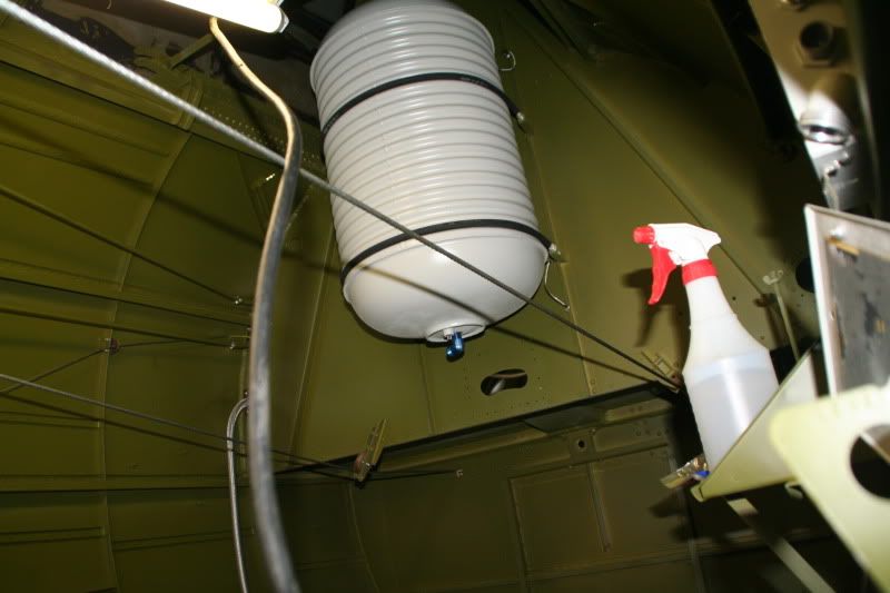

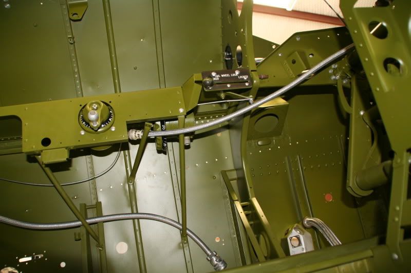

Well, it's been awhile since any meaningful update on our projects.
It is amazing the amount of "little" parts and things that need to be done when you start out with a shell of a fuselage.

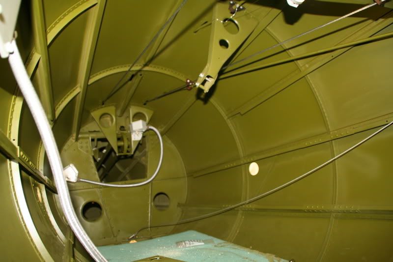

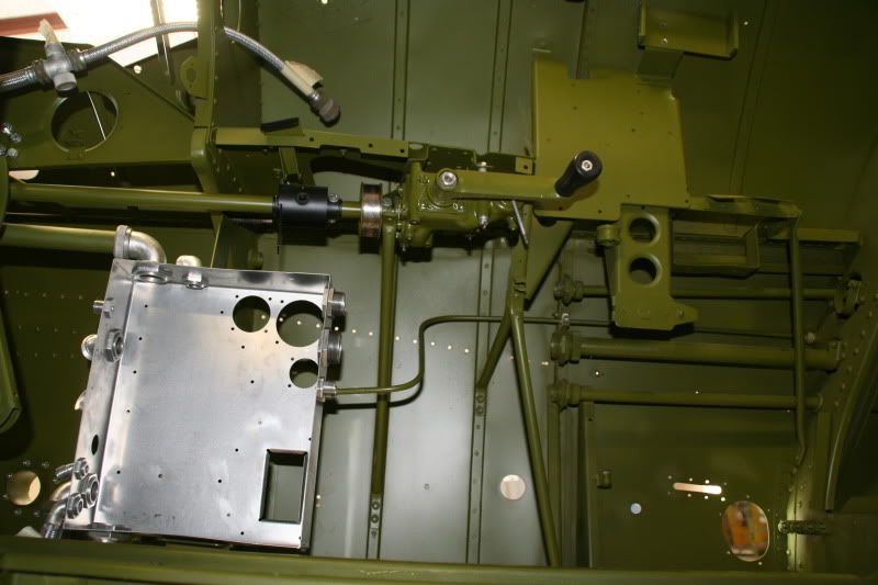

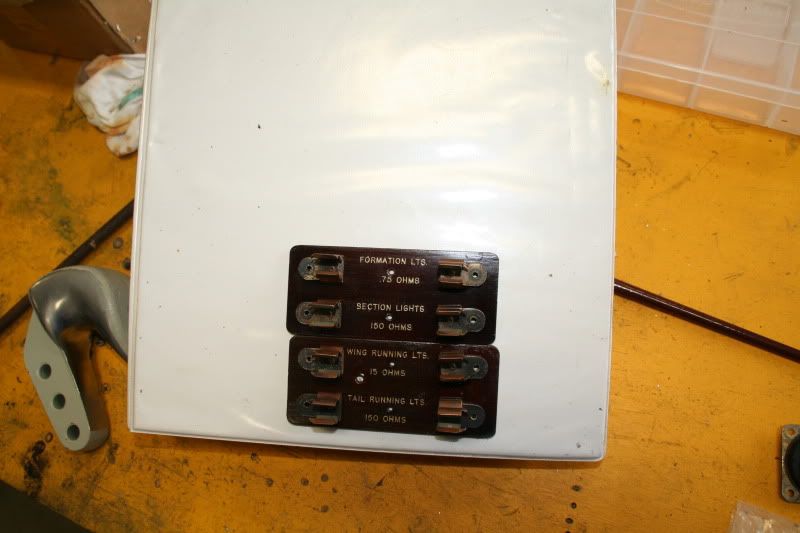

The last few months Conrad and his crew have been designing, copying, manufacturing and rebuilding all the little things that it takes to make a FM-2 go.
As you can see in the next several photos they have been install much of the systems, conduits (thanks Craig for the hook-up!) and cables in the fuselage. Much of this meant making new junction boxes etc. for the electrical system. You really cannot imagine the amount of junction boxes in the fuselage. Many of which look like the same old boxes you find in your home.

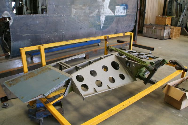

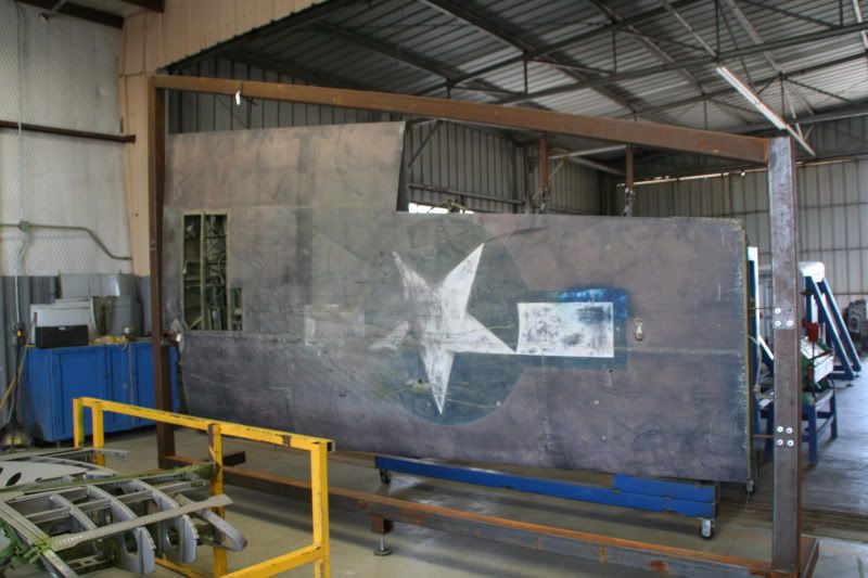

One of the wing stubs being torn down repaired and put back together, the other one is in about the same shape

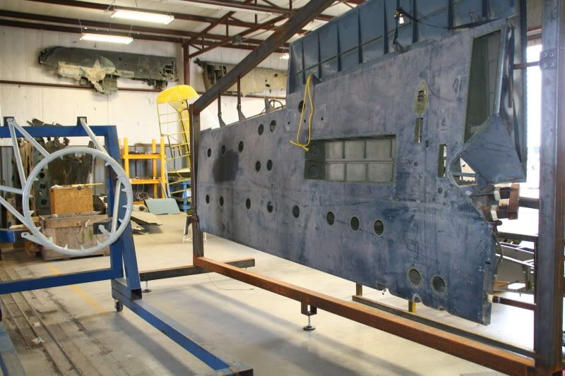

NOS wing getting a tool built around it
Fuse blocks getting a lil work done to them
Misc. parts on the shelf waiting for installation

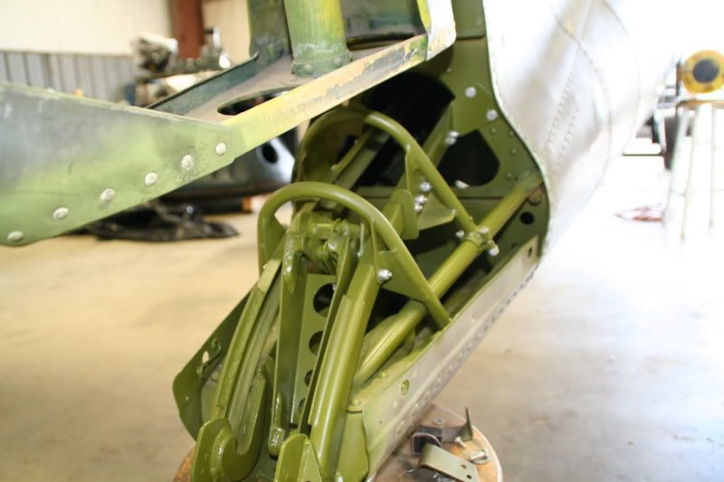

The fuselage and engine QEC area

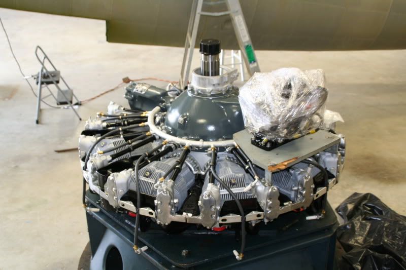

And finally the first engine has arrived!!!!

I know its' neccessary corrosion protection, but did Grumman (or Eastern) bother with it originally?
PostPosted: Mon Jul 19, 2010 6:48 pm
Wow! Beautiful work.
PostPosted: Mon Jul 19, 2010 9:25 pm
Joined: Wed Jul 18, 2007 3:07 pm
Posts: 620
Location: S. Texas
Yes almost everything was primed and a good portion anodized also. All of the fuselage skins are anodized and anywhere there are two dissimilar metals in contact there is a special tape placed in between. But if these things start corroding watch out, it gets into some amazing inter-granular corrosion!
