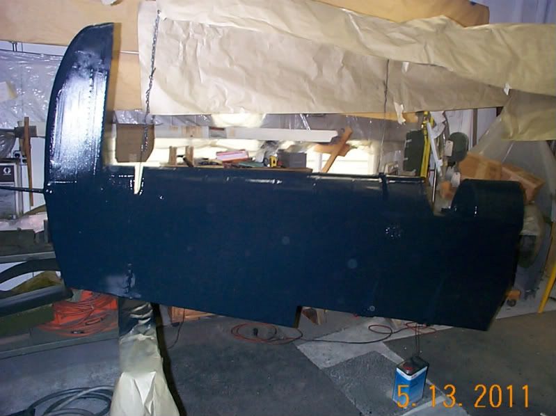

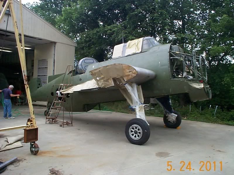

More updates on the CAF National Capitol Squadron can be found here on the shop built forum thread...... I just grabbed a pic or two...... hopefully "Stony Jim" will not mind...... the thread is here
http://www.shopbuiltforum.com/phpbb3/vi ... f=1&t=1439

Is this a different TBM than what's being restored on the Kosko TBM restoration?

Yes, it is the same one.

Thanks John. She's looking good! I'll be in contact with you guys again pretty soon, I've got some real life stuff that's getting in the way of airplane stuff.
