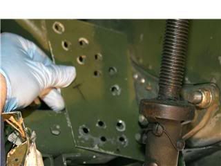

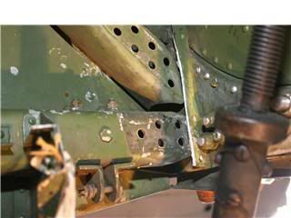

Now that we are making sufficient progress on it (AND I have photos) I can post about one of the recent nightmares.
It seems the Lower Left Wing Attachment bracket in the Bombay had a part bolted up that had some "issues"...
The bracket in question is U-shaped when viewed from above.
But there was substantial corrosssion "hiding" under a band-aid.
Once we removed the band-aid some cracking was revealed.
We are currently having the original part tested to determine the alloy and the heat treating. The Boeing Drawings have the 1945 Specs, but the heat treating code is different than what our fine folks are used to seeing in the "Modern World".
The first pic shows the band-aid being held up to the risers. The second pictures shows where the "ear" or the original plate was removed and had the band-aid placed atop it.
(For you afficianados, that is the front bomb-bay jack-screw in the photo.)
Oh the joys of 63 year old airplanes!
The end result is that a new part is being manufactured and will be heat treated to spec and our wing will be happy!

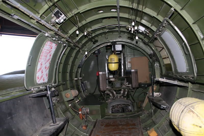

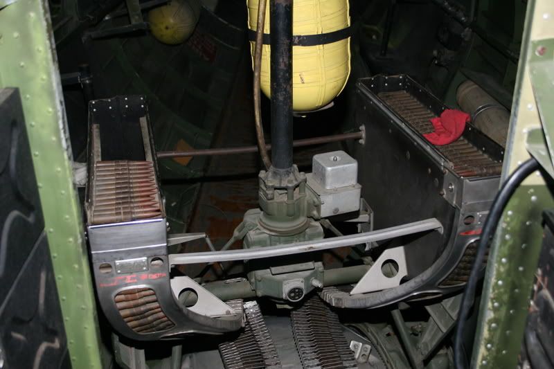

Here are a couple of BIG pictures of the Waist Gunner's position and the Ball Turret. We have not begun serious work in those sections, but I figured why not show some BEFORE pictures!
