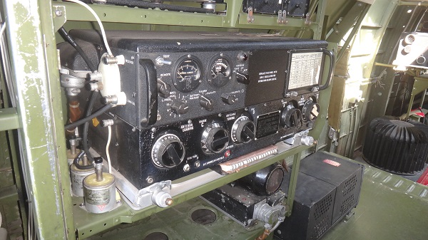

A few more radio goodies are finding their way back where they belong.

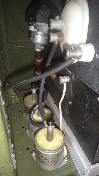

Mark came up with the antenna capacitor for the ART-13. These capacitors normally come on a mounting plate where they are arranged in a triangle pattern. I couldn't find a set of holes where the plate would fit as there was no room between the transmitter and the bulkhead where they were supposed to mount. Mark solved the mystery by taking them off of the plate and sure enough the three capacitors fit individually and the mounting holes lined up perfectly.
The antenna system was originally wired up with Packard high tension wire so we found the same stuff and began wiring up the long wire antennas.

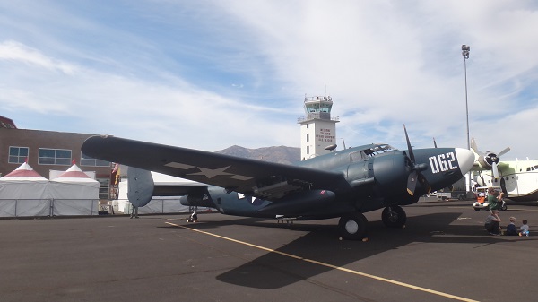

Bill and I flew the PV-2 up to Reno alone. We couldn't get anyone to come along probably because we were going up on a Tuesday. I hate flying with empty seats.

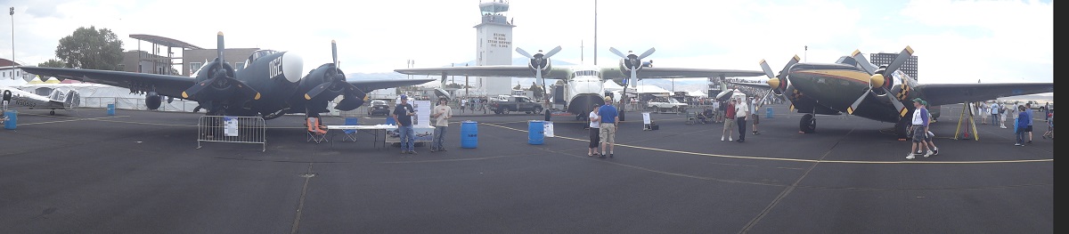

After a slight bump we were positioned along the back next to a beautiful Grumman G111. The idea was to set up the PV-2, G111 and the howard 500 as a backdrop for the awards ceremony on Sunday. What an honor.
We had a lot of people come through the harpoon and a few celebrities too.

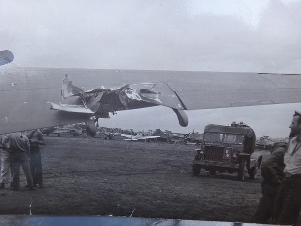

Here is a shot of the damaged right wing of his PV-1

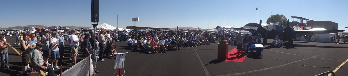

The awards for the National Aviation Heritage Invitational program was set up in front of the harpoon on Sunday. Howard had a front row seat right next to the VIP seating section. I think he enjoyed it.
As you can see Matt Walker and John Sessions are more than tickled by our PV-2! Matt was the winner of the overall grand Champion award for his outstanding Beech D-18S and John was the winner of the Military award for his beautiful Spitfire. Well done guys!

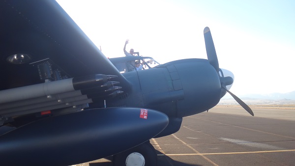

After a great safe race week we were ready to head home. We had a special copilot for the flight to Stockton. Here is Howard and his son Brian all ready to fire up and go.
That isn't a peace symbol Howard is holding up. Its the original V for victory. Old school baby!

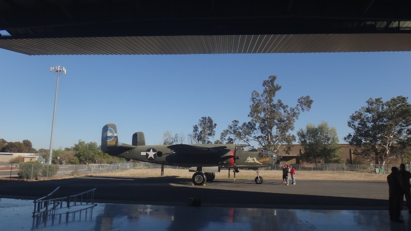

We were supposed to go to the California Capitol air show at the old Mather Field in Sacramento last weekend but they called a week before and said that they didn't have the fuel for us so we were cancelled. Probably a good thing too as the show folks backed out on what they promised many of the participants that went. Lots of Warbird folks were shorted their fuel allotment and there were many unhappy campers.
I flew the Collings B-25J Tondelayo to Mather for the Jimmy Doolittle Museum and we were lucky that we received what was promised for fuel. It seemed like a good turnout. lots of people attending.
I am glad that we didn't go in the Harpoon as the museum certainly couldn't have afforded to have been shorted or stiffed on fuel after flying up there. We were also sad that we had a PV vet meeting us there and no PV for him to hang out with.

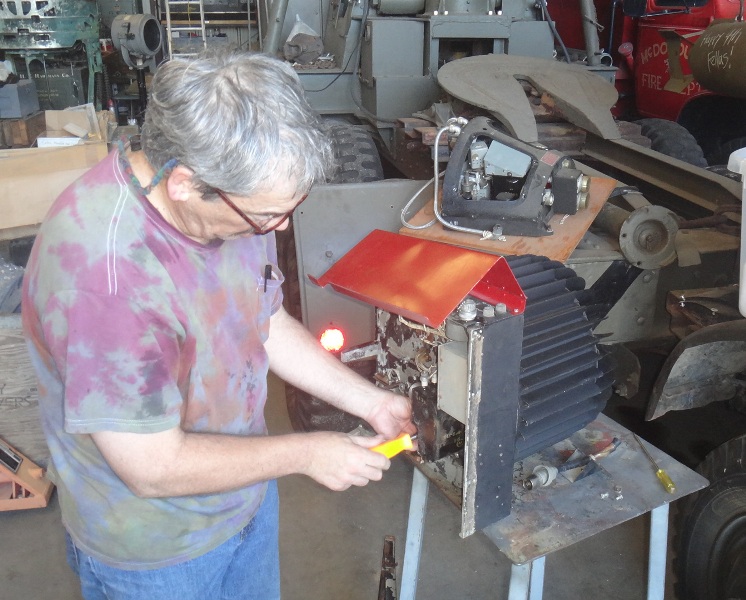

Jon and I pulled the modulator out of the Harpoon and hefted the beast in to the museum hangar. We turned it on its side and removed the bottom cover to check out the belly of the beast. Flaking paint from the Arizona sun and some crustiness but not that bad. The wiring is still good and it is basically unmolested.
A lot of the fun in playing with this gear is digging in and figuring out how it works. Here is Jon beginning that process. What is under the dome with the cooling fins anyway? Pulling off the...adapter thingy... to look inside didn't help much. It turns out that was thought of as a cut wiring harness was just a cut feed line from the modulator to the transmitter. The cool thing was the connector was on one end that is quite unusual and hard to find. The first of many connectors needed to make it all work.
Time to see whats under the dome. We really had no idea of what was under there and what condition was it in. This was a pressurized chamber presumably to reduce arcing or flash over in the thin atmosphere at altitude. The fact that it was supposed to be a sealed unit should help to preserve the parts unless it had moisture in it then the water would be trapped which would tend to support and propagate the corrosion.

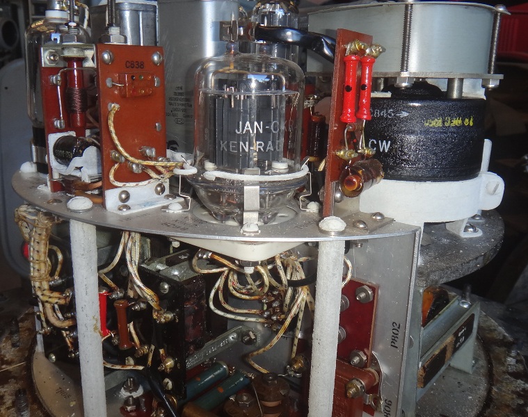

Oh, my. Wow!
So it was probably pulled out of a Harpoon in 1958 and has been sitting outside in the Arizona sun since then. I'm guessing it was at Pima for 5 to 10 years before it was given to me around 1978 or so where I put inside. To be in such good shape after all that time is astounding.
This is a work of art in my book. Electronic geeks unite!
One interesting thing was this lever on the side of a rather large capacitor. The spring loaded lever would move if the cover was removed and would short out the electrodes of the capacitor thus preventing an unsuspecting tech from being on the receiving end of 15,000 volts at quite an ampere rating. I wonder how many got zapped before this little safety device was installed?
More cool electronic art history

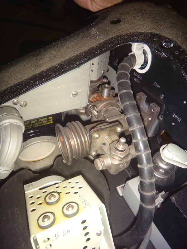

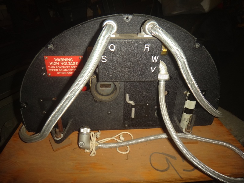

Here is the APS-3 transmitter. This transmitter takes the industrial strength magical electrical wizardry that the above mentioned modulator puts out and it converts it to X band radiated energy that heads out through the antenna.
How cool to have found a transmitter that is new and still mounted on its shipping board. Inside and out is about as nice as it was when it was made. it should be a runner

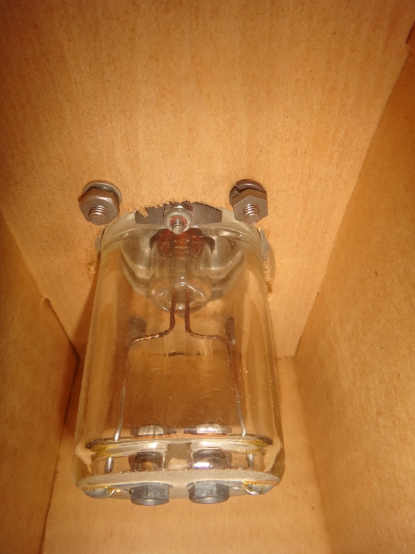

Okay I usually get these mixed up. I pretty sure its the thyratron tube... but it could be the magnetron...
This is the tube that goes in the heart of the transmitter where the energy changes form and heads off through the waveguide to the antenna.
How is that for a beyond simplistic explanation from a guy who is electronically challenged.
The tube came in its shipping box and looks nice
Here is where the tube mounts. It would have been shipped separately to prevent damage of the delicate part.
