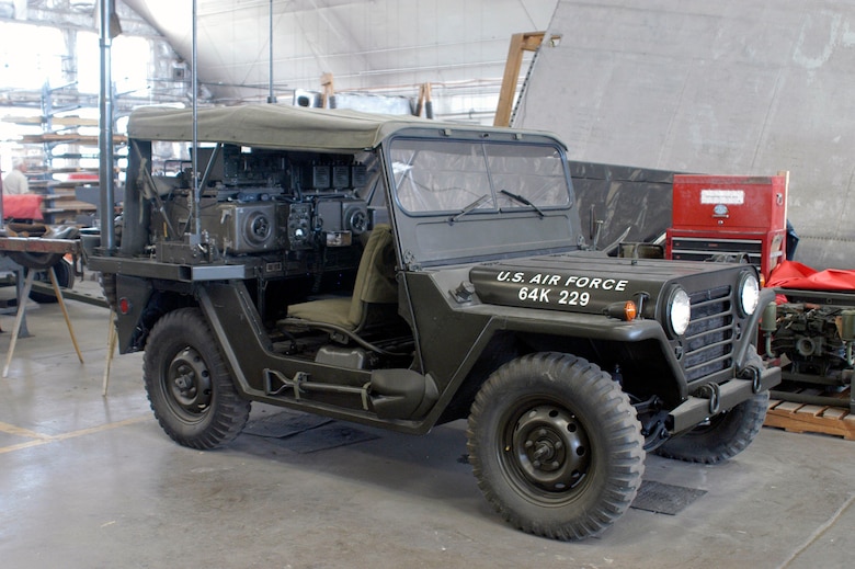

From what I can see is the color is listed as dark blue. Different manufacturers would have different variations of dark blue. Vehicle codes in the AF follow a certain protocol. Our vehicle when I was in Germany was 90B20. It was a 1990 Mercedes Multi-Stop panel van. I can't find an A code listed, unless it's in an older tech order, or the person doing the markings was mistaken, as the K code makes sense in the illustration.

Here's a NMUSAF Jeep display, with the K code. Look at the Jeep in the snow from the USAF SP site it's A coded, first link, second link is a Google search with various USAF Jeeps, third link has another A coded Jeep.
