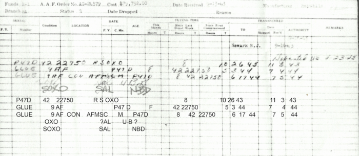

Well good to their word the helpful folk at AFHRA have ensured an early Christmas present arrived this morning. Its reasonably clear but (as expected) written in the USAF code. A screenshot is attached.
I have zoomed right in and taken a closer look to verify the text, and have appended the plain text below the handwritten lines.
Can anyone help with deciphering/translating the codes for us?

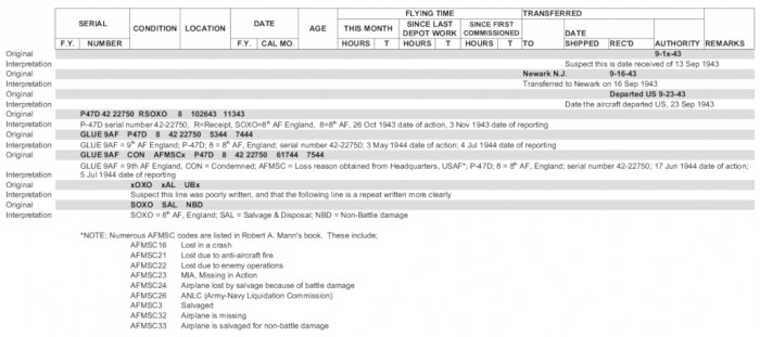

Best attempt at deciphering the record card. Date of loss of aircraft likely 17 Jun 1944 (or at least date deemed condemned) .

jdeters79 wrote:
Thank you so much for this - much appreciated.
The conclusion? This record card and serial number is not related or linked in any way to the crash site we are investigating. Either way, its progress though.
Back to square one!
