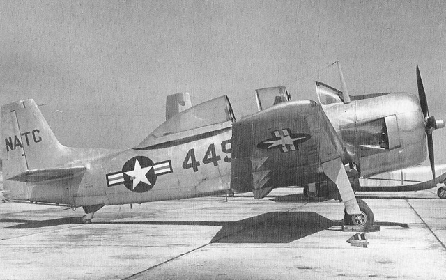

T-28's looked like a good aircraft to train with on carriers.
Overhead view of the aircraft carrier Lexington (CVT 16) underway with T-28 Trojans being spotted on her flight deck, circa 1963.
A T-28 Trojan assigned to Naval Air Test Center (NATC) Patuxent River, Maryland, prepares to launch from the flight deck of the carrier Tarawa (CVA 40) 1955
