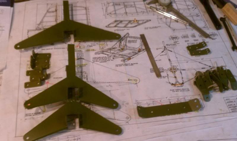

The project continues. Fun when your saw kerf is as narrow as your scribe line. :wink:

.010" jewelers saw on 4130! Yahoo! If you ask the experts, can't be done. Glad I am not an expert. 8)

Tail feather bits done. Redid the hinges four time until I liked what I had. My friend wanted to use AN bolt all the way around but you have to "engineer" a bit to get them to be usable. Original dimensions don't allow for actual assembly clearances. But issues resolved, they came out nice.
PostPosted: Tue Feb 14, 2012 10:01 pm
Don't forget a thin washer under the head and a standard one under the nut to prevent galling-your work looks impecable!! :D
