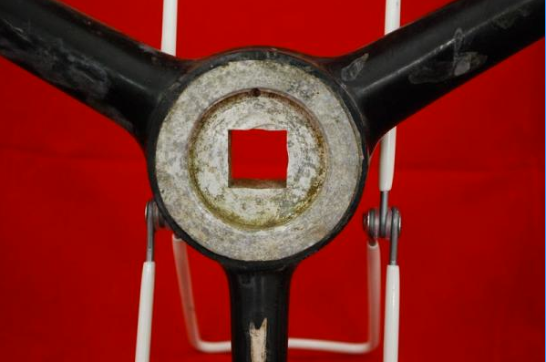

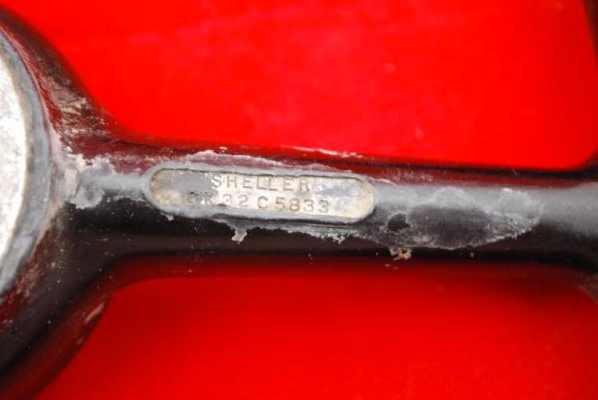

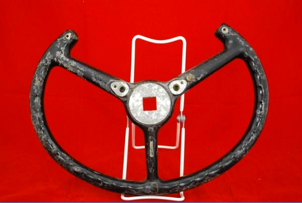

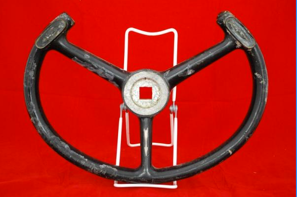

This is probably more of a "clean-up" than restoration, but anyway...
Recently acquired control wheel (eBay) after years of looking. However, it needs a little TCL before going on display. Appears to have white hard water marks and general grime on surfaces. I'm assuming wheel is made of a black bakelite material? Can I clean this surface with a vinegar/water solution? Also, what should I use to clean up metal surfaces?
Wheel is marked on back "SHELLER CK32C5833."
PostPosted: Sun Nov 28, 2010 9:46 pm
a good douche w/ a vinegar & water mixture & a soft to mild abrasive brush a number of times w/ good rinses in warm tap water will help plenty, dry thoroughly. it works, but results vary. that technique has never failed me regarding mildew, fungus etc on bakelite i.d. models, old canvas, & leather etc. do not use any solvent based material or bleach as this may toast your new find. a marine grade aluminum cleaner / polish will help the hub hole w/ an old tooth brush. clean off thoroughly & let dry. a good quantity of q tip swabs is good for applying the cleaner & rinsing / drying & will get in between the teeth of the hub. wipe off any cleaner from bakelite quickly, or mask off around the metal areas w/ masking tape. let me know how you do!!

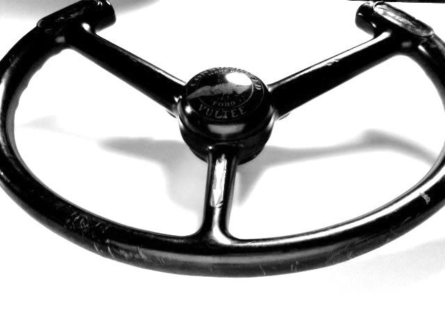

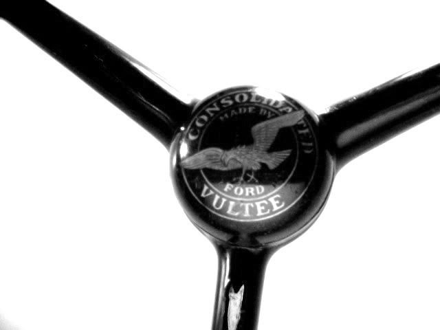

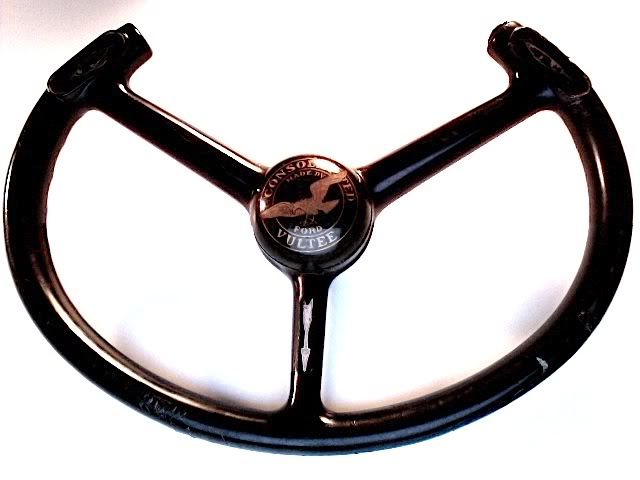

Tom, your recipe worked like a charm... Django, below are pics of the cleaned up wheel with a vintage cap...
PostPosted: Thu Dec 02, 2010 9:43 pm
excellent results!! congrats!!!! looks like it got a great botox treatment!!! you've got a great keeper!! best, tom

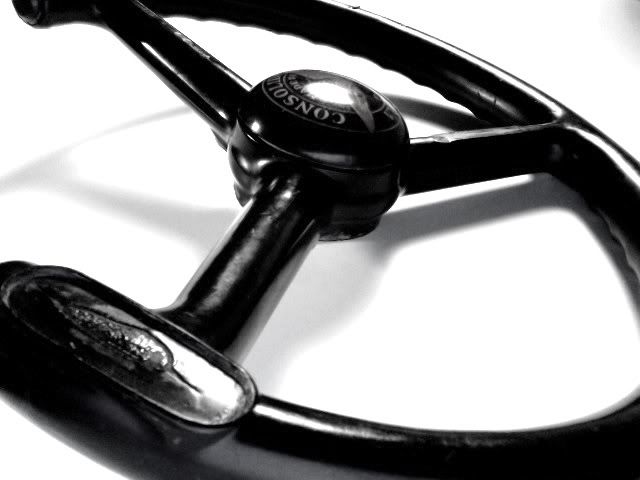

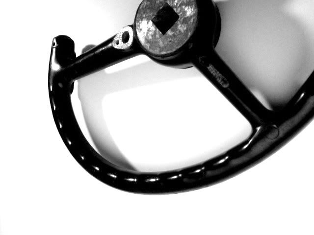

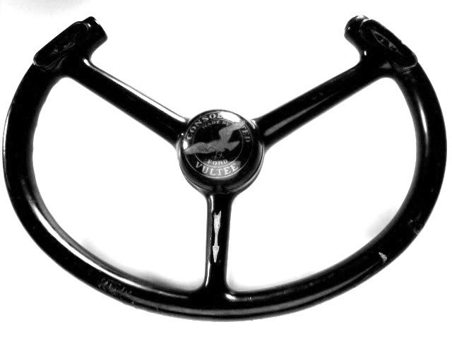

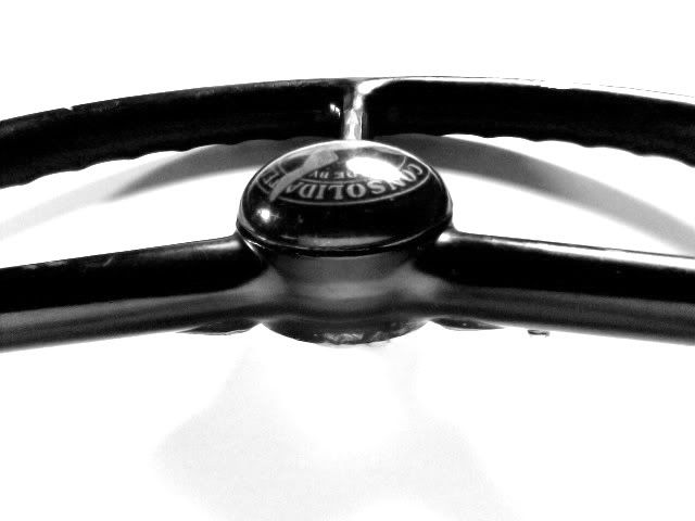

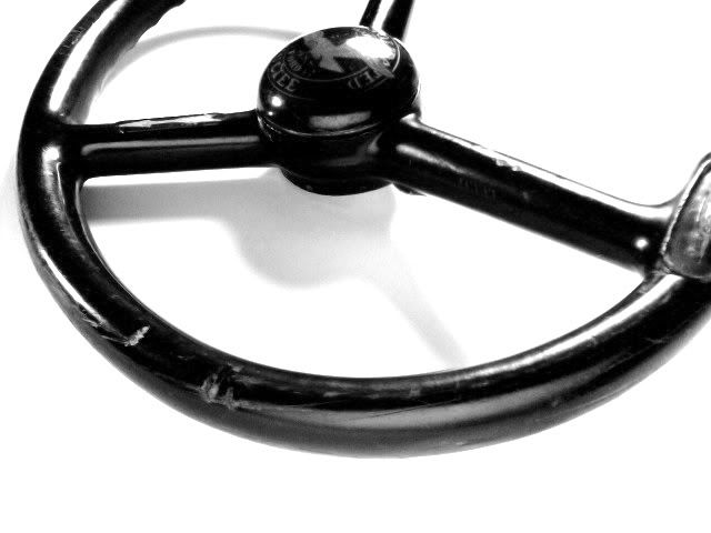

Wow. Thanks for all the great comments. I actually used used an electric toothbrush along with Tom's hints. Worked surprisingly well.
Here are a few more pics:
