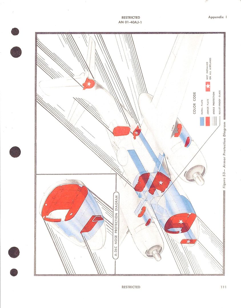

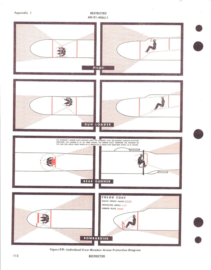

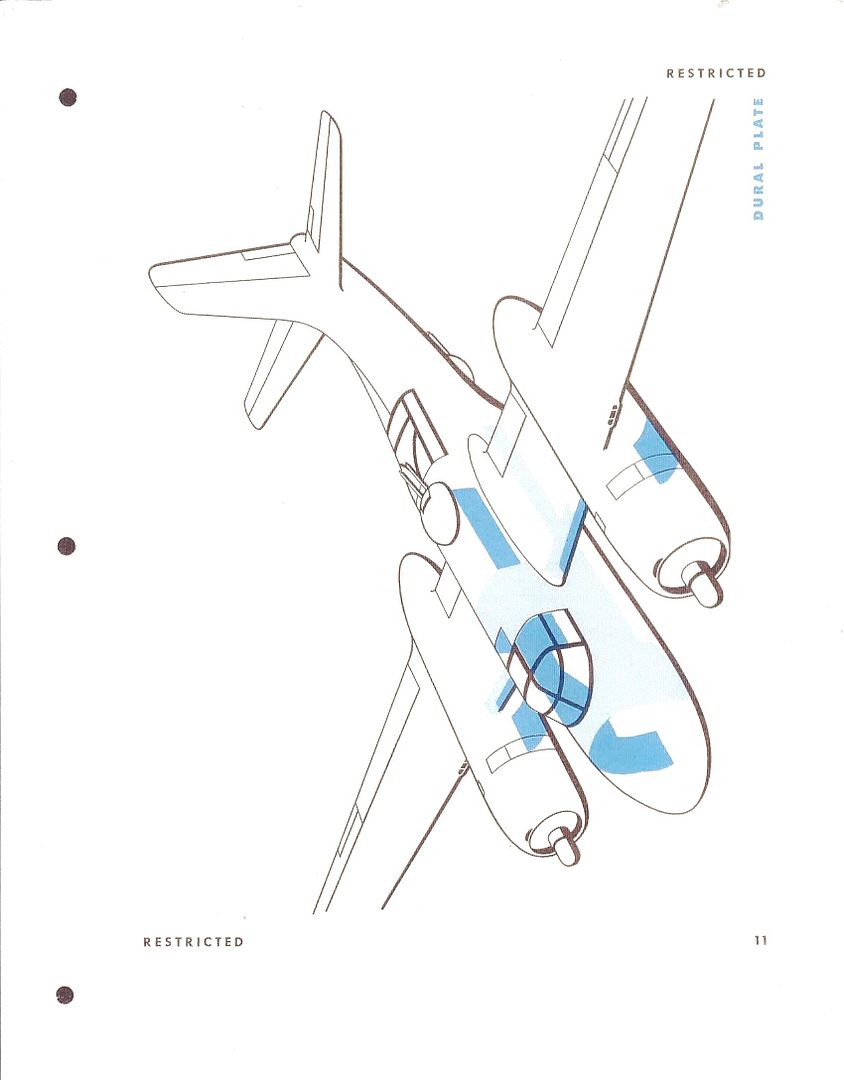

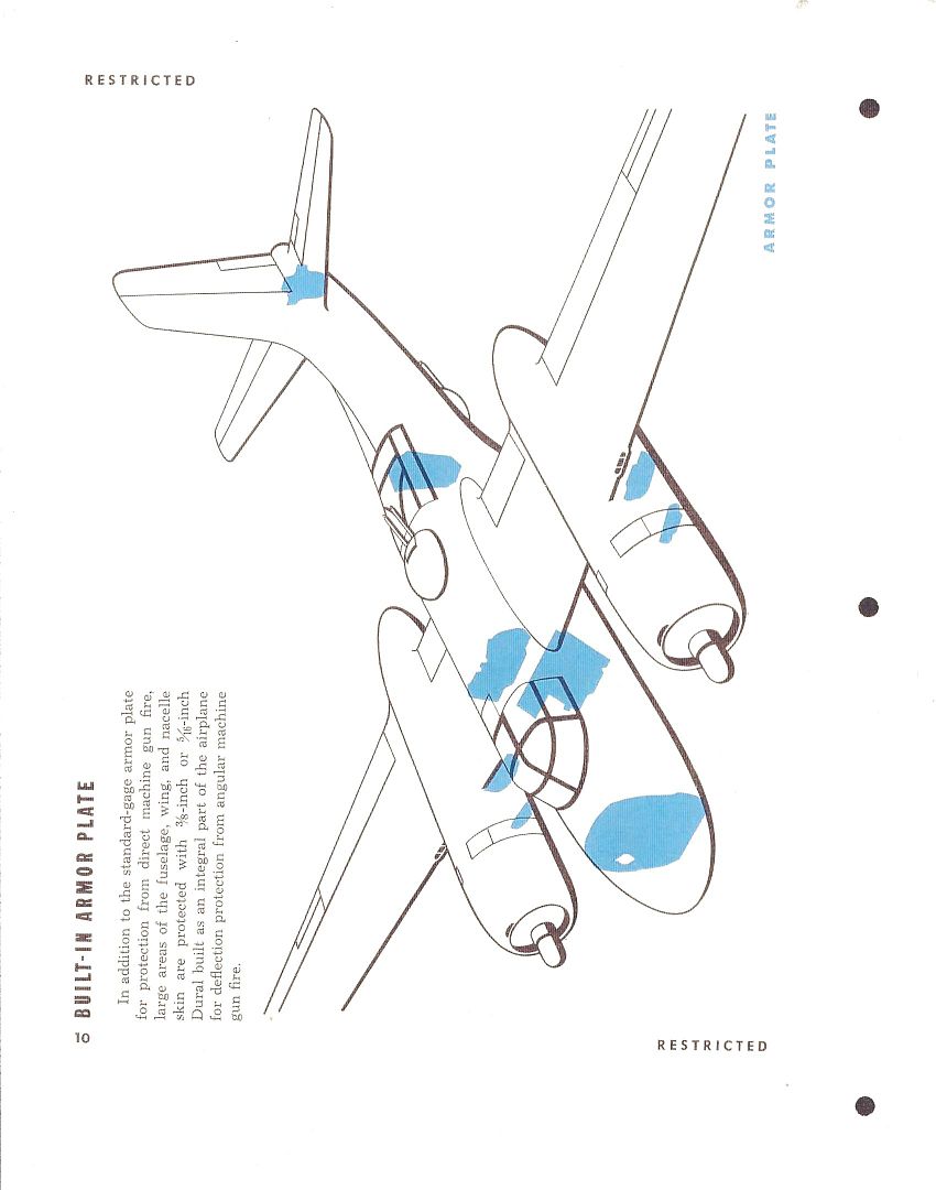

I found these following pages in a couple of World War II vintage A-26 flight manuals.I checked my Viet Nam era A-26A flight manual,but I couldn't find anything in it concerning armor plate.I don't know why these pages post in such a large format.Something must have changed at Photobucket.The pages do post smaller when they have been rotated.Go figure...I hope that this will be of some use.I tried posting the rotated pages as well,but something seems to be preventing them from showing up here.Actually,some odd things are happening with multiple pages appearing and disappearing.Sorry about whatever might happen here.

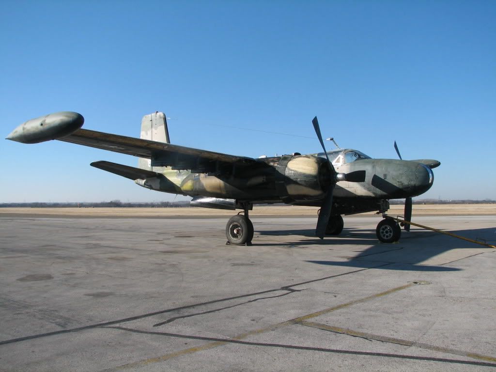

Here are some pictures of the B-26K model here at the Vintage Flying Museum after the paint was stripped. You can easily see the original armor plating sorry for the poor quality, all I had that day was my Crackberry.
Before being stripped
Bill Gorin
