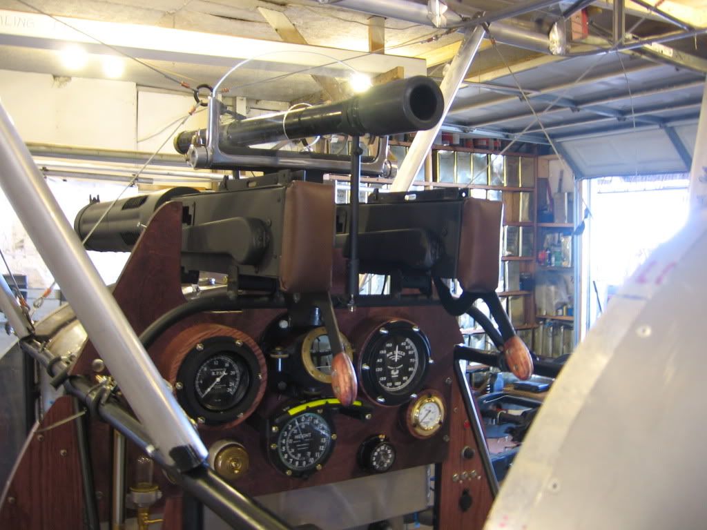

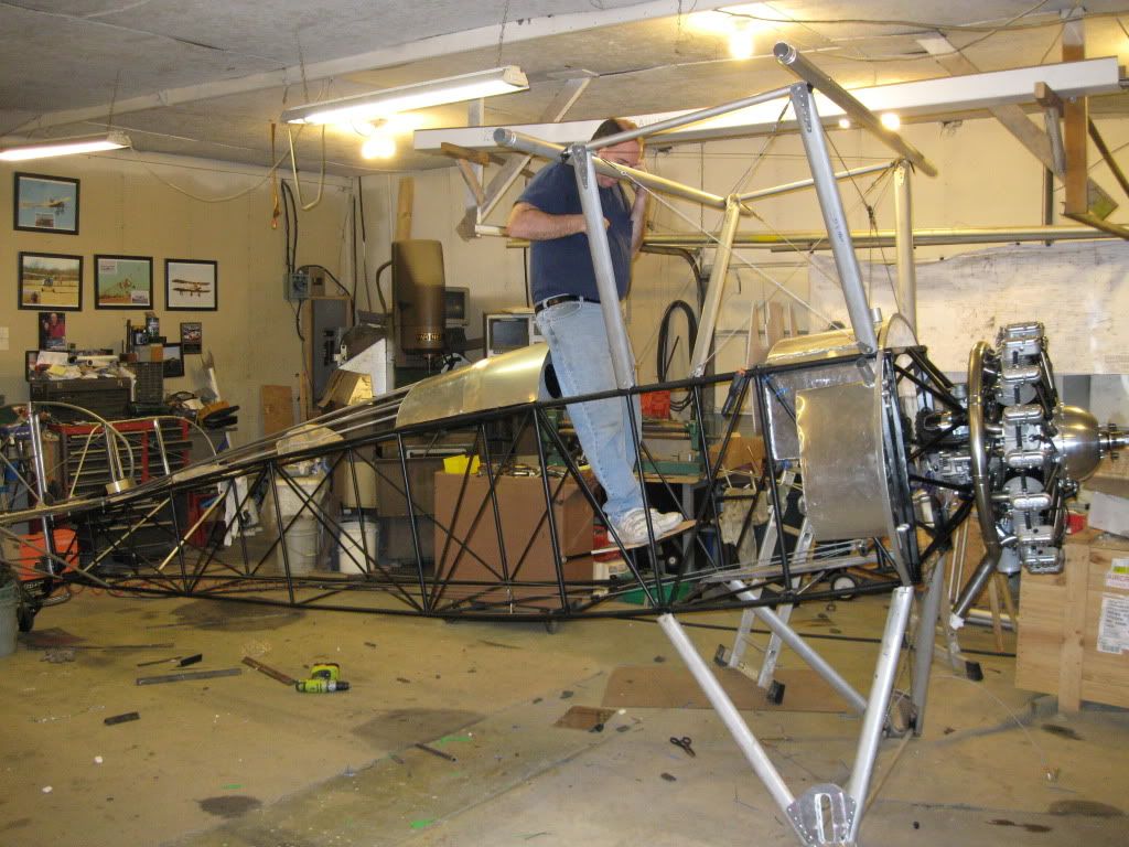

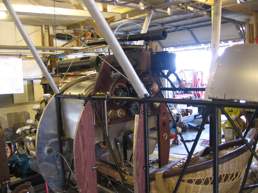

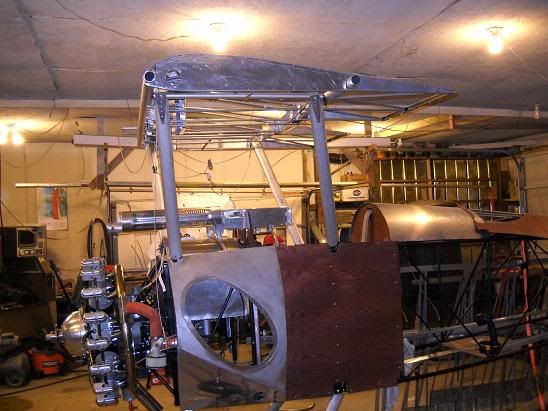

While I know most of this venue is geared toward WW2, thought I would share a couple of photos of my replica Camel project. The objective here is to safely re-create the WW1 flying experience in a reasonable cost aircraft compatable with modern flying concerns. While all original full size dimensions and requirements (e.g. flying wires) are followed, modern safety items like a steel tube fuselage is used. That said, the project has many original instruments and parts from original Camels, including an original Aldis gunsight, flight instruments andan original Camel data plate. Many replica items such as a wicker seat, stick grip, throttle quadrant, etc, are taken from original drawings/photos/plans. A small Rotec 150 hp radial engine supplants the original 130 hp Clerget rotary for reliability and XC capability.
Now finishing covering - hope to fly in the Spring and see everyone at OSH. The plane will be done as a 208 Sqn B flight plane, D1845, "C".

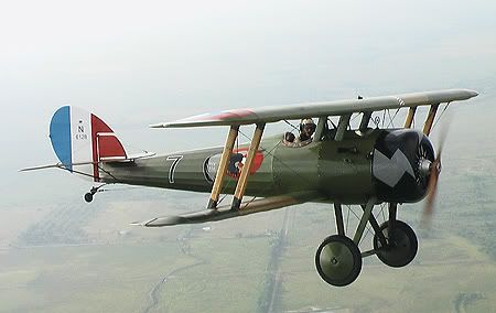

One of the fun things is doing things in groups. Blake Thomas, a retired F-15 sqn commander , has an Airdrome full scale Nieuport 28 down the road in Katy, and am looking forward to some formation. There is also a full size Sopwith Pup and another Nieuport nearing completion in Houston, so we may have quite a group.
Here's Blake flying the Nieuport, which was featured in a recent edition of 'Classic Wings' magazine:
We do need some wiley Huns in Triplanes and D-7s to complete the set though... anyone in Texas interested? These things are -fun, not very expensive and very frugal to run...

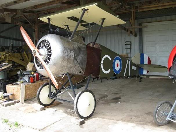

Starting to look like a Camel.
Will hang the wings and schedule the FAA inspection.
