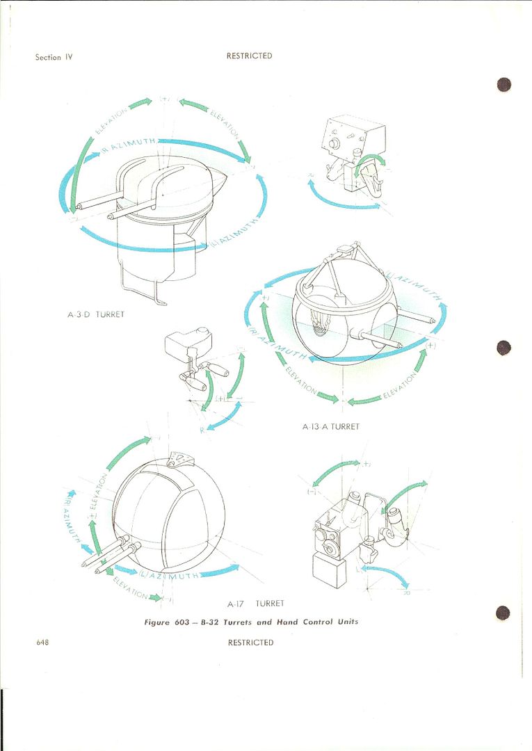

What's the relationship of this controller to the part with the 32FXXX number next to it in the box?
If they're attached, or came from the same aircraft, this may even further the mystery. If I read the p/n correctly on the "green thing" that piece is B-24 Liberator, as the "32" was a Lib number and "F" indicated "fixed equipment" as having something to do wih an internal airframe bracket.
But it is not a controller I've ever seen in the Lib - not Martin upper, not Consolidated or MPC or Southeastern or Erco nose/tail or Briggs or Sperry ball.
The a/c contract is indeed for Air Corps and the AN stamp acceptable for Army or Navy contracts...
I'd throw out a possibility of B-32 Dominator. Look at the B-32 turret thread in this section - it's missing a controller. Look at the three mounting bolt holes on the turret post where the controller sat - and then the back end of "your" piece. The cropped photo only shows one bolt hole - if'n there's three, you may have found the suspect. I have a feeling this is it.

B-32 sounds pretty good, Pooner. I didn't even think about that turret style. It also makes sense since the Convair plant is just down the road.

JMC,
I found a page in the B-32 mainterance manual that shows the turrets and their contollers.The control unit fot the A-17 turret looks a lot like the item in your pictures.I haven't found any useful pictures of the inside of the turret so far,but I'll keep looking.
LK

I hadn't even thought about the B-32. Shame on me, since I am the one that most recently posted pictures of the B-32 turret under rebuild down at Lancaster.

Posts: 3418
That control unit may be the one that was separated from the DFW Wing/CAF B-32 turret prior to being donated. Maybe Charlie and the DFW wing can work out a deal and complete the turret with that unit if it is indeed the correct item?
