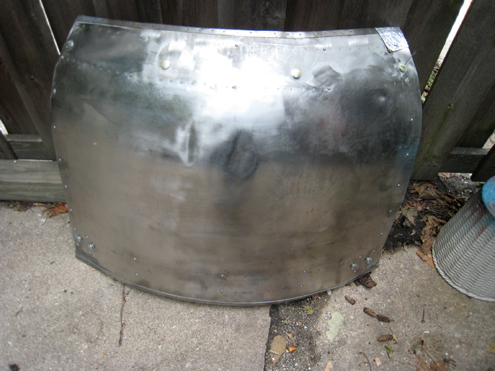

Here's a pic. It's kinda hard to see, but this thing looks like galvanized sheet metal in appearance. There are some organically shaped raised areas too, like it had corrosion maybe? Are all panels like this when you try to polish them?

You have a bigger problem then using a wheel or a strong grit, that aluminum has ALCLAD on it and it DOESN"t polish worth a darn. Trust me, having a majority polished P-51 and working on it 2 hours a day 7 days a week I'm here to tell you that the alclad in the part (when it was put on) went on and interlocked, for the lack of words, with the metal. Your best bet is a cloth polishing wheel with Nuvite C grit, use that till the product dissappears then hit it with whatever you are using as a final polish.
