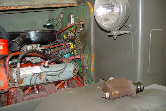

The Clarktor MILL-50 project has me motivated to fix another tug at Creve Coeur Airport but I need some help. Our museum has this American Coleman beast but it has a brake master cylinder problem along with a few other issues. The brake problem has it parked because it's really hard to tow a/c with a tug that has no brakes. Anyone know where to find manuals or parts for this thing? Thanks in advance for any and all help.

I'd try taking the master cylinder down to the auto parts store and see if they can match it up. A lot of those type components are commercial off the shelf units.
Have you tried Googling the model number or manufacturer name?

Good advice from Skymstr. I'd advise going to an "old school" parts store like the local NAPA or similar, if any survive in your area. Advance, Western, and Auto zone on occasion have competent parts guys but mostly they have young kids whose response to odd things is "Not in the computer, sorry" Also if you have any farm tractor shops in the area they may be helpful as well.
That master cylinder looks like a 60's Ford F600 or similar big truck, so that may be a place to start. Any numbers or mfr name on the cylinder?

You might also go to the local junk yard and find something similar in out-put size (piston diameter) and make it work.

Thanks for the input. I talked to the person who did some work on this tug two years ago and it turns out, he gave up for lack of manuals. He was able to locate a master cylinder overhaul kit but he had problems bleeding the brakes. It's got a large booster on the brake system and that may be part of the problem. I'll need to find some manuals for this thing before we can move forward. I found some paperwork in the cab that talks about emergency procudures for dealing with a Hydrazine leak. :shock: I wonder what this thing tugged?

AHA. Is the booster, perchance, mounted remote from the brake master cylinder? And is it a vacuum booster? If so, then it's probably a Furd med duty truck system. And they are a stone, redheaded, pain in the hiney to bleed. Ya pretty much have to "back bleed" em from the wheel cylinders back, with a pressure bleeder.

Thanks Jase, the first website link worked just great. For just $9.95 for thirty days, I'm allowed to download up to ten pdf manuals per day. They have a manual for the Chrysler six cylinder version of this tug but other than ours having a Chrysler V-8, it looks to be the same tug. No doubt, while laying on my back under this pig, I spotted that redheaded pain in the hiney of a brake booster. The good news is we do have a pressure pot brake bleeder or two that we got from the same outfit that sold us this tug.

Found this explanation of the Hydrovac system on another board: Trucks which were not equipped with air brakes used them for years, and still do. What happens is that the first 30% of the brake line pressure (it could be 40%....the exact number escapes me) is used to pressurize the wheel cylinders. When brake line pressure exceeds that figure, then a vacuum valve is lifted which causes the cavity behind the diaphram in the booster to exhaust, and allows atmospheric pressure to push it forward, and at that point, the BOOSTER is pushing the fluid; all the pedal is doing is modulating the vacuum. Since the booster operates on the SUSPENDED VACUUM PRINCIPLE, they are very quick-acting and a superb unit for the job. Actually, in the "early days" ........like the mid fifties......Cadillacs used them for power brakes, and since they were conveniently mounted atop the LF upper control arm bolts, farm kids like me would scour the wrecking yards for them and put power brakes on everything from our '48 Dodge pickup to little 1-ton flatbeds. MIDLAND is my favorite booster, found on Ford and Dodge trucks, and BENDIX was another one that GM trucks used quite a bit. The little Caddy units were all Midlands if I'm not mistaken.
