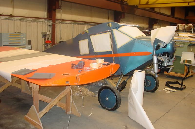

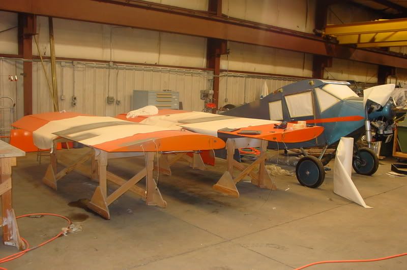

Alright, so it sounds like the best idea, based on bdk's suggestion, would be to feather the stripe edges gently, spray a few coats of dope, and follow with a color top coat and then maybe a clear top coat?
Below are a couple of photos of the aircraft, which is a Star Cavalier. Also pictured is the probable paint scheme. We are here in Tulsa, just 45 miles from Bartlesville, where the Star aircraft were built.
Keep the advice coming! It's great to learn new stuff.
