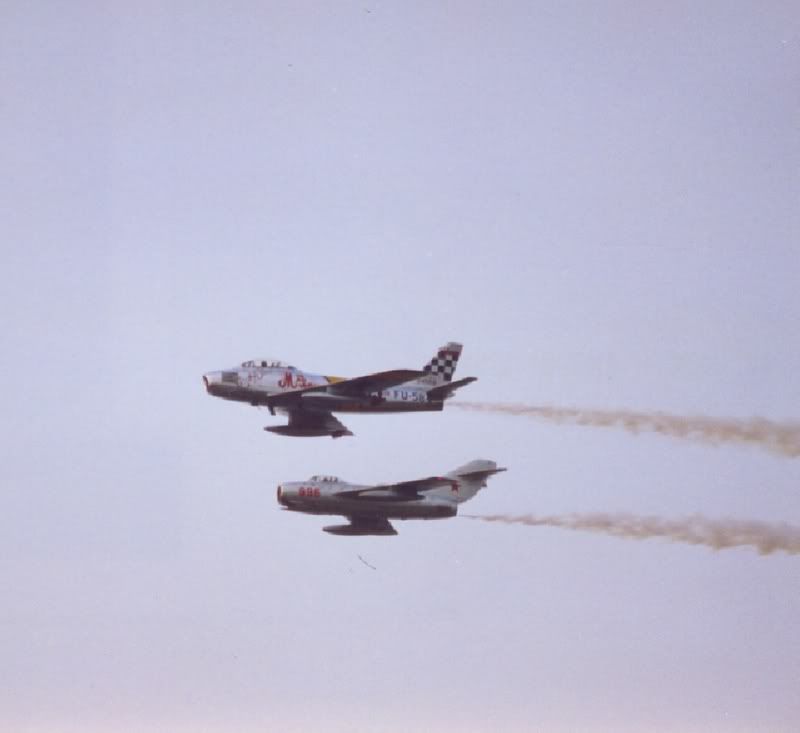

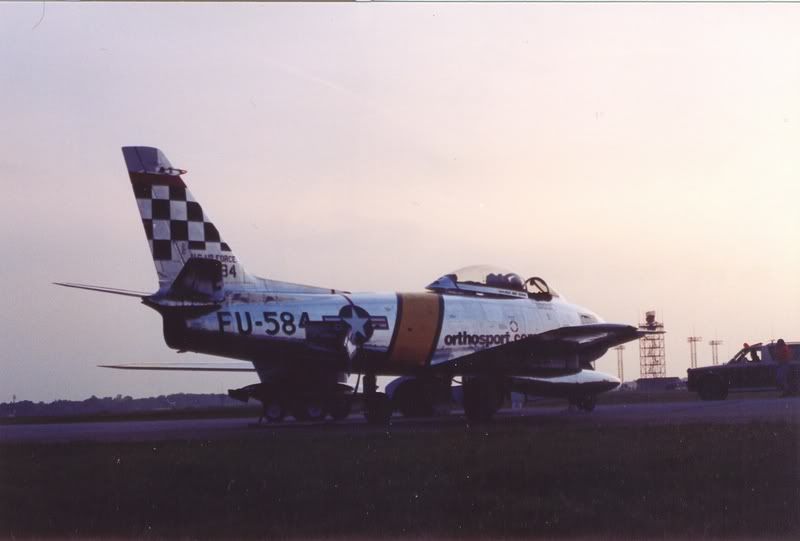

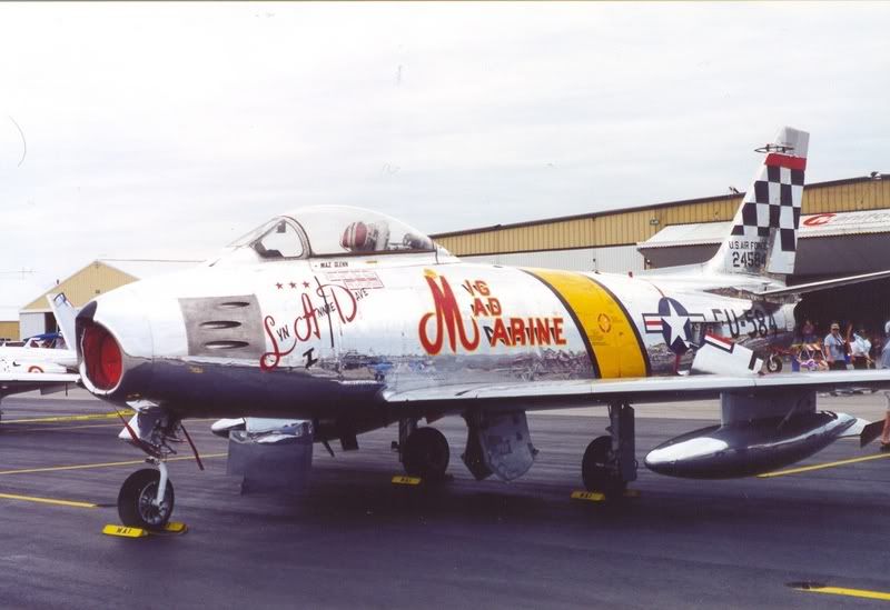

I am going thru my pictures getting more organized and found these of the F86 back when Mike Keenum still owned it.

Thanks for those pictures. It's one sleek looking machine on the ground and in the air. It's hard to choose my favorite between the T2 Buckeye and Sabre. Love the looks of the Sabre, but the T2 is so much more maintenance friendly.
