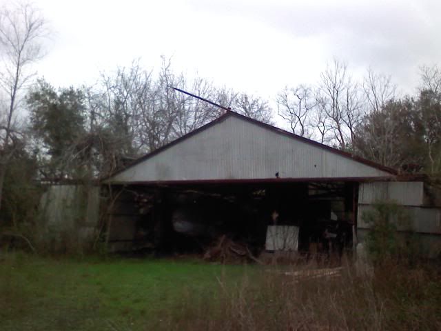

A friend of mine lives on the remains of a WWI era training filed. There is one old run down pre-WWII hanger on the property that his family used to fly Stearman crop dusters out of. He was generous enough to let me move the Lodestar there to keep it out of the weather. The roof leaks pretty bad, but it is better than nothing.

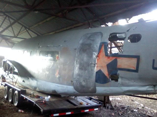

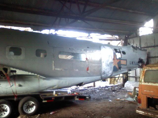

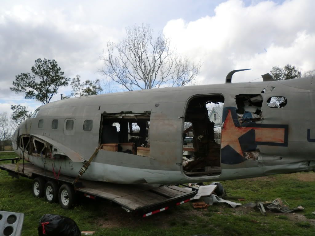

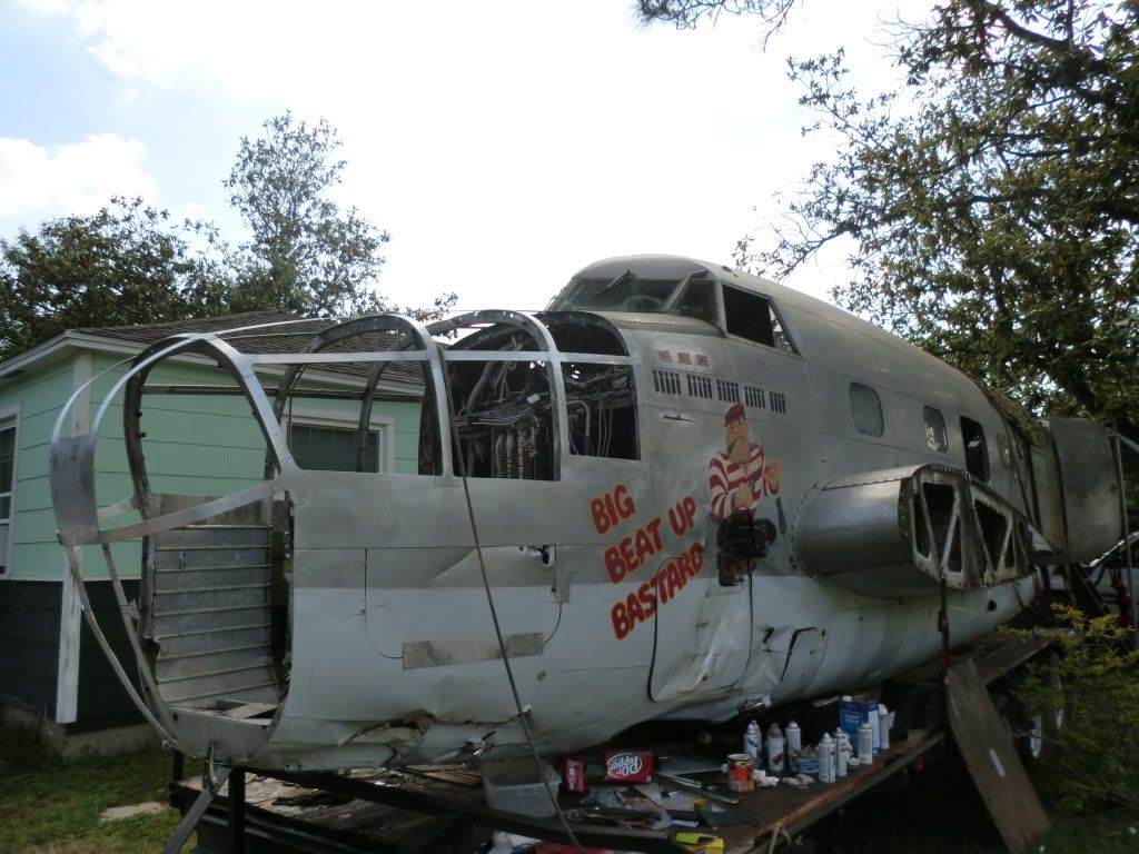

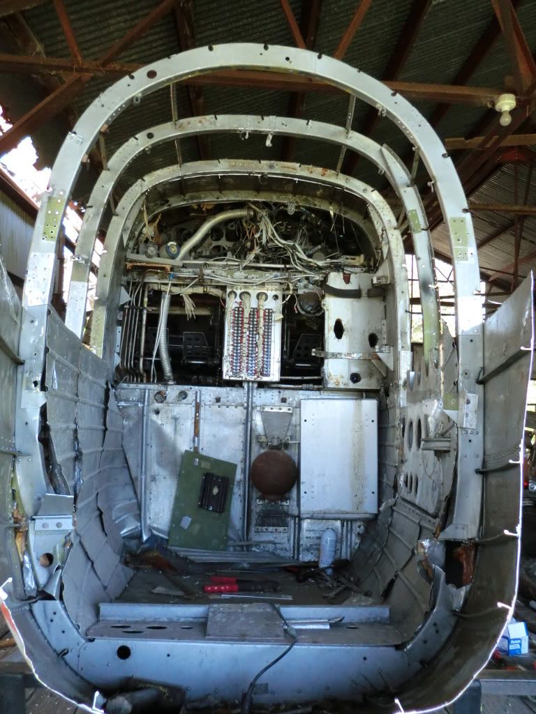

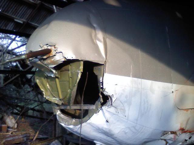

I installed a rear door on the fuselage today and did a crummy patch on the left side where the fire department had installed a large picture window with a cut off saw. I don't think they used a square or a level. Luckily that piece was intact enough to reinstall it. It needs to be patched properly if y'all know of anyone willing to help. I got in the nose and removed a lot of junk modern radio equipment and shelves. That allowed me to partially knock out a huge dent in the nose area. I also cut off some jagged aluminum on the nose. Only 700,000 more dents and holes to go!
I've included two pictures of what it looked like before I did today's improvements, so that you can tell that something has been done.
I only spent about 4 hours working on the Lodestar today, but I can see progress. But, mostly I can see that I have mental issues for wanting to save this turd of a fuselage. Which brings me to my next point. I blew out the bathroom in the rear of the fuselage today. I don't plan on ever putting the bathroom back in service and that got rid of a lot of weight as well as making it possible to get to some of the hard to reach areas in the tail so that they can be patched now. I bet I removed 250lbs of dead weight today.ImageImageImageImageImageImage

Here’s a few random thoughts...
The first place I’d start repairing is the floor, since it will be the main structure everything else is built on.
Assuming the left side piece you reinstalled has fairly close edges, you should be able to put doubler plates behind the edges and countersink/dimple the rivet holes, then repair the cut formers/stringers, then add a little “aerodynamic smoothing putty”, and paint.
The right side is going to need major reconstruction, certainly some jigging, the fuselage may have already twisted from the loss of structure.
Since the fuselage will be oriented in an “in-flight” attitude, the rear entrance door will require a ladder for entry, or you could fab a simple fold out airstair from the current door.
I don’t see any need to keep the main spar. It is just a huge obstacle inside the cabin and the stub wings are of no use. This is assuming the floor structure is strong enough to attach to a car frame without using any spar structure.
How is the overall length? Looks a bit long for downtown driving. If you are still going for the B-25 glass nose effect, you could shave 18 inches off the existing nose and still make a decent glazed nose. The rear 3-4 ft serves no useful purpose currently, so I’d cut that off and build a glazed area with a seat.
I’d also have two plexiglass domes on top, with seats attached to ring mounts, so your pax could enjoy an awesome view while on the road, and when you park it on the ramp at airshows (it’s a photo platform for pros, that you rent out) the domes open up and the photogs mount their 800mm lens on the swiveling ring mount and fire away as aircraft race by. They would have ideal shooting positions, 12ft above the crowds. The tail position could also be used as a photo platform, as could the openable upper nose hatch.
You could rig fold down cots from the ceiling, add a porta-potti, mini fridge, etc, so 4 photogs could use it as a camper while at the airshow, to get those shots before and after the crowds.
I’d use it to travel from one airshow to another. Put banners, advertising the airshow, on both sides, and drive around the city to make some advertising $$$ a few days before the show. Then rent out the vehicle to a group of photogs for the show. After this rig becomes a cash cow, start on the next. Perhaps some WIX folks would enjoy spending a week’s vacation driving this rig, and having the best seats possible at a major airshow.
If you will haul 8+ people, and baggage, then a little math to figure the C.G. is in order. Any idea what the current fuselage weight is? Any thoughts on what kind of truck frame to use? and how to keep cooling air over the radiator? Maybe an older diesel, that will run on any kind of trash fuel, since fuel prices are predicted to hit $5+ per gallon this summer.
End of random thoughts.

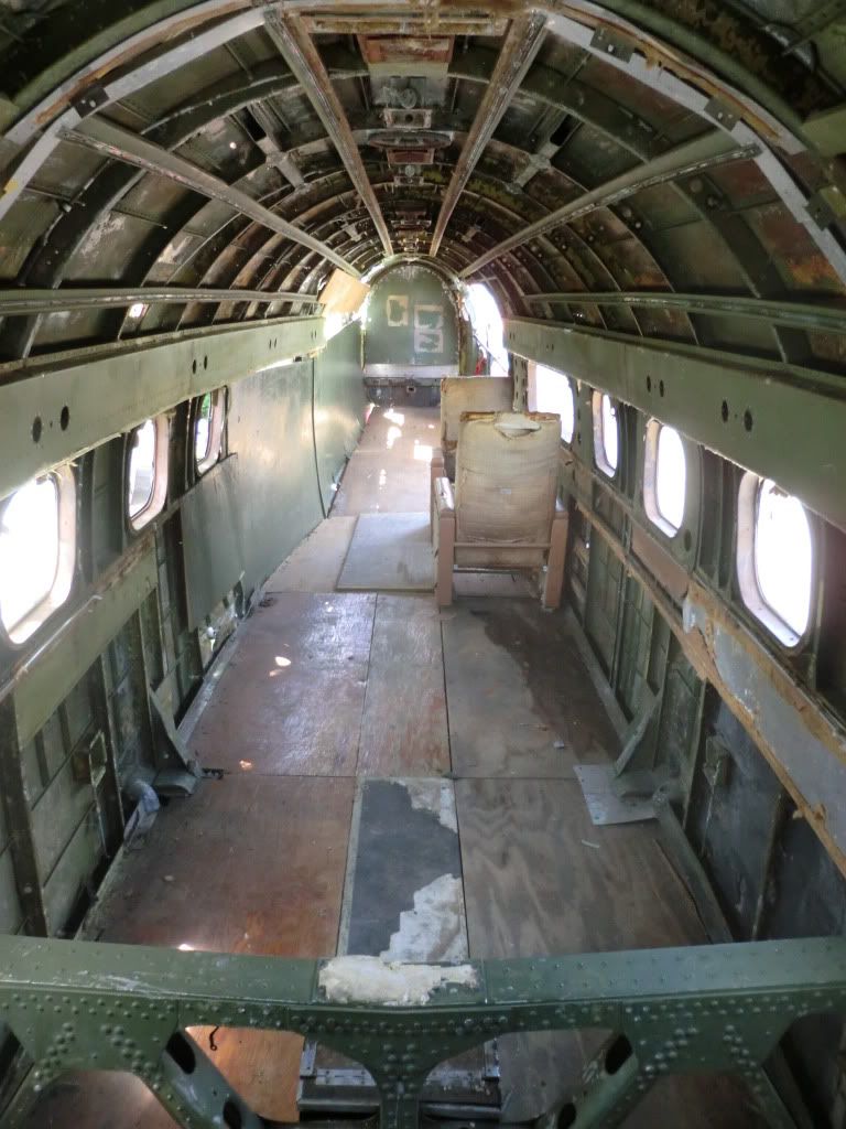

Tinbender those are some great ideas! I have an astrodome from a c-60 laying around here somewhere that I could reinstall, with hinges of course. I'm a bit concerned about the possibility of some twist that might have occurred due to loss of structure. If it is twisted, I don't think that will be to hard to fix with some jacks, timbers and some temporary tubing braces on the inside until the damage is stabilized. I'm not going to have much time in the next few works to work on it due to the start of my busy season with normal work. The floor is severely damaged where the Chevy truck was driven through the side of the plane. I'm currently trying to find a junk Lodestar out there that might yield a better tail section, but the problem with that is, it would probably be a lot more wise to just start with another fuselage all together. If I can't find someone willing to sell me another tail section, then I'll press on with the repairs on this one.
As far as what the fuselage weighs. I'm guessing it to be around 2500lbs or less now. I have removed a massive amount of debris and weight off of it already. With the exception of where the floor structure is broken near the entry door, the floor structure appears solid and substantial. My plan at this point is to unscrew the floor boards and cut out the roof of the cargo hold. I can visualize two long steel frame rails running under the floor structure that will attach to the original floor with rubber washers etc to prevent electrolisis. I think that would be stronger than 90% of the motor homes on the road. Once the floor boards go back on, there should be no sign internally of the modification. Even the engine should be under the floor. Other than this thing being lengthy, it is much more narrow than a motor home and it should be far less top heavy too(only about 5ft wide). The axles would still be as wide as those on a motor home. I strongly think that it will weigh around the same as the average one ton dually crew cab truck when completed. I'm really going for a big panel truck rather than a heavily loaded motor home.
Even though this plane is really nothing very special at all, I can say that I get a real charge out of sitting in the cockpit and tinkering with it. There is something about making an object that all others have written off as dead come back to life again. It is a weird feeling working on this Lodestar in an abandoned, vine covered, pre-war hanger that hasn't seen an airplane in many years. I'm also doing this on an artist's budget. So this mission is pretty well hopeless but onward I go.

For the heavily damaged right side, perhaps just cut off the most heavily damaged rear fuselage, even 8-10 feet of it, and fab a simple tail turret or tail cone. For a panel truck, you could make a swing away tail cone that exposes a fully open rear bulkhead, easy for loading your tools/equipment if you travel to different jobsites.

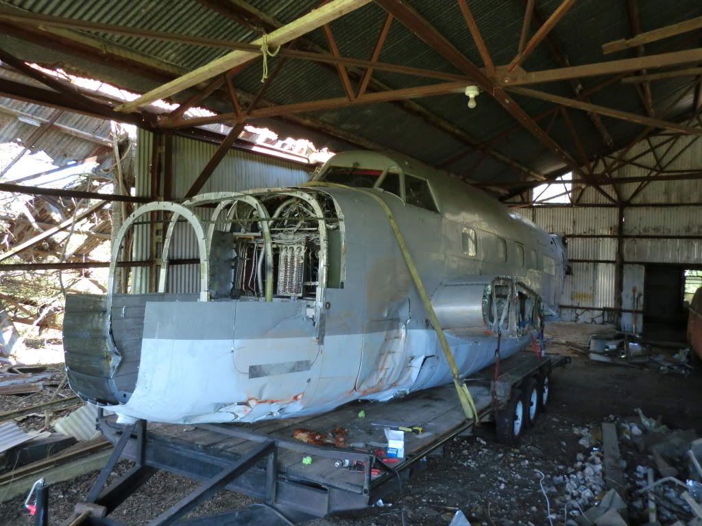

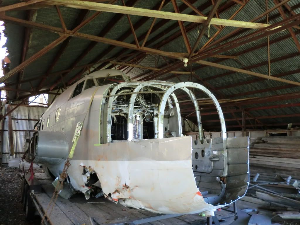

Here was all that I was able to accomplish this weekend. Drilling out hundreds of rivets is almost relaxing. I was able to remove the top nose skin in one piece. I will be able to patch up some of the dents and holes on the bottom of the nose with this skin. I need to slide all of the ribs forward a bit and then I will be on my way to making the nose looking more like a B25. I know this is the last place in the world to start on a project of the scale, but I wanted to do something enjoyable to start. Even though I really should be concentrating on the severely damaged tail area, I'm putting that off in hopes of turning up a tail section somewhere before I start trying to repair this mangled mess. I'm dreaming of course.
JasonImageImageImage

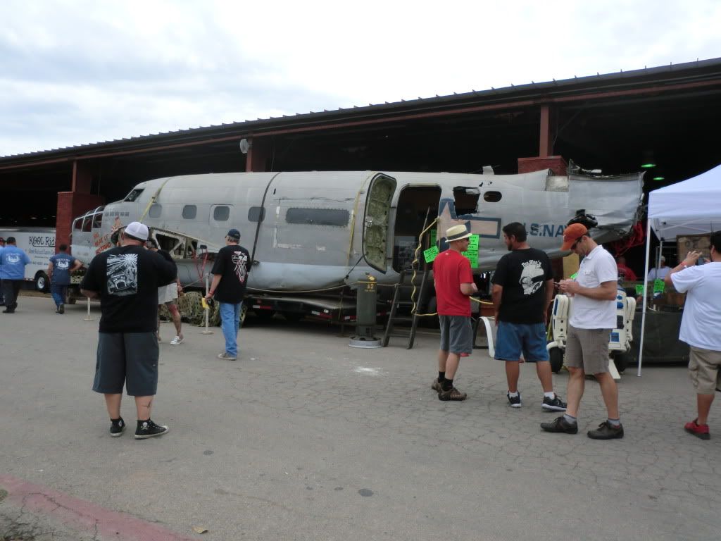

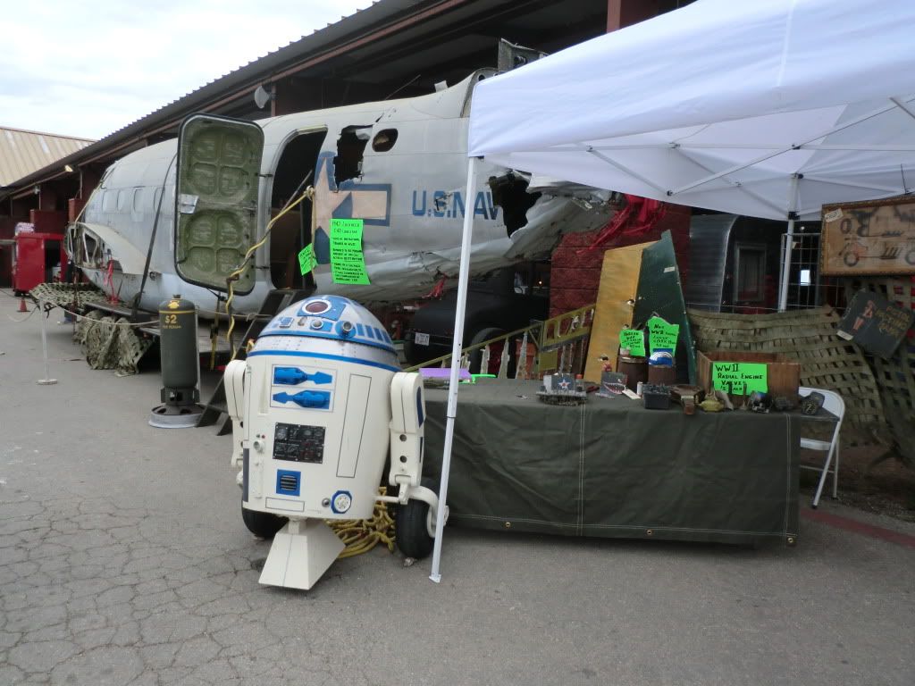

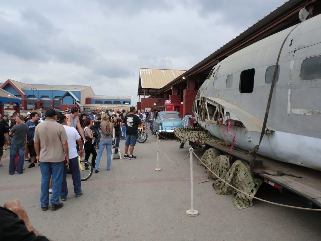

I took the Lodestar out to the Lone Star Round Up in Austin, TX, last weekend. People had a blast running around in the plane. I replaced some of the plywood flooring that had been damaged while the plane was in the junk yard. I also wooded over the huge holes in the right side. I made the nose look a little more B-25 like and I added some nose art. I started all of this three days before the show. It was a fairly long drive with a strong cross wind to and from. But it was a lot of fun.ImageImageImageImageImageImageImageImageImageImageImage

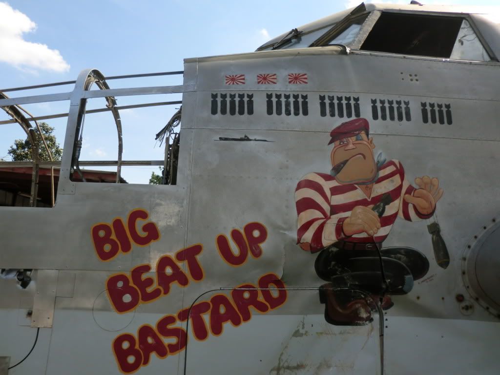

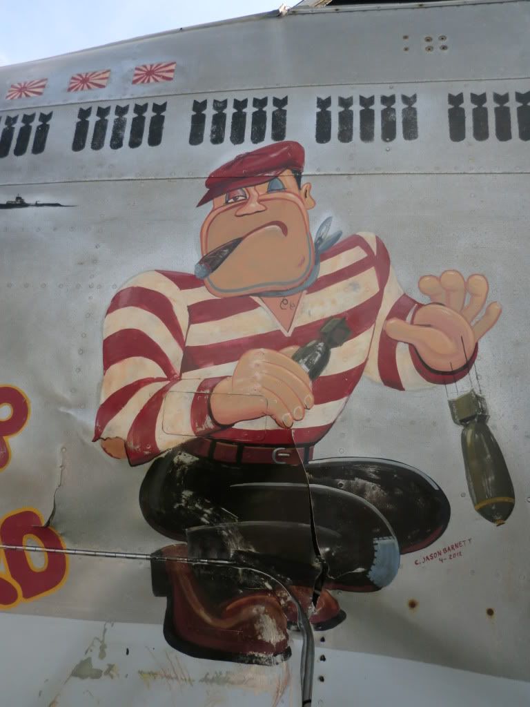

I just wanted to share my little piece of the "Big Beat Up Bastard."
When Jason first rescued the Loadstar from the junkyard I asked if he'd be willing to share a scrap or two. He did one better and put together this custom piece of nose art for me! It is actually a piece of skin from the wing.
My wife and I have a cat named Schmew, last time I visited the NMUSAF I found a picture of this nose art on a Korean War era B-29.
This nose art was based on Al Capp's Shmoo character.
So I asked Jason to combine the Big Shmoo nose art with a picture of our cat Schmew...
And this was the result!
Needless to say my wife and I are both thrilled with it.
Thanks Jason!
