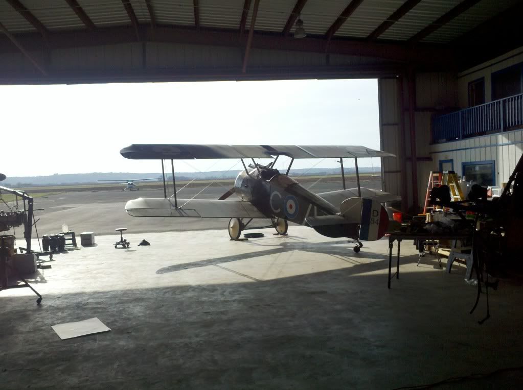

Can't wait to see the Camel flying! I've seen it in person and it is truly a labor of love. Saw it peeking out from the hangar doors on a flight last week and it was VERY tempting to tell my student to stop and taxi over.
Ryan
PostPosted: Sat Jun 11, 2011 7:57 am
Posts: 4528
I saw it peeking out of the hangar again yesterday...
It looks so neat!

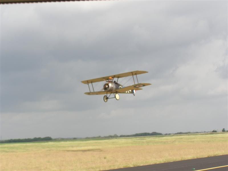

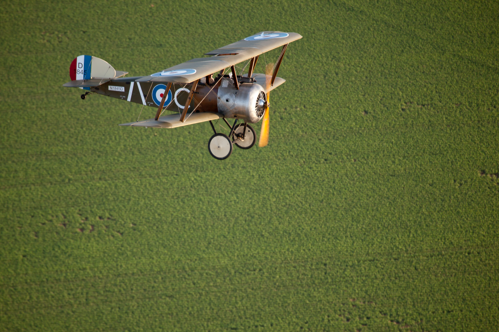

Well, I suppose this thread is coming to an end. She's up and flying, cruising from 85 - 95 mph. Easy to take off, easy to land. I just have to get use to this low wing loading... :)
We'll end on a couple of nice photos:
Coming home to Castroville:
Thanks all - it's been fun sharing the little plane with everyone.

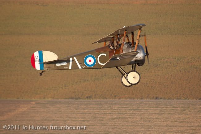

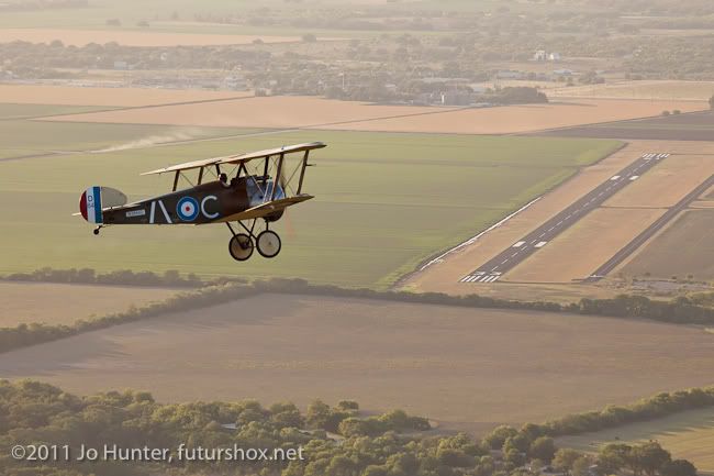

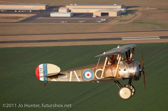

A pretty morning to go fly a dawn patrol today.....
