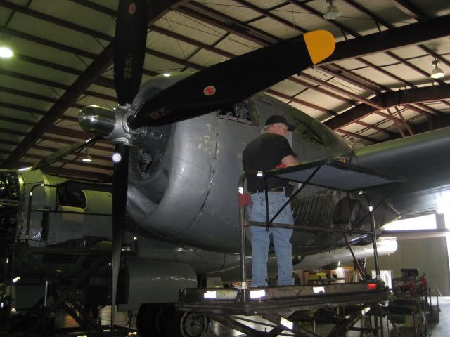

I notice the prop on #2 no longer has cuffs on the blades. Are they not necessary with the new engines?
We hope not.

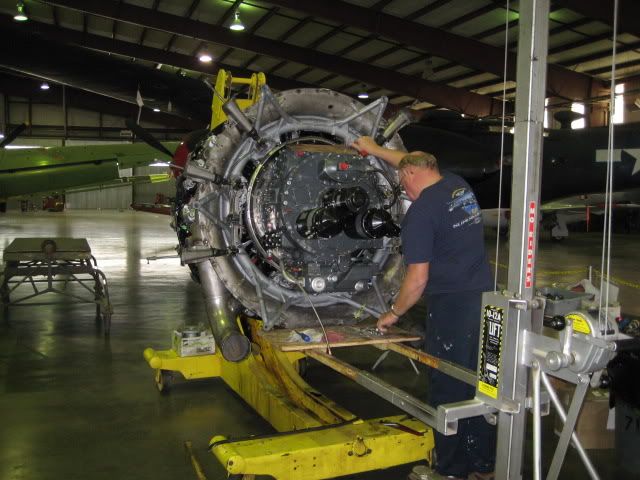

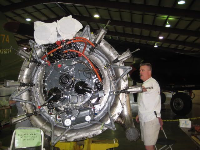

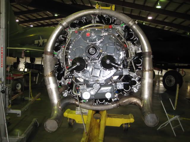

B29B24crewchief wrote:
Here's a few pics of some recent stuff we are doing.
Here is the exhaust installed! We decided to put it on first this time, before we installed the mount ring. It was alot easier!!
Then the mount ring gets installed. Mark uses the lift to put it in place.
I've got Duane here working on closing up the cowling panels on #1 engine.
This is Shad working on putting the rest of the sparkplugs in.
This is Sam assisting with the sparkplugs.
Dave
Thanks for the photos update.
