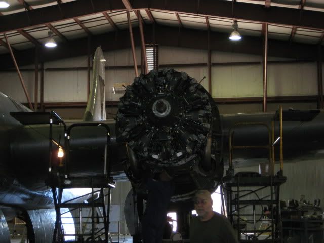

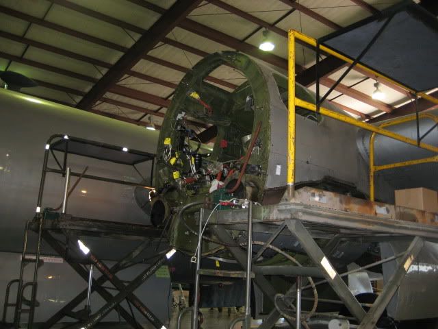

Since Chris mentioned the "Annual" inspection, here is Dave up on our big B-2 stand checking
out the rudder mounts.

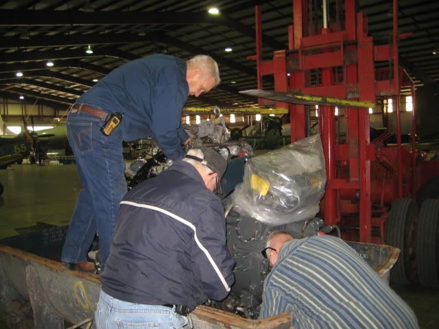

The engine arrived Monday!

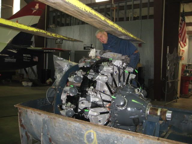

This is Wayne, from Alberta, Canada. He's one of our Squadron members down for a week of fun in the Midland hangar!
He's working on putting the lifting assy. on so we can get it out of the can.
Jim and Tom are helping unbolt the mounts that hold it firm in the can.

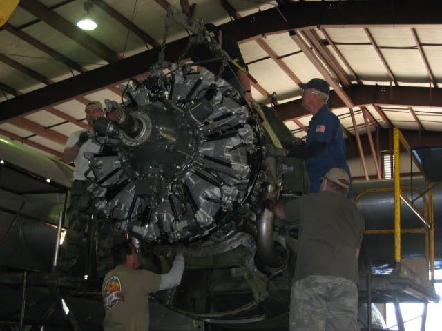

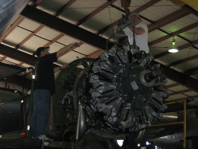

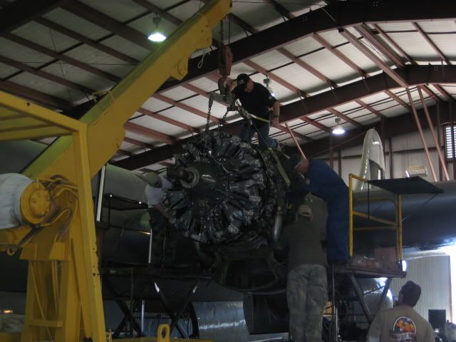

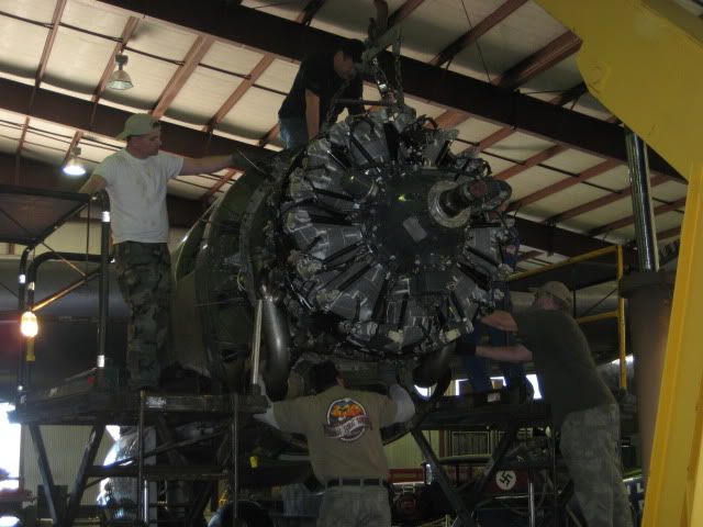

This has been an amazing week! We got so much done in the last 5 days. Chief Flynn got here Monday and went right to work, getting the #2 engine ready for hanging. Then Max got in on Tuesday morning from SLC Utah and was busy doing the same. Then there was Brad, Poor guy! He came down last Thursday on a 2 day pass and stayed till yesterday, to see and help hang the #2 engine and get the last of the old B-29 engines off!!! His home in Altus was still without power but I don't think that bothered him a bit. In fact, I think 9 days with "FIFI" is really what he needed. Sorry Christine, you get what's left of him!!

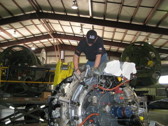

Here's Brad and Chief Flynn getting the sling put on.
The sling is on and now it's time to pull the engine out of the Whiting stand
This is not always easy!!

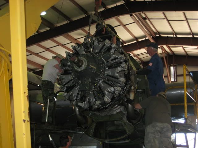

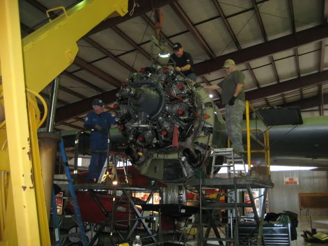

It's Hangin" Time!

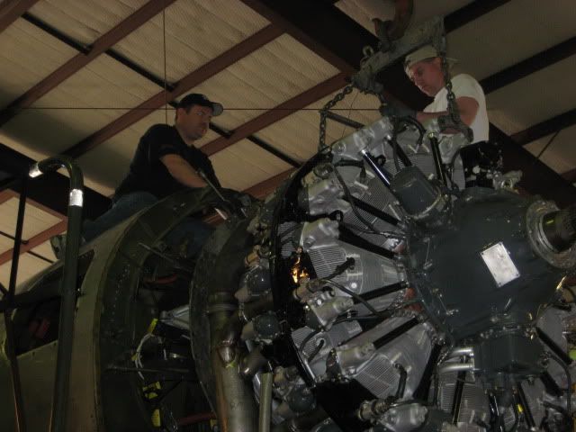

Max and Brad working the Comealong, to line up the mount ring to the mount bolts.
Easy does it. Nice and slow.
Everything going well and lining up.
Thats it! All 6 bolts in and nuts on!
Great job Guys!!!

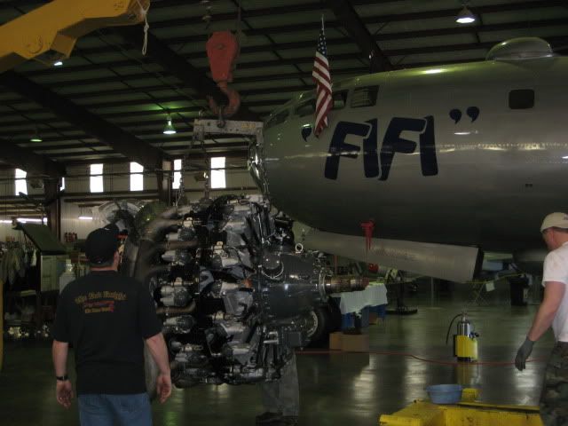

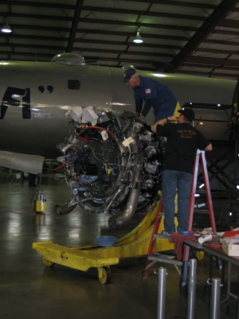

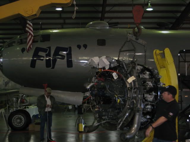

New engine #2 just about ready to go on the wing.
Just waiting for the new adapter for the hoist!
Check the difference between the nacelles for the new and old engines.

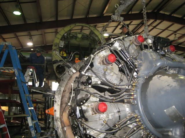

Dave guides #2 into place.
And she's on!
