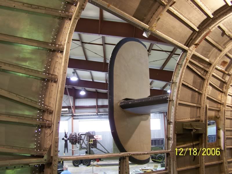

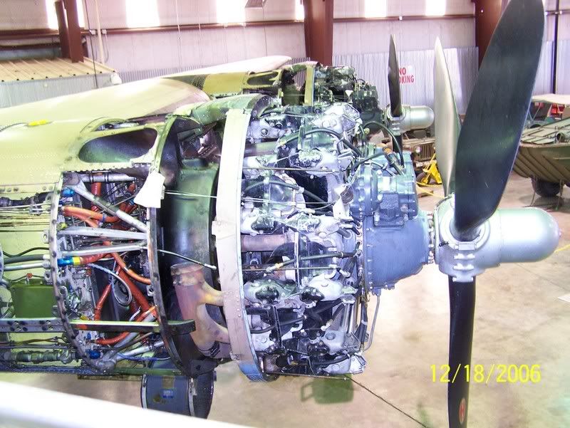

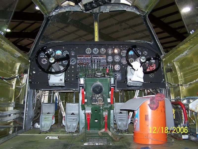

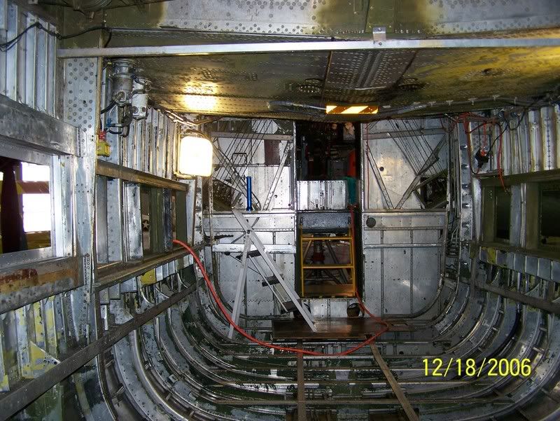

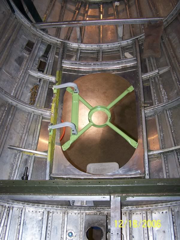

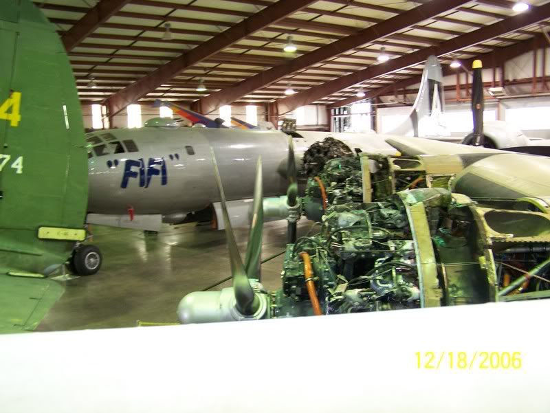

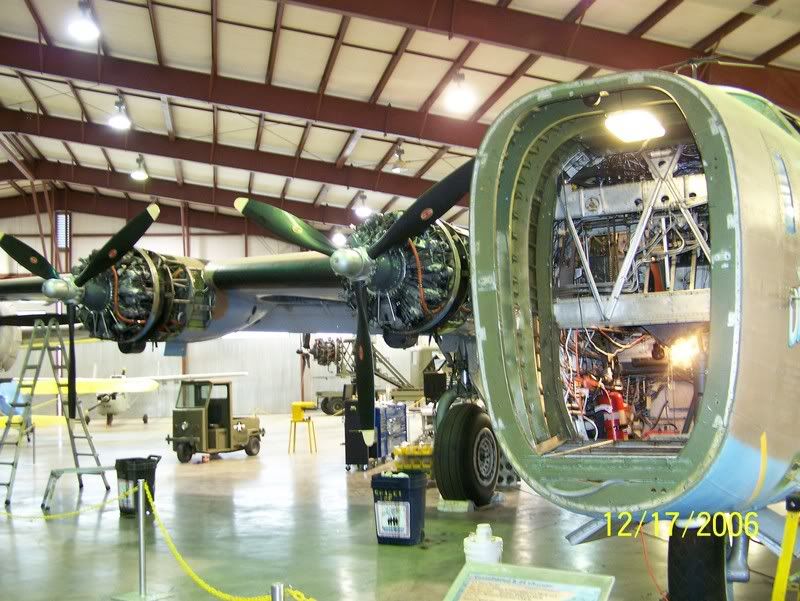

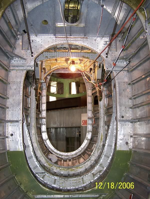

I want to mention that the two B-29 Sqd members were extremely thankful and gracious, that volunteers outside of the squadron were there to help. The first was Shorty DeWitt. If I understood the conversation correctly, Shorty was a flight engineer on B-29's during the Korean war. The "big" guy was Paul Stojkov, a Continental Airlines pilot, well, you know what he also gets to fly. When Gary said the fuselage was stripped, baby, there is nothing there. So here a few overall pics..... Alan

Your killing me with the glimpses og the B-29 in the background...somebody needs to walk over there and get some pictures!!!

Wow! Bucket seats!!!! :lol: :lol: :lol: :lol:
 Post subject: Re: Update
PostPosted: Wed Dec 20, 2006 11:12 pm
Joined: Tue Dec 12, 2006 2:30 pm
Posts: 691
Location: Ohio
bluethunder28 wrote:
"Anyway, the throat feels a bit rough...the legs have gone...but I'm still able to chant, so let's get going."
Joe Strummer, 1999
PostPosted: Thu Dec 21, 2006 12:04 am
Posts: 4433
I was thinking of more like out of a redneck christmas gift catolog,
bucket seats with rope belts....
PostPosted: Thu Dec 21, 2006 12:26 am
I almost blew snot on my monitor with that picture...ROFLMAO!
Thanks
PostPosted: Thu Dec 21, 2006 1:15 am
HAHAHAHAHAHAHAHAHAHA.....oops, I wet 'em.
PostPosted: Thu Dec 21, 2006 8:50 am
Posts: 3282
Location: Nelson City, Texas
Not only fashioable Homer orange bucket seats, but notice they are double padded.
PostPosted: Thu Dec 21, 2006 9:21 am
Posts: 1525
Location: Williamsburg, VA
We have a late entry for "Reply Of The Year"...
Absoeffinglutely hilarious. Laughing to the point of tears over here...
PostPosted: Thu Dec 21, 2006 9:28 am
Posts: 4468
I gotta agree. That picture is certainly worth a thousand words...or laughs! :lol:
