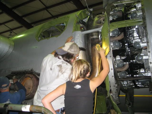

This is Jay and his daughter working on putting the inner cowl flap panels back on that had to be removed to take the cowling back off

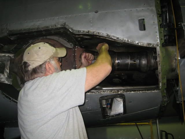

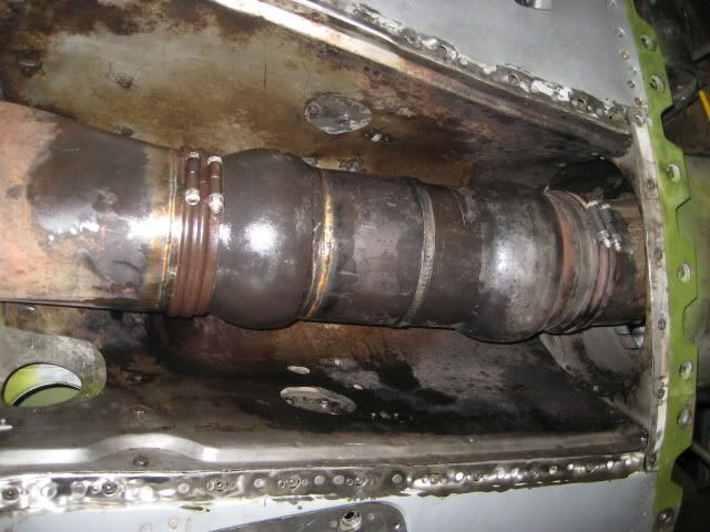

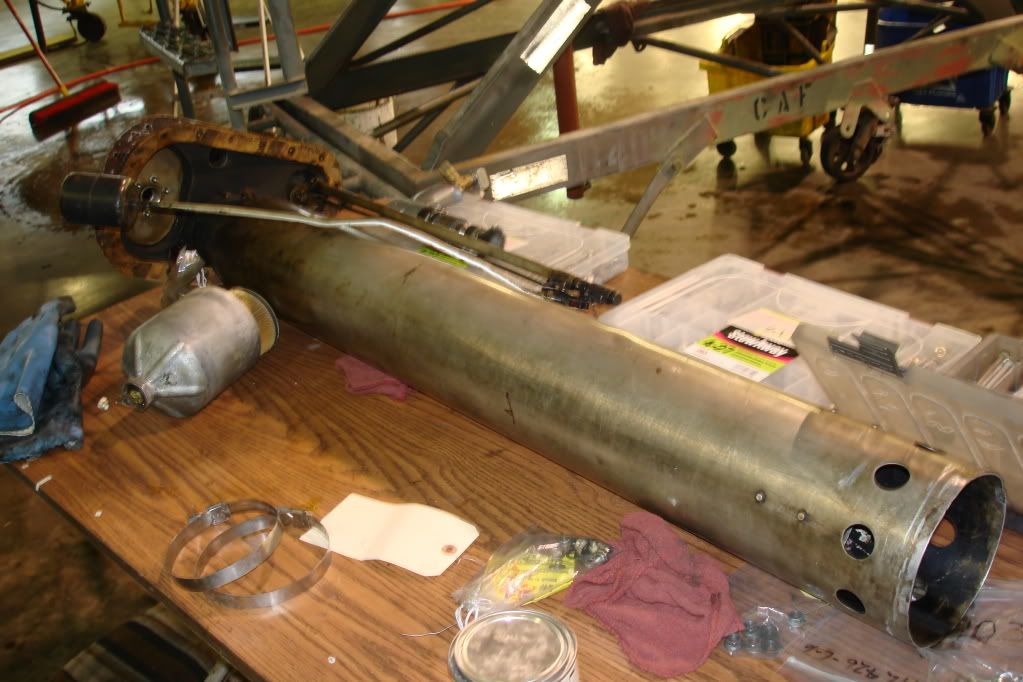

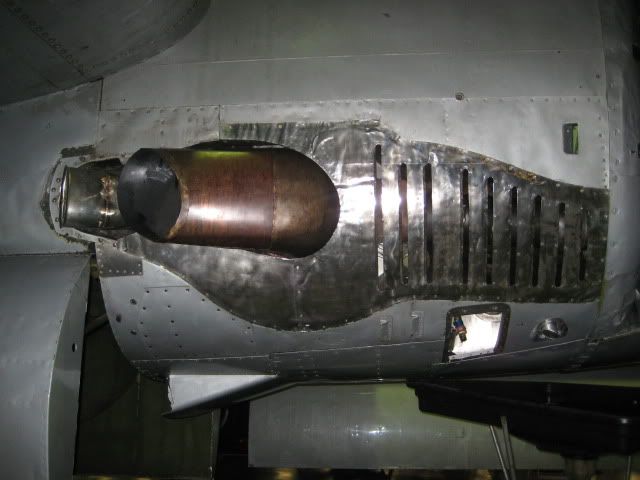

Guy came over, a local machinist who owns a machine shop in Odessa. Here he is putting on the clamps for the "bell sockets" portion of the exhaust, which also had to be modified a second time.

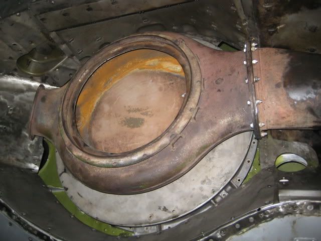

These housings were also modified. They had the guts removed many years ago so all they do is allow the exhaust to flow thru them and out the exhaust pipe and hood.

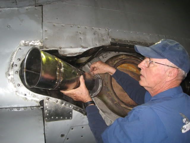

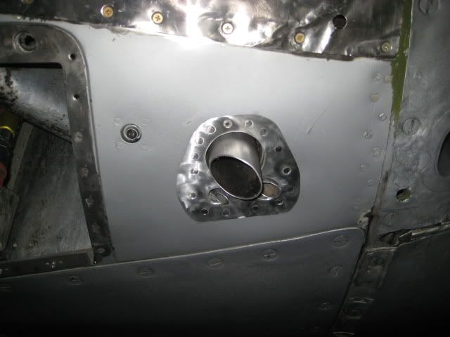

John got to work on putting the exhaust pipes on that Nelson made for us and
then the hood goes on.
This is what it looks like when it's done and has the shroud panels on.

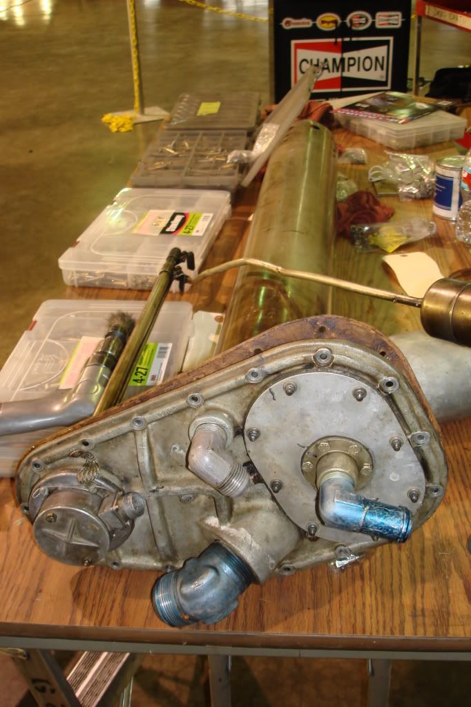

This little creation is what I call the breather and drain array. Next time I make ones for the other 3 engines I'll show you how this came about and what it takes to make them.

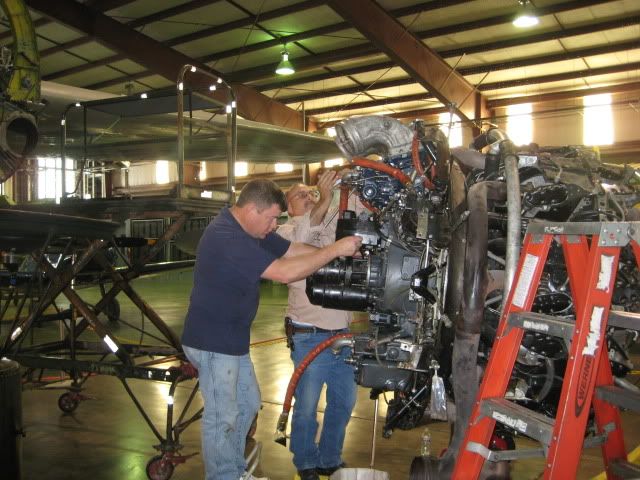

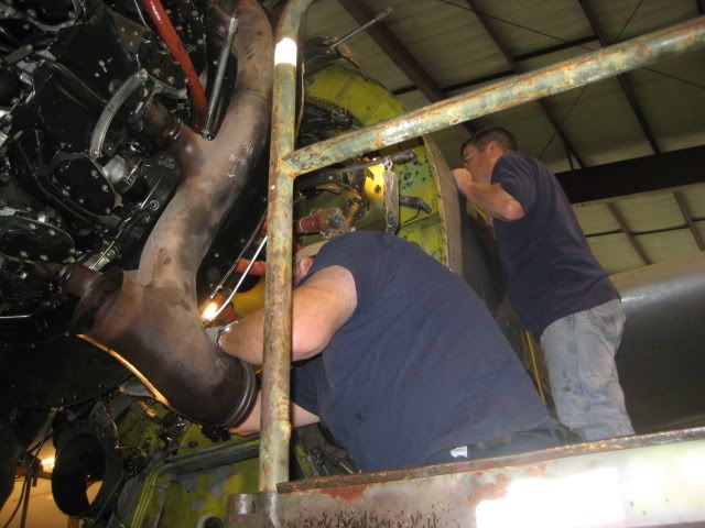

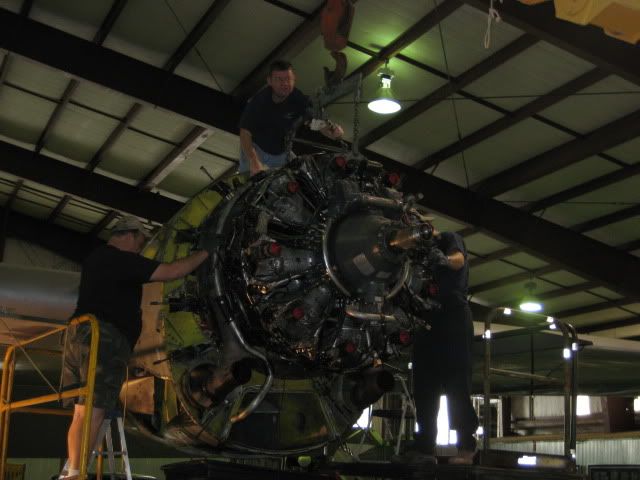

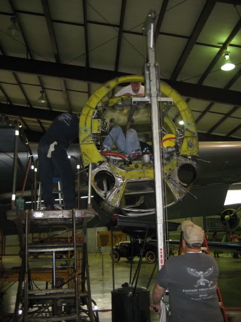

The next series of pics were taken on Thanksgiving Friday and Saturday when I had Chris, Mark, Rich, Brad, his Dad and Brads wife, Christine! This trio was helping me remove #1 engine.

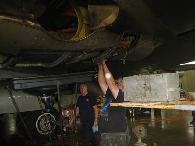

While Brad and his Dad were busily taking accessories off the removed engine, Chris and Mark were back helping me with the prep work on #2 engine and Richard was working on removing the oil cooler.

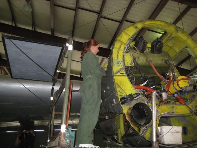

Then Christine, Brads wife got to get to have some fun helping Hubby take out the inner cooler plenum.
Here, shes removing the prop control box from the plenum which has to be relocated and installed in a different spot.
Brad wanted to see and feel what I did on the last two of these Mark and I removed.
As you can see, a ton got done in just 2 days. there's actully more that we worked on but I'm outta time.

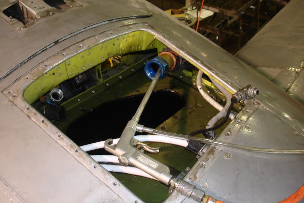

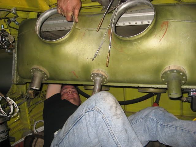

Well while we all await Dave's return on this thread, I thought I'd post some of my photos. I was fortunate enough to be able to go to Midland and give Dave a hand on Monday, December 28th.

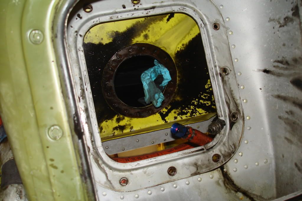

My main mission that day was to clean out the 85 gallon oil tank on the #1 engine nacelle. It was messy but it all went well despite me spilling solvent on my feet….

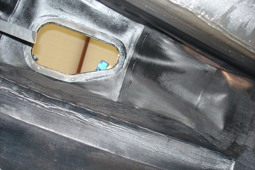

Here's the front of the #1 nacelle:

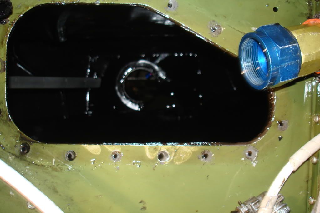

Here are a few shots of the top of the tank. I sprayed it out, then mopped the sludge out of the bottom of the tank. Finally I washed it out with a 1/3 bucket rinse of solvent.

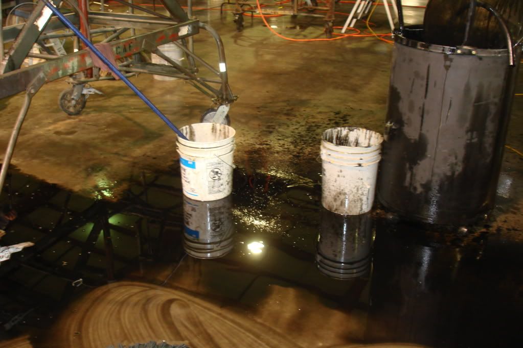

Who said working on warbirds was all fun? Here's the mess I had to mop up when the drain catch under the plan clogged up and all the oil and solvent went over the side :(
Anyway, once I cleaned up my mess, the last step was to take some rags and wipe out the bottom of the tank. Here’s a shot of the bottom of the nacelle with the last shot showing the clean tank. Notice you can see all the way to the roof of the hanger in the second shot.

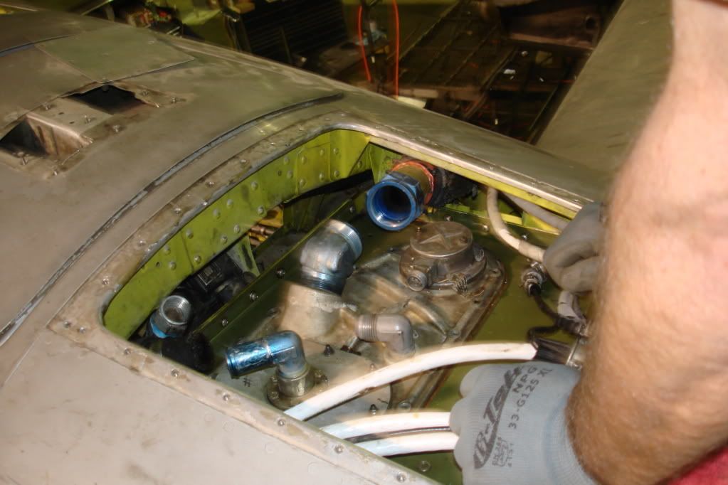

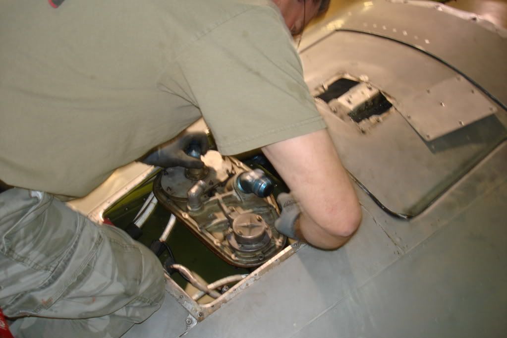

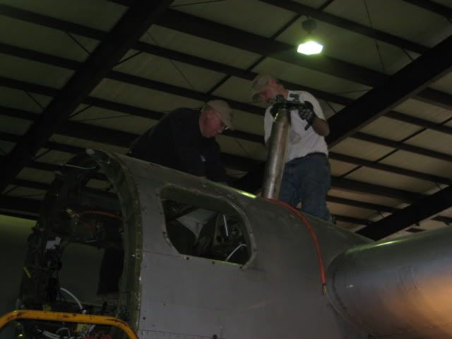

The last part of the day involved reinstalling the oil tank stand up pipe (?? - Dave you’ll have to correct the terminology on that one). So it was back on to the top of the wing.
Seated and ready to be reconnected.

viking73,
It's called a hopper or temperature accelerating well. Oil from the main supply enters at the bottom through the holes. The oil returns at the top, thus, only a portion of the total oil supply is circulated. The hopper hastens the warming of the oil when the engine is started.
It's nice to know what the inside of the tank looks like, I've never seen it before.

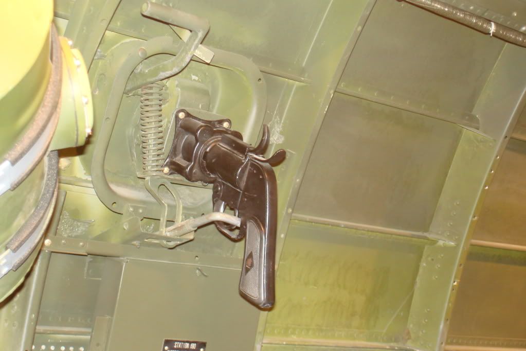

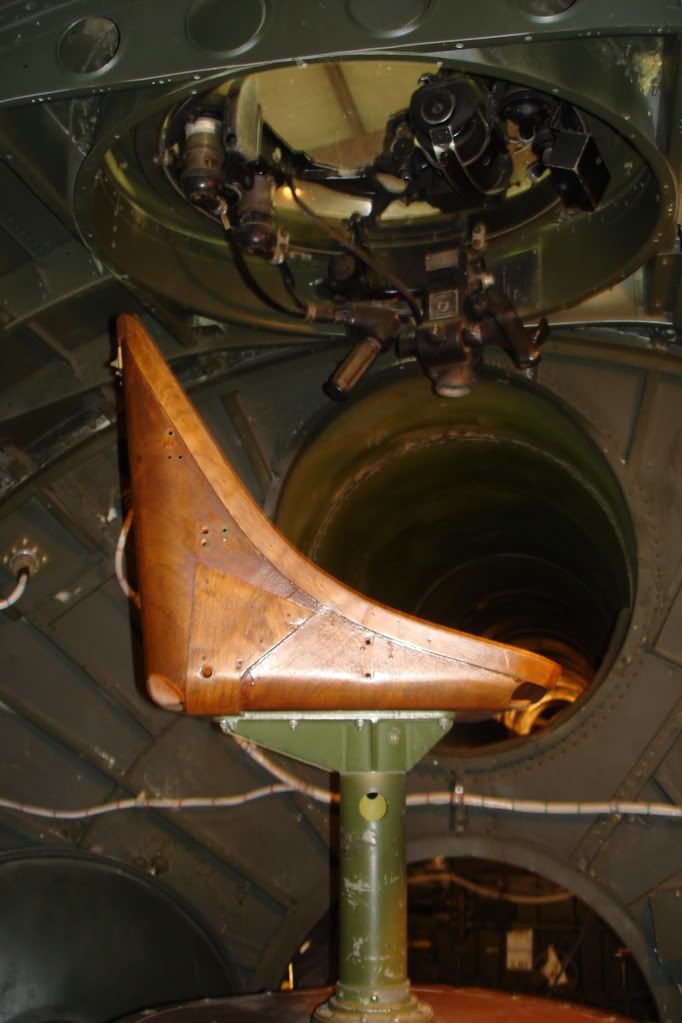

Here's a few shots of the rear compartment.
APU:
Looking towards the rear:
Looking forward:
And a shot of the flare pistol in the cockpit wall I though was pretty cool!
