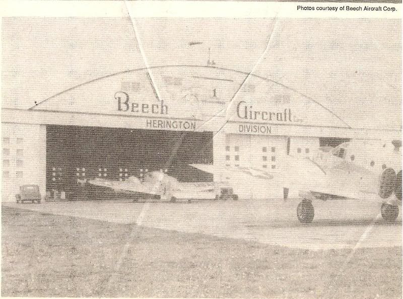

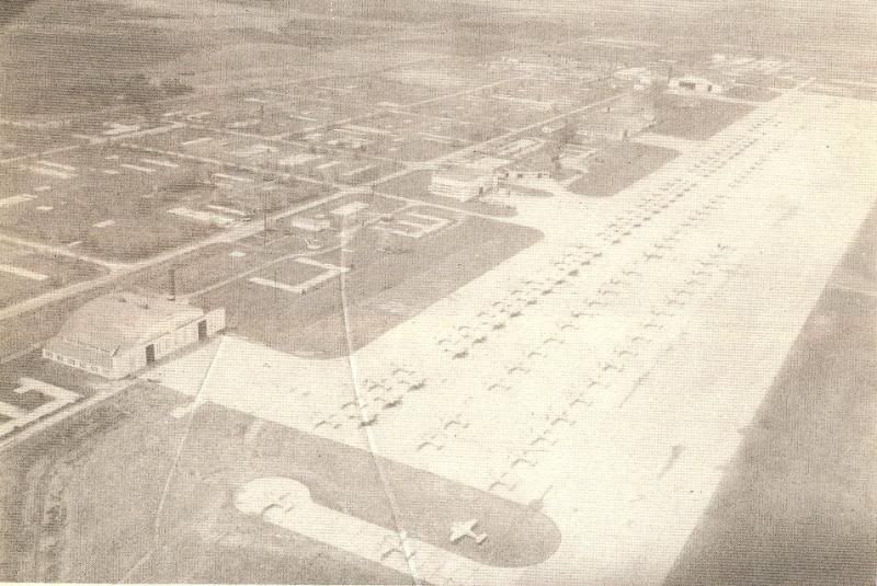

Here's a quick and dirty on what Beech did at Herington from the little research material I've found. The selected airplanes were flown or otherwise shipped to Herington for teardown. The wings, nacelles, engines, and empennage were removed and cleaned near the smaller hangar at the far end of the first photo. These components were shipped by rail to the Beechcraft plant. I have heard that the remaining fuselages were scrapped on site, but a few locals I've talked to said the fuselages left the field and were supposedly disposed of elsewhere. Perhaps Taigh has the full story on what went on at Beech/Herington.
Overhead shot of the field:
The two center hangars are no longer standing. The square hangar burned in the early eighties while Beech was storing excess aircraft inventory at Herington, and the other hangar was destroyed by a small tornado in the early seventies. The south hangar and sub-depot are still in fine shape and being used by non-aviation businesses.
And a nice photo of the south hangar:
This hangar and the one that was blown down had/have a vertical fin door in the back wall to allow two B-29s to be accomodated at one time, nose to nose with both aft fuselages sticking outside.
